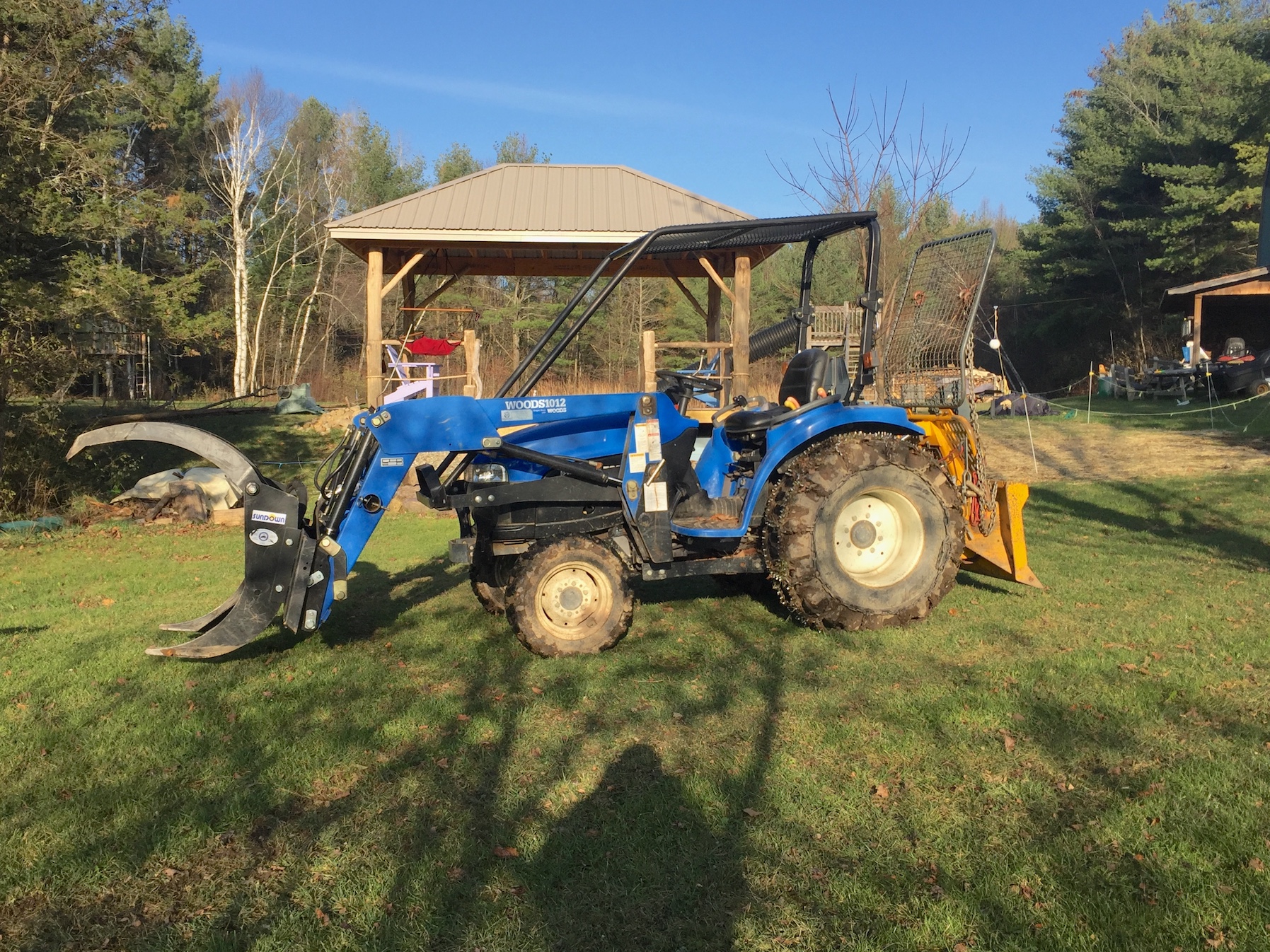

Well here's today's update.
Me and a buddy took the setup to the woodlot today for some testing
I feel the testing went well. One thing I cannot figure out is why I cannot get free wheel with the ramp set up. I have tried everything. I have started making a set of ramps on a piece of 3.5" solid bar that I had. The poor little HF bandsaw cut it like a big girl. Each slice is 5/8" thick. The hardest part so far has been to drill the 1" hole, I got them done but the chuck wobbles so bad on my Rigid drill press that I don't think they are perfectly round!
With the last set up with the ramps made from the Lovejoy connectors I had good free wheel of the drum. Today was a PIA having to pull the cable while not only the drum in turning but so is the clutch, chain and PTO shaft ugh!
I think the winch did OK other than that.

Update for today.
I tore the whole thing apart, found (which I had a suspicion) the shaft was not perfectly square to the front if that makes sense, the rear support (one facing tractor) had to be moved up and over a tad. I hogged the holes out with the plasma cutter and then once I got it all where I wanted it I drilled some locating holes in the pieces so now I can insert a couple of punches and it will be aligned.
Second issue I found was a bad bearing on the sprocket, there are two, the outer most one was sticky so I ordered two new ones from McMaster Carr. I think the reason for the bad bearing is two fold, one it was being pushed on by the little thrust bearings I was using but only pushing on the very center, I don't think these bearings like side loading. And two the DOM tubing it is going into is not perfectly round or proper size. I'll figure out how to deal with that when the time comes
Third issue I found was some galling on the thrust washer at the ramp piece and drum, I greased them but I guess not enough or because the ramp only exerts pressure in one spot it's not spread around. I hope to solve this by installing some high load bronze oil impregnated washers from McMaster. They come in two sizes for 1" shaft, I ordered the larger size, 2 7/8".
My thought here is it will transfer the pressure to the DOM and not the bearing and hopefully the new ramp I'm making will more equally distribute the pressure.
It is a learning experience for sure.
Stay tuned for more updates when I get the parts.

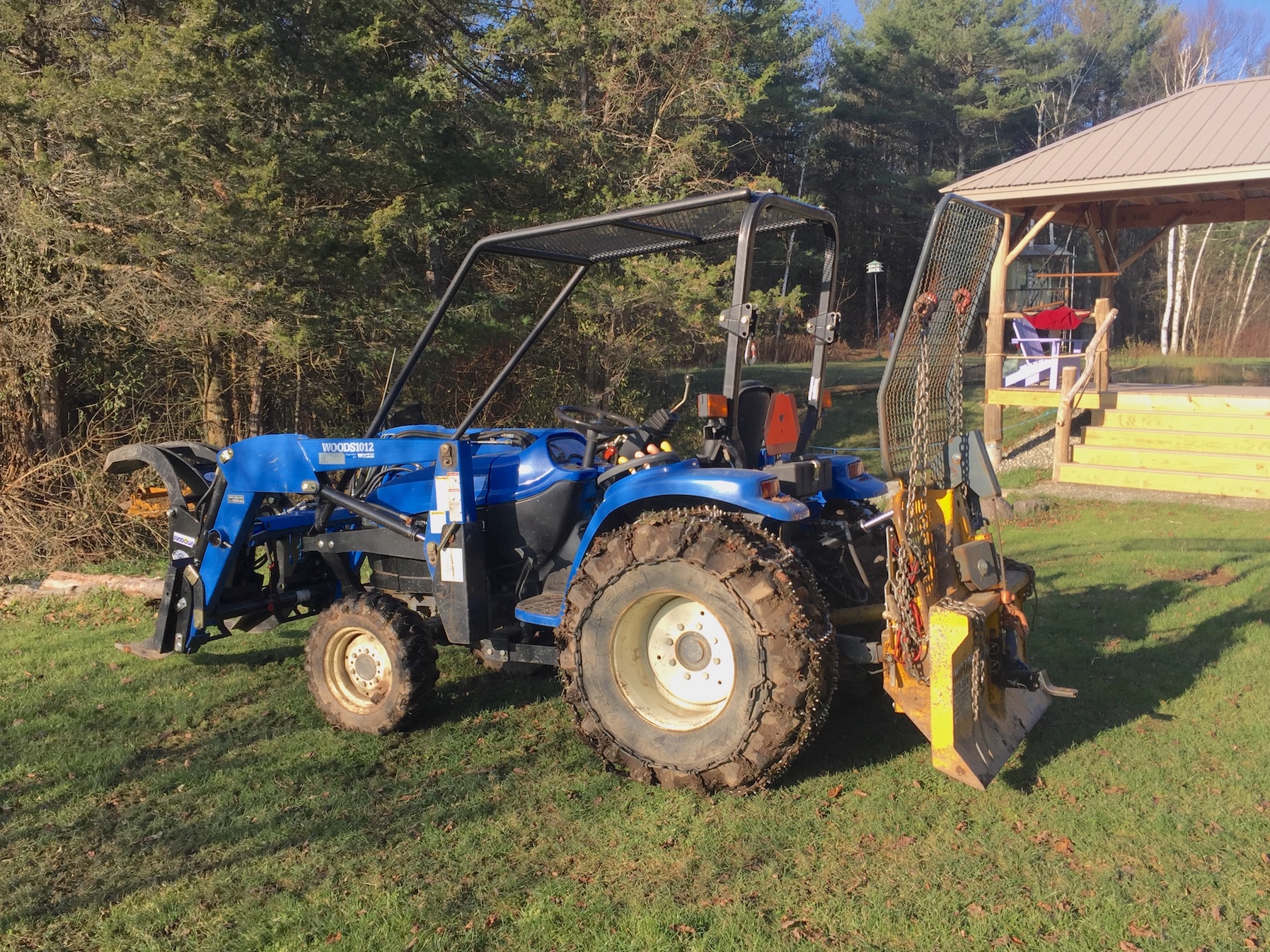

/ DIY logging winch build #172
IMG-0329.JPG IMG-0333.JPG IMG-0348.JPG IMG-0350.JPGIMG-0353.jpg IMG-0369.JPG
These are the pictures I took putting the winch back together, maybe they might turn a light bulb on for you, to bad you are so far away you could of skip over and help put it back together last week, as it is I had to do it twice because I put the winch together without first running the cable threw the cable guide, I didn't notice it til I had the cable all stretched out and ready to spool in, a good way to learn to speak in tongues, I could've cut the brand new cable but just didn't want to do that.
First thing I replaced 2 berings one on each side of spool, the original ones wasn't turning smooth, 2nd I dug out old short cable piece, run new cable threw winch over to my bench (without going threw cable guide) put the small cable holding block on, 3rd wipe LITTLE grease on shaft and bring spool over the the winch and put it back together, hoping I didn't get any grease on the clutch disc or spool pressure plate, I'll find that out tomorrow.
Near as I can tell is that the lever arm with the 3 pins pushes the pins against the opposing block, they both have rounded ramped slots in them and the lever doesn't move much to push against the spool bearing or spool, not sure which but it creates a lot of pull. So if everything works right this weekend I should be able to plow snow or mud with the trees...............Winching trees in March - YouTube
