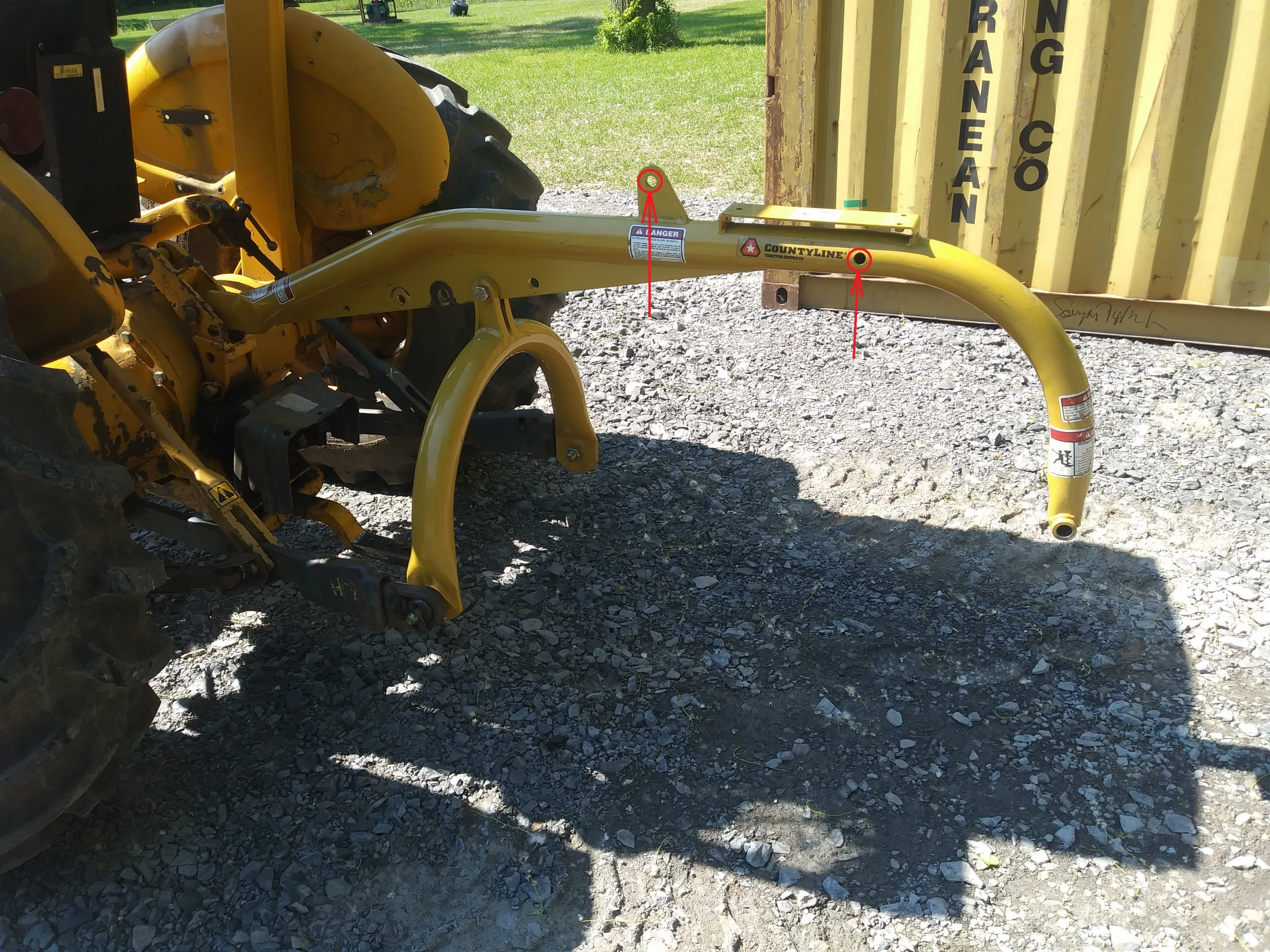

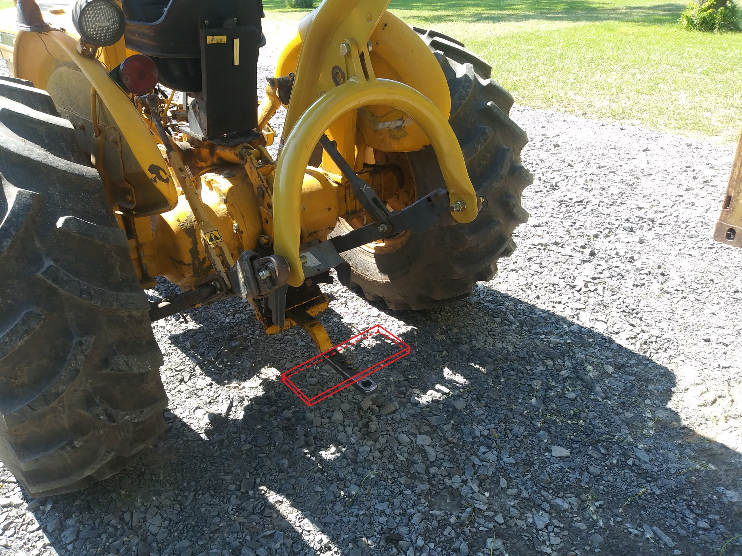

Looking to log some Scots Pine to use as sawn non-structural lumber for my house build. Need a quick and dirty log winch setup, can't afford a ~$8000 log skidding winch right now.
I'm looking to use the frame from my cheap County Line 3pt hole auger and mount a winch to the draw bar.
My question is, how cheap of a winch can I get away with? I'd like a winch with wireless remote so I can follow the log with a cant hook to maneuver it through obstacles.
I won't use the very end of the auger frame to lift the logs, most likely I'll mount a clevis to one of the available locations closer to the 3pt lift arms.
My tractor has iirc about 500 lbs of suitcase weights on the front, making the tractor weigh about 5500-6000 lbs. I plan to buy a ~9000-10000 lb winch.
I won't have a blade to push in the ground to stabilize the tractor when pulling the logs. The logs I will be dealing with will vary from ~16" to 22" at the butt end and 25ft long. Green, that size Scots pine should be around ~2500 lbs.
I intend to use the tractor battery to run the winch, so the tractor will be running with parking brakes applied when I'm skidding.
Has anyone done something similar? Thoughts? Would Synthetic rope be better/worse than wore rope? I'd like a winch with the guide rollers, those seem to only come on winches with wire rope.

Forestry winches have a "shoe" that digs in to resist the force of the winch pulling the tractor backwards. You'd need to make that. Otherwise you'll be depending on the parking brake and tire traction alone to keep the tractor from moving. Forestry winches also have longer cables than truck winches- 160-230' vs 60 or 70.

Like in the picture posted, I have used the arch portion of the post hole digger to skid timber.. Using the arch with the top link and not the arm portion of the PHD...
Using a hook on a heavy quick chain link pinned to the point where the top link attaches to the arch.. This to lift the log, then using the fixed draw bar to pull the load has worked well for me..

I did just that today as a test, it works pretty well. Just need to come up with a winch solution now.

I wonder if you could use the post digger arch as the toplink for a box blade to help keep the tractor from sliding back when winching and still allow you to pickup the log when you are dragging it with your tractor.

If you're worried about slipping backward, here's another solution I've used. Also cheap. Cheap logging winch
