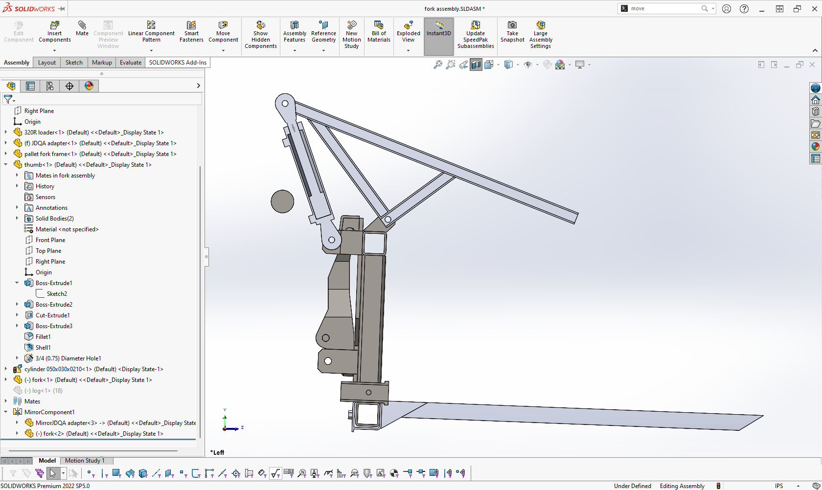

@Sawyer Rob had posted this in another thread:
It has a thousand uses, I use it all the time, it's been one of my "best buys".
SR

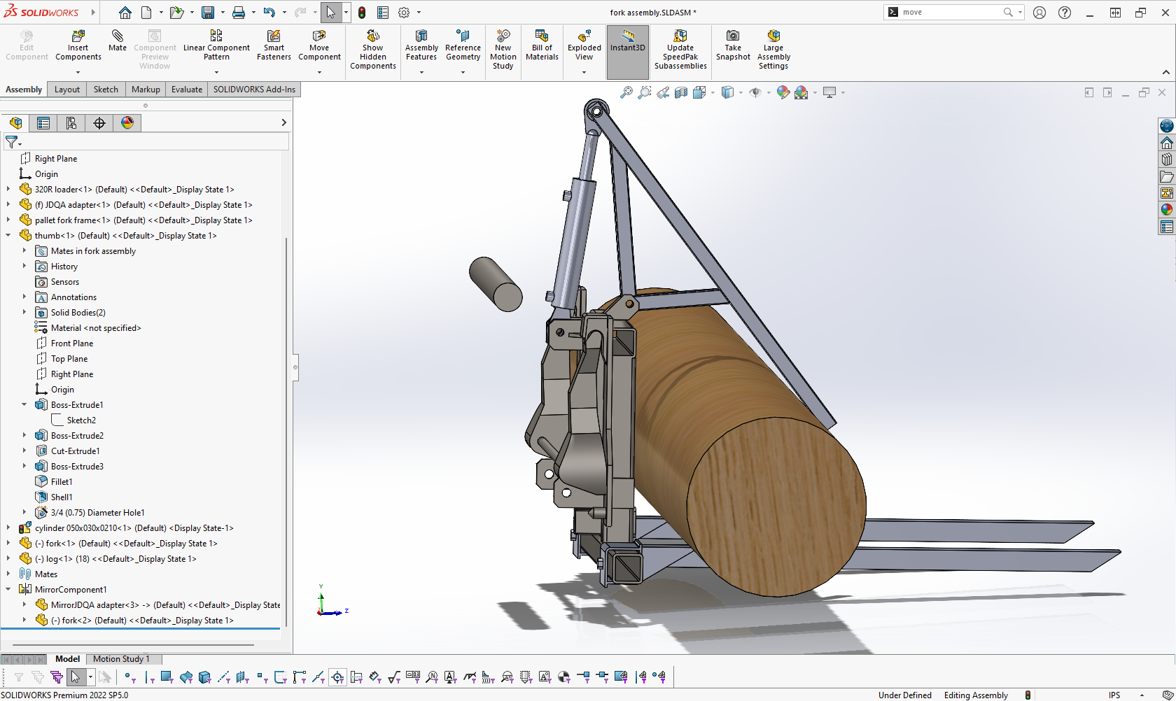

Serendipitous timing, I was both contemplating a grapple and setting up to modify my own 3-point forks for JDQA loader use. One of my primary loader uses is moving logs, all 15 foot lengths, and I do this using a pair of chain chokers arranged as a sling. It works great, but requires a lot of hopping off the seat, and it's not always the safest operation unhooking the chokers while piling logs.
Looking at @Sawyer Rob's rig, I started playing with the idea of using the top link pin on my 3-point fork frame for mounting of a cylinder to control a thumb. I won't need this top link pin when using the forks on the loader, so it's available. It appears all I need is an extra set of tangs welded to the top tube of the fork frame, to let the thumb pivot:
(click for full size)
The tube floating in air is the cross-member on the loader frame, need to make sure the cylinder can't collide with that. Shown here with an 18" log, but tested with 6" to 24".
No binding or collisions in full range of travel:
Only potential problem I see, other than needing some more work to pick metal sizing and thicknesses, is that the thumb may tend to lift small logs off the forks due to forming a "V" with the back of the frame at small diameters:
I thought I could tune this out with some fiddling of the section lengths on the thumb, but this is the best I've been able to do without either giving up max capacity or causing a potential collision / bending metal between the cylinder and loader cross member or cylinder to thumb spine.
If someone can give me a good guess on square tube size and gauge for that thumb, it might save me some FEA simulation work. The cylinder is only 50mm bore, so around 7850 lb. at my tractor's 2500 psi working pressure. Weight is a concern, as this fork frame already weighs a lot, and I'm often fighting for more loader capacity when moving logs.

Oh, one thing I forgot to ask. Think I need grease-zerk pins in sleeves at the thumb pivots? Got a good source or item recommendation?
I'm not sure how just a plain top link pin would do here, as there won't be a ton of pivoting. But then I think of my bucket curl pins, and the fact that they're greased, and how loose some old loaders still get over time.

Yes all rotating/pivoting joints must be grease-able or it’ll wear out in no time.
Your design grometry strikes me as a bit odd. Without setting up a basic dynamics model, my intuitive sense after 20 years as a mechanical engineer is that you are losing a lot of clamping power while simultaneously creating very high stress in the pivot points. Do you have a license for ADAMS?
In my mind the point of a grapple is not to pull material back against the fork uprights- it is to clamp down against the bottom tines, or forks. As in, it’s ok if you can’t fully clamp down tight on one small log and it flops around on your forks, because after all, the load is still contained.
Take a look at this option (probably better to just buy one of these than spend 40 hours doing your own design and fab work)

Thanks, @deezler! Yeah, I don't get to do a lot of mechanical design of implements or dynamic work, just a lot of static models for high power electronics, I'm actually an EE (not ME).
But the add-on thumb grapple is not a good option for lifting long logs, as far as I've seen. I like the forks for this much better, even without a thumb. My thinking was that the addition of the thumb can help hold the log back against the frame/base when I tip the forks forward to retrieve (or even place) one from the top of a pile. Maybe I need to give this more thought, though.
You did misunderstand the complexity involved, as I can whip this job out in closer to 4 hours, not 40! I already have all material in my metal racks, other than the hoses and possibly the greasible pin bushings. I do a decent amount of metal fab, so this simple triangle of square tube and one pair of tangs welded to top of existing frame isn’t a stretch.
No license for ADAMS. I do my modeling in SolidWorks, and simulation in Dassault CST. I believe SolidWorks also has a pretty rudimentary mechanics solver built into it, but since I’m running every day CST for my business, I just go to that for most things.
Did you check @Sawyer Rob's post that I had quoted? That's what I was aiming to roughly mimic, using the fork set I already own. Thinking a single rib on top of that square tube could solve any strength concern, along with reinforcing tabs either side of each tube junction. Possibly teeth on bottom side of tube could replace rib atop, if warranted.

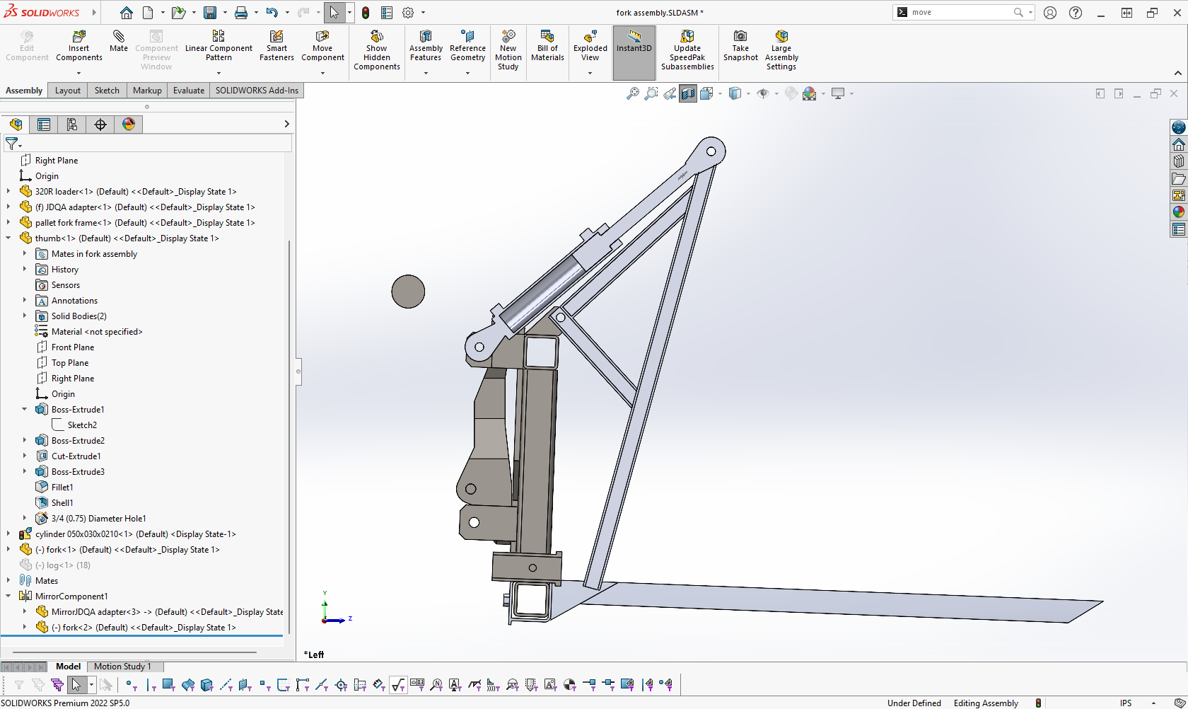

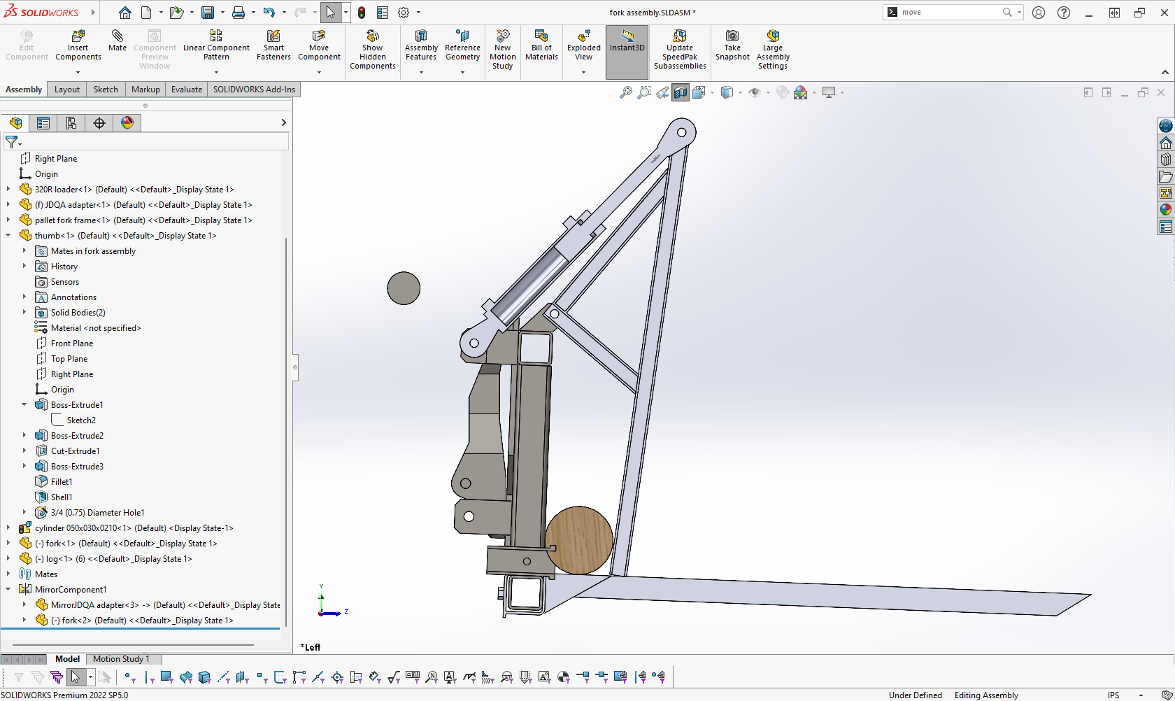

I really like SR's set up for moving logs. It will not work for me as I need to be able to pick up load that is 6 ft high once the logs are processed.
Would you show what the arm looks like when the cylinder is retracted? Thanks

I think you are on the path to a good attachment and one worth building. Having a thumb on the backhoe has changed my life... And one for the loader would be nearly as good.
Looking at all the pictures and imagining it in use, I'd rather have a curved thumb. Or better yet, some design with a method of clamping out at the front of the forks as well as back against the SSQA frame.
As it is, it would hold a log nicely and close in allows for the weight of a larger log. But a downside happens when you tilt the forks down and raise the grapple to release the log. Then to dump it, the log has to roll all the way down the forks and jumps off the end unconstrained.
It can really build up some momentum rolling like that.
I'd prefer some way to pick it up out at the end... or at least slow it down when unloading.
Yep, just like this:
I would want the grapple curved like mine is, it makes a difference in how you can pick things up.
Yeah, the inverted "V" created by the forward lower leg and top beam of that triangle was supposed to mimic your curved arm, but without having to actually cut a curve or bend a tube, as that would really increase project complexity with my tools (no plasma cutter). Maybe I could add a short third tube section mitered onto the end of the long arm at 45°, to create that end hook?

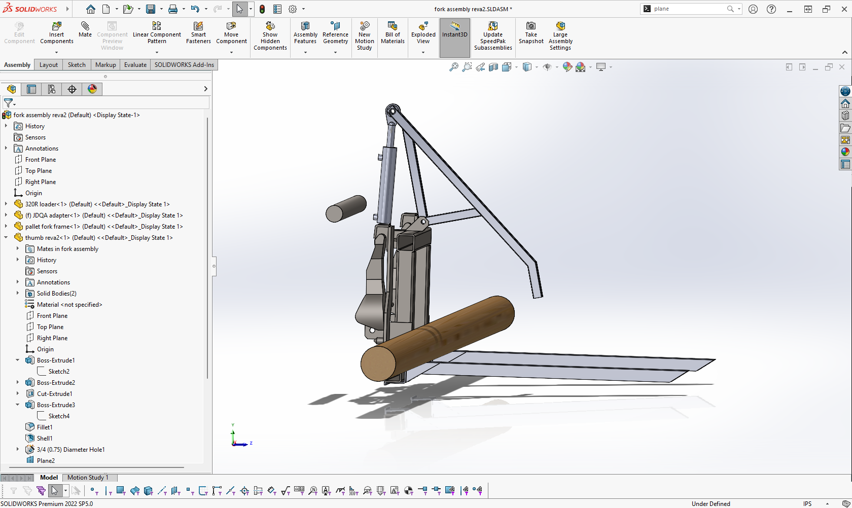

Two options:
First, I could quickly and easily add another tube section mitered onto the end:
Second option is more work without a plasma cutter, but I could cut a piece of 6 x 3/8" flat stock I have into a curve, and weld it onto the bottom of the arm. This might be prone to side-bending if it's just a single thickness with much extension from the arm:

I thought I'd be able to more slowly release it with the straight arm than the curved, to be honest. Have to think that thru, as one serious shortcoming is the fact that the 3rd function I have available to control this is off a "bang-bang" electric solenoid controlled by thumb switch on my joystick, it's not proportional.
Speaking of which I was planning to add needle valves or restrictor plates to the input ports on the cylinders to be able to adjust thumb speed, unless Deere offers some valve similar to the 3-point float-down valve, to do the same right on the tractor.
The most frequent use will be lifting logs off a pile and setting them on the ground for bucking, in which case I think I can control the descent by how steeply I angle the forks down. The other potential use would be lifting logs out of a trailer, but I'd need shorter forks to get into the trailer more easily, and I'd have to be careful not to catch the far wall of the trailer with the thumb. It's a closed-side trailer with a railing about 2 feet above the floor:

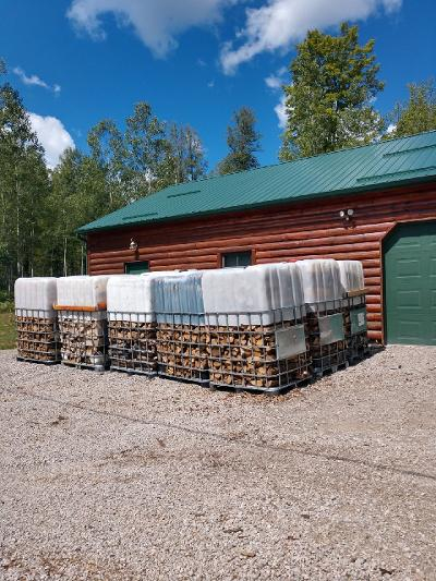

I did not explain "six foot high" very well. This is what I have to pick up once the splits are loaded into totes:
/ The "thumb"
#13
Those totes usually have an ID somewhere around 38" x 46", which when filled to 5'6" depth (for 6' total height) with fresh-cut oak (63 lb./cu.ft. at 66% stacking density), will contain about 2780 lb. of wood, and weigh a total of 2900 lb. When dry, that wood weight will drop to about 1900 lb., making the loaded tote weigh about 2030 lb. Either way, I'd probably be moving them with the forks on my 3-point hitch, not the loader, esp. over my hilly property.
But you bring up a good point, in that this thumb will be easily removed by pulling two pins. This was the reason I had asked if they needed to be bushed and greased, as pulling greasy pins is always less fun than dry. Perhaps rather than making the cylinder and arm removable, I should make the arm extendible, such that I can just remove the extension (rather than the whole assembly), when needing to grab something taller.
/ The "thumb" #14
I have estimated the capacity of the modified totes at 1.4 cords. I have never lifted one higher than two feet off the ground. My loader is rated at 2700 lbs and has been handling them. But I have flat ground and go slow and easy. Next year I am moving to 1/3 cord bulk bags but they still stand about 6' high.

Several miters of tubing with side plates or gussets would make a strong, curved beak. Flat bar would also give some bite to prevent side slip. A concern on my hillside.
Thick wall DOM tubing to fit your pins for bearing and hubs. Drilled for grease zerk. Spread the load forces and gives good service life.
