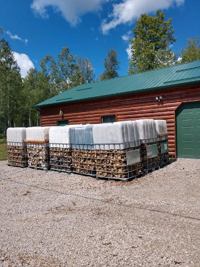

I think you must have an error in your math. If we assume ID = 38 x 46" for the standard 40 x 48 inch totes, and you manage to cut your wood to fit without even 1/4" gaps (like Tetris-perfect), your best case 0.52 cords while keeping the total height at the 6 feet you had mentioned early. In reality, given your wood is probably not of a length that perfectly fills the tote, it's probably a bit under 0.50 cord.
Another indicator these are not 1.4 cords per bin. Check the cord weight of firewood, your 2700 lb. loader would get 1.4 cords of most species off the ground. Figure nearly 5000 lb. per cord for green oak, or 3600 lb. after drying. Your estimated 1.4 cords per bin would be 5000 to 7000 lb. per bin.
In any case, my tractor (JD 3033R) is too light to move that kind of weight on the loader, so not relevant to the design of this particular thumb. If I have to move something anywhere near that heavy, it'll be on the 3-point!
Yes...1.4 face cords. My bad.

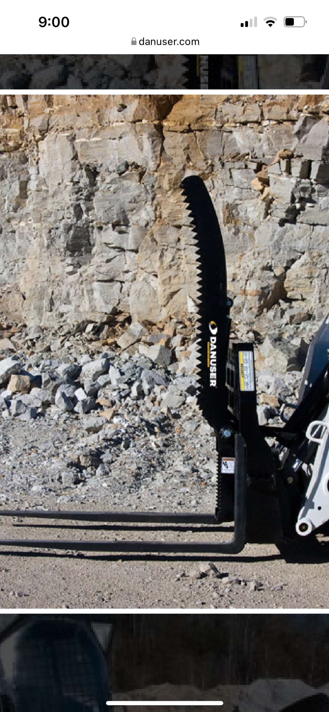

I would want the clamp to be able to open flush with the pallet fork back frame to at least the height of a standard pallet. I had one of these and I quickly grew tired of it damaging pallets and took it off and used my regular grapple instead. View attachment 777208
That is the best one I have seen but you are right. It will still damage totes with those “teeth”.

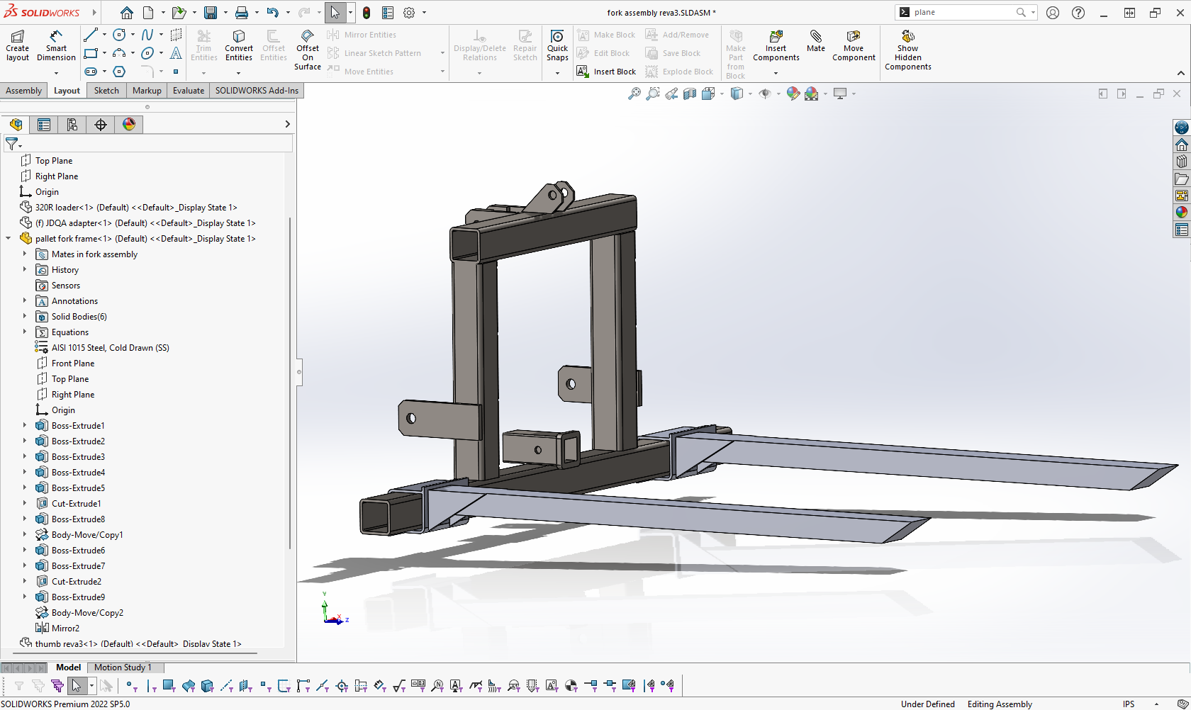

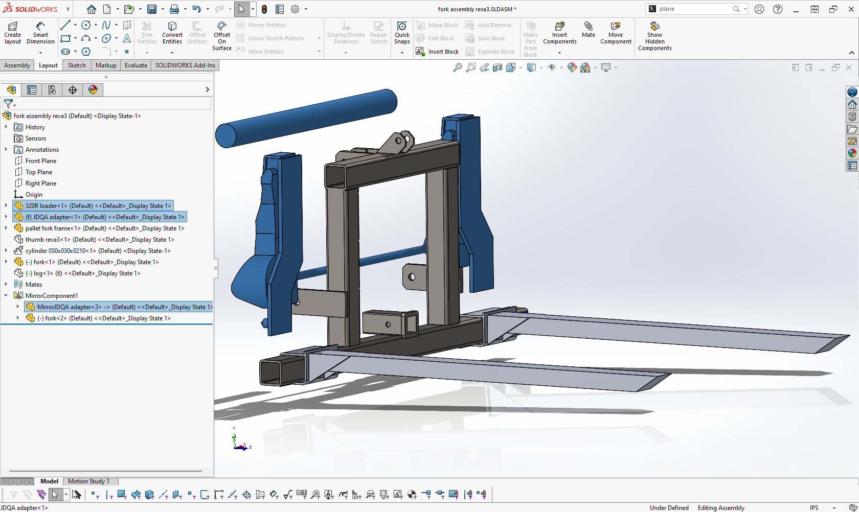

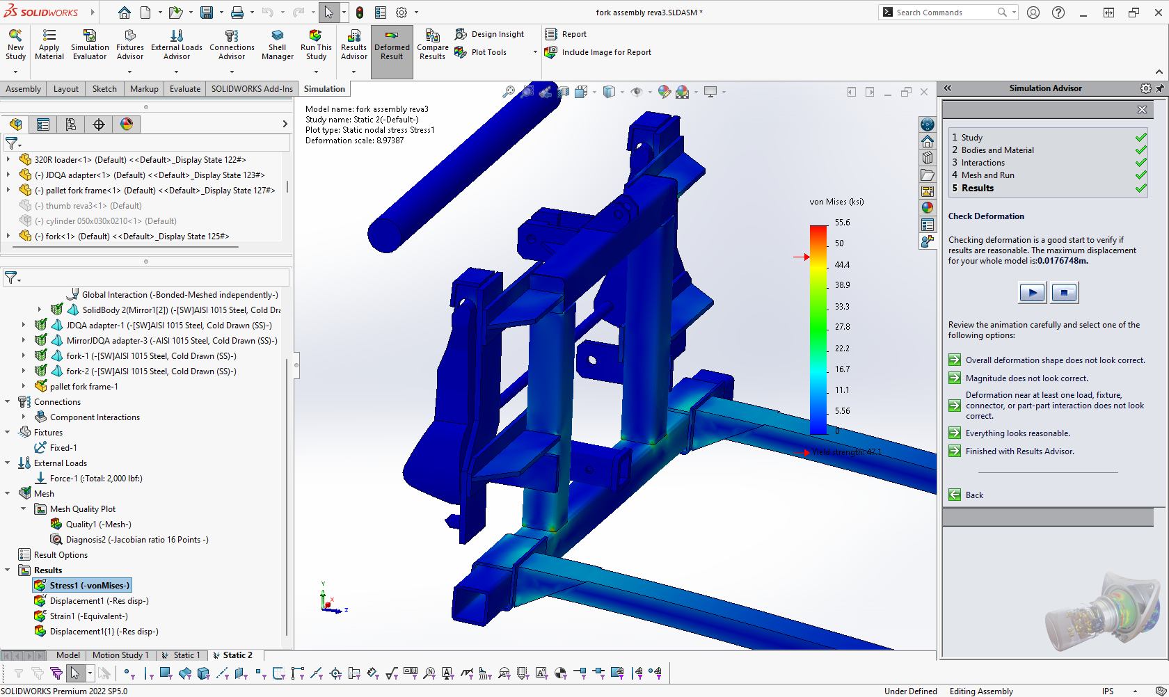

So, I did a simple stress analysis of the rev.a thumb with the straight back, just to get a sense if 1.5 x 1.5 x 3/16" square tubing would be strong enough to withstand the pressure exerted by the cylinder. It appears it's more than sufficient, which was a surprise.
The steel is all better than 47 ksi yield, and I'm not seeing anything even approaching 1 ksi, other than the walls of the cylinder itself (purchased). The displacements are all less than .003" at 2500 psi hydraulic pressure:
(click thumbnail for full size)
Trying to figure out how to get the software to tell me what pressure the arm is exerting on the log at the interface, but its not cooperating. If there are any SolidWorks sim experts out there reading this, speak up!

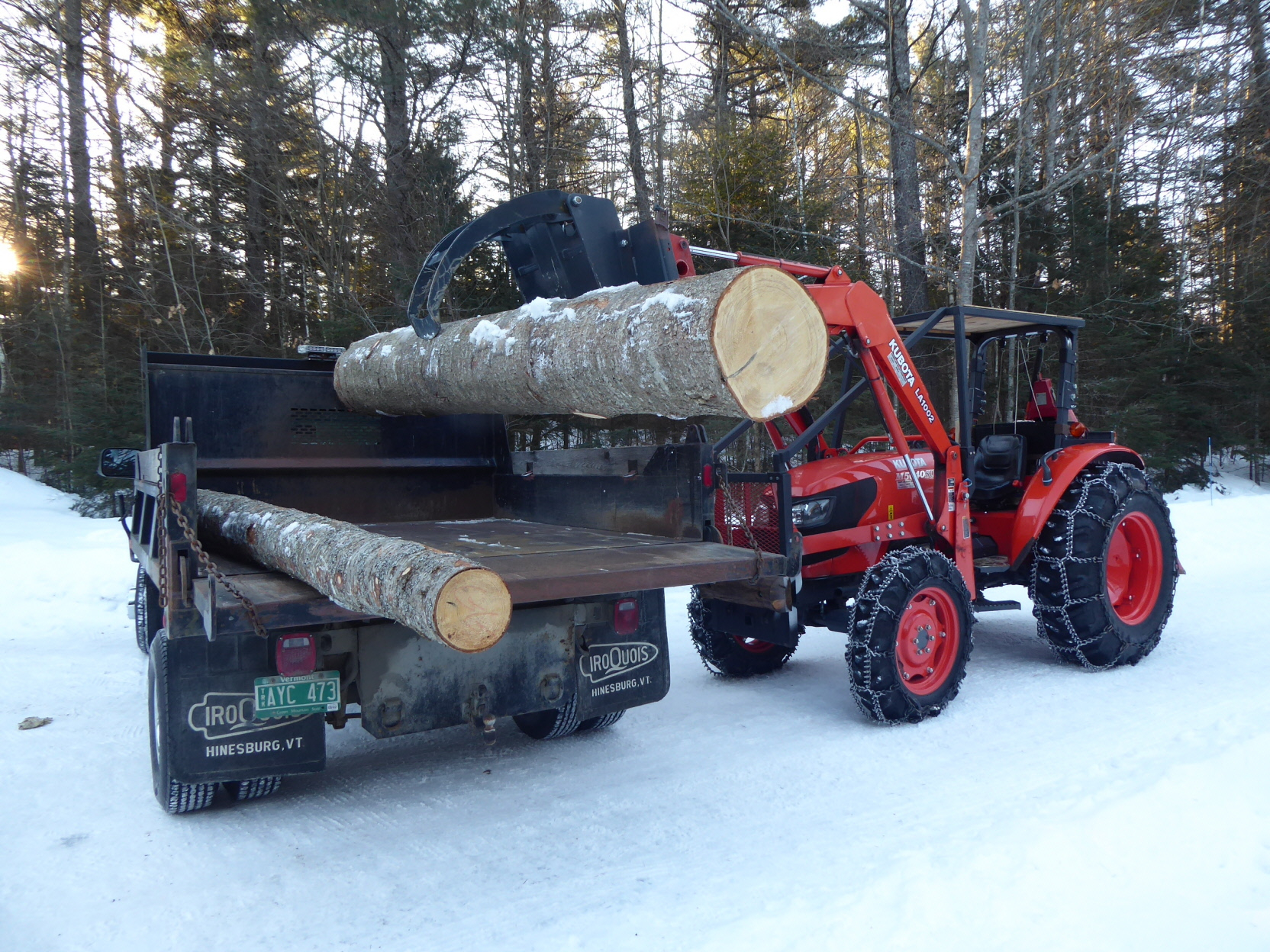

One thing that bothers me with my design posted above is the short distance between the thumb pivot and where the my piston attaches to the top link of the 3-point pins already present on the fork set. The effect is that the ~7000 lb. exerted from the piston translates to very low force out at the end of the thumb.
But I see now that your thumb pivot appears to be very close to the point where the piston attaches to the back of the thumb. Is that section of square tubing to which the thumb attaches fixed solid, or does it also pivot down at the fork frame?
I drew an arrow to the piece I'm talking about, in your photo:

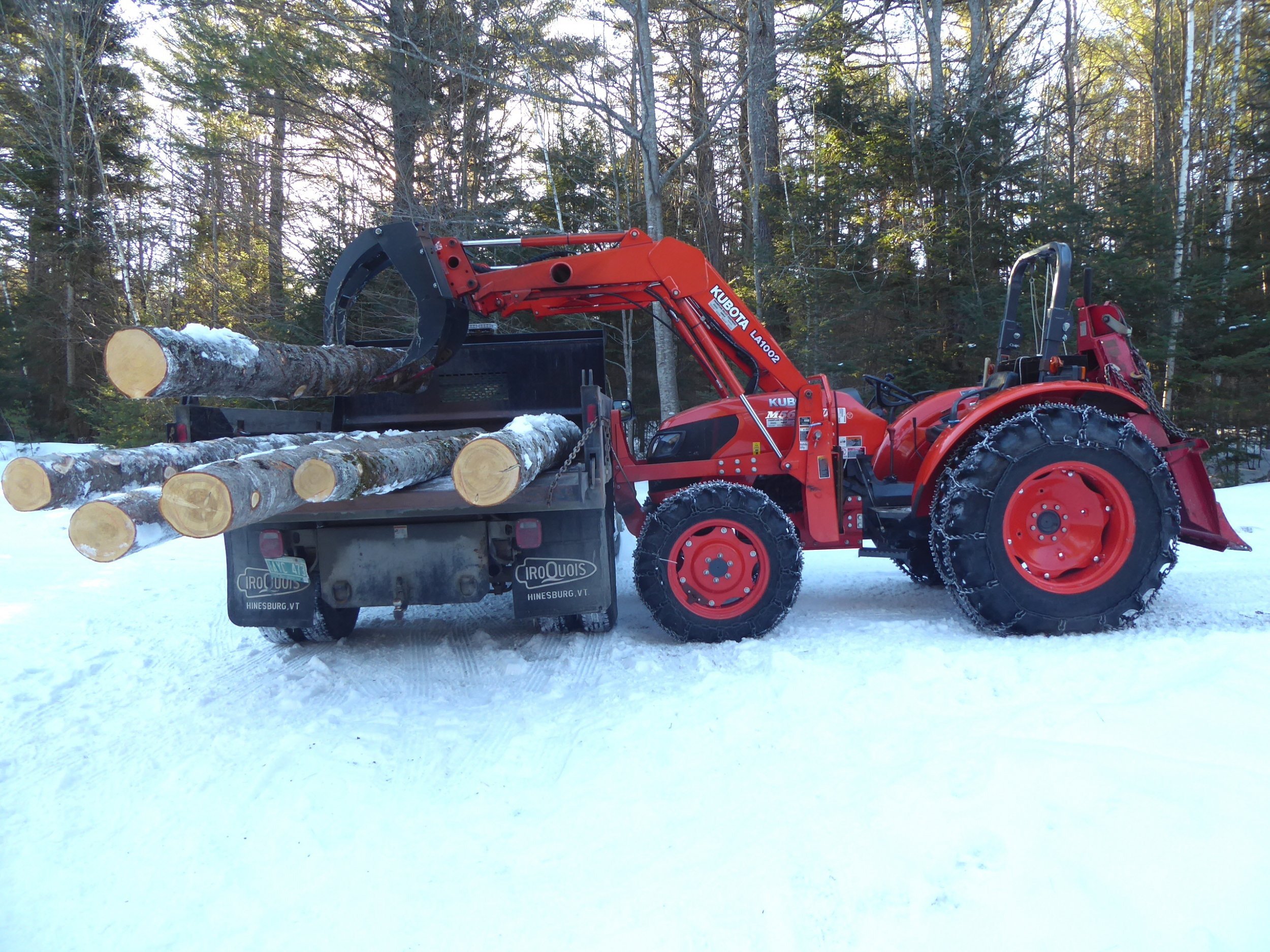

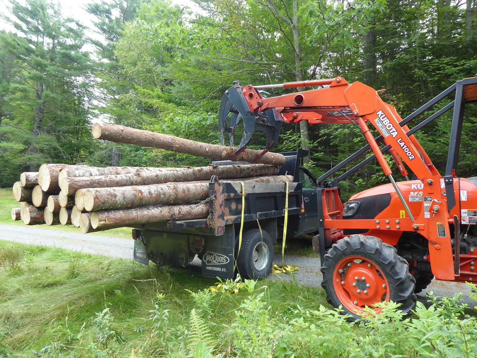

I'll share some pictures of similar style of thumb and forks setup we have here for brainstorming purposes.
When I'm doing DIY projects, I usually look at lots of pictures and absorb as much as possible.
/ The "thumb" #39
It's solid and it has amazing amount of clamping force, obviously it has a very good cylinder on it.
BTW, it's not square tubing, it's heavy channel iron and super strong.
SR

Thanks, @ptsg and Rob! Those photos are super helpful @ptsg, as I never even considered mounting the cylinder that way. I will definitely play with that idea.
Thanks for the info on your setup too, @Sawyer Rob. It looks like a I have some time to play with ideas, a new project that came in is going to keep me away from doing much personal fab work the next few weeks.
