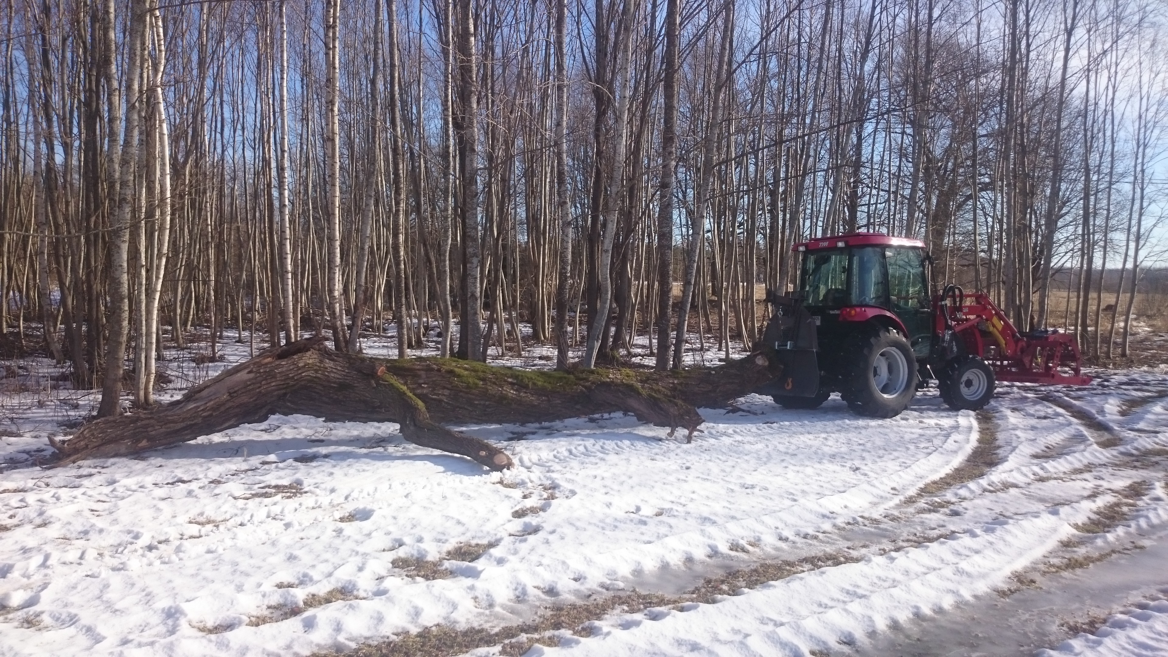

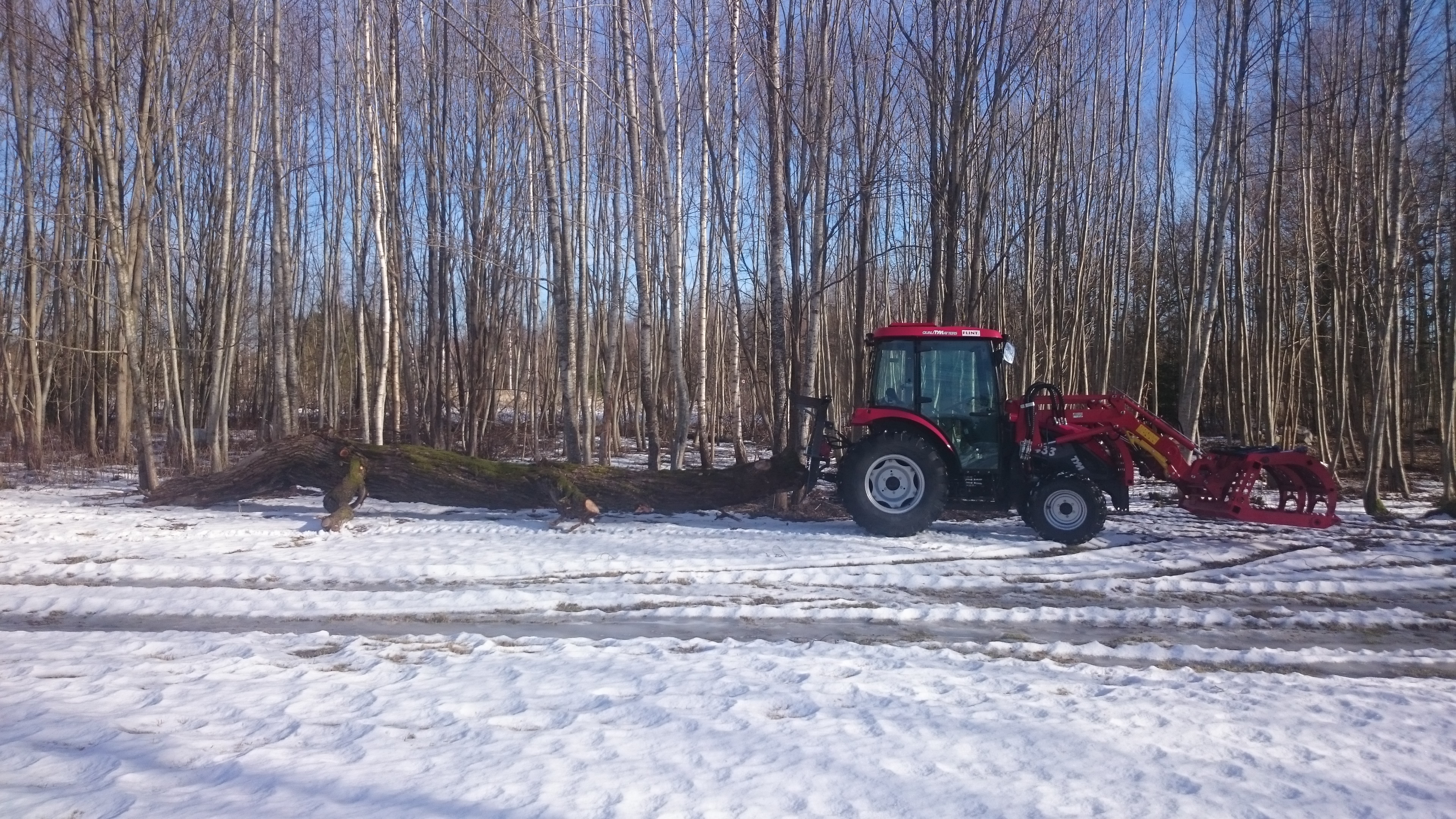

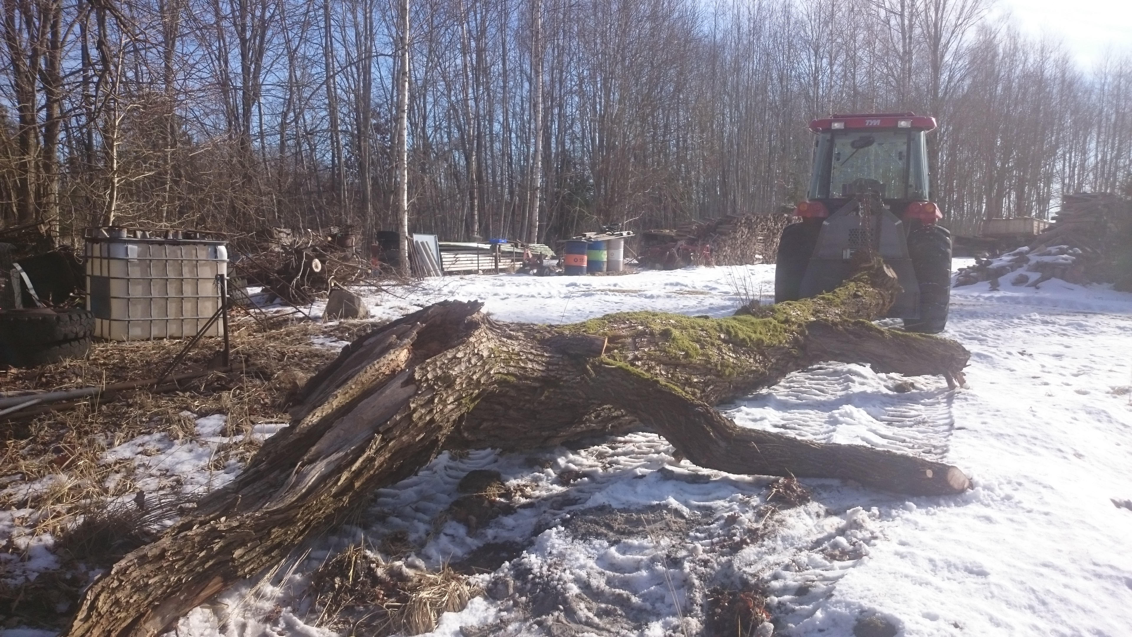

Ok, another update!
I pulled the last 14' piece of the tree in today, I set the tractor at about 1500 rpm's, it came in rather quickly :) My tractor idles at about 800-900 rpm's

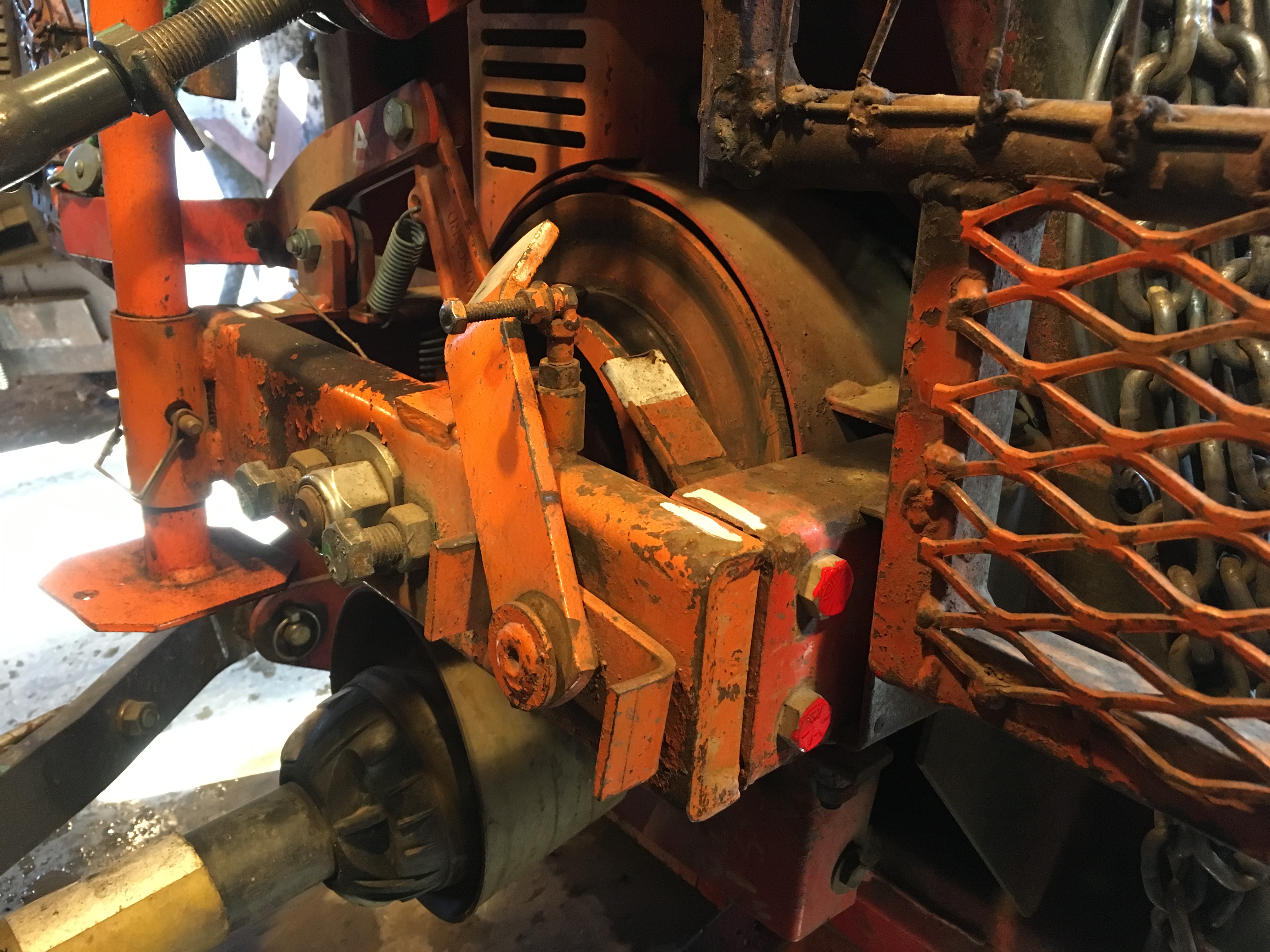

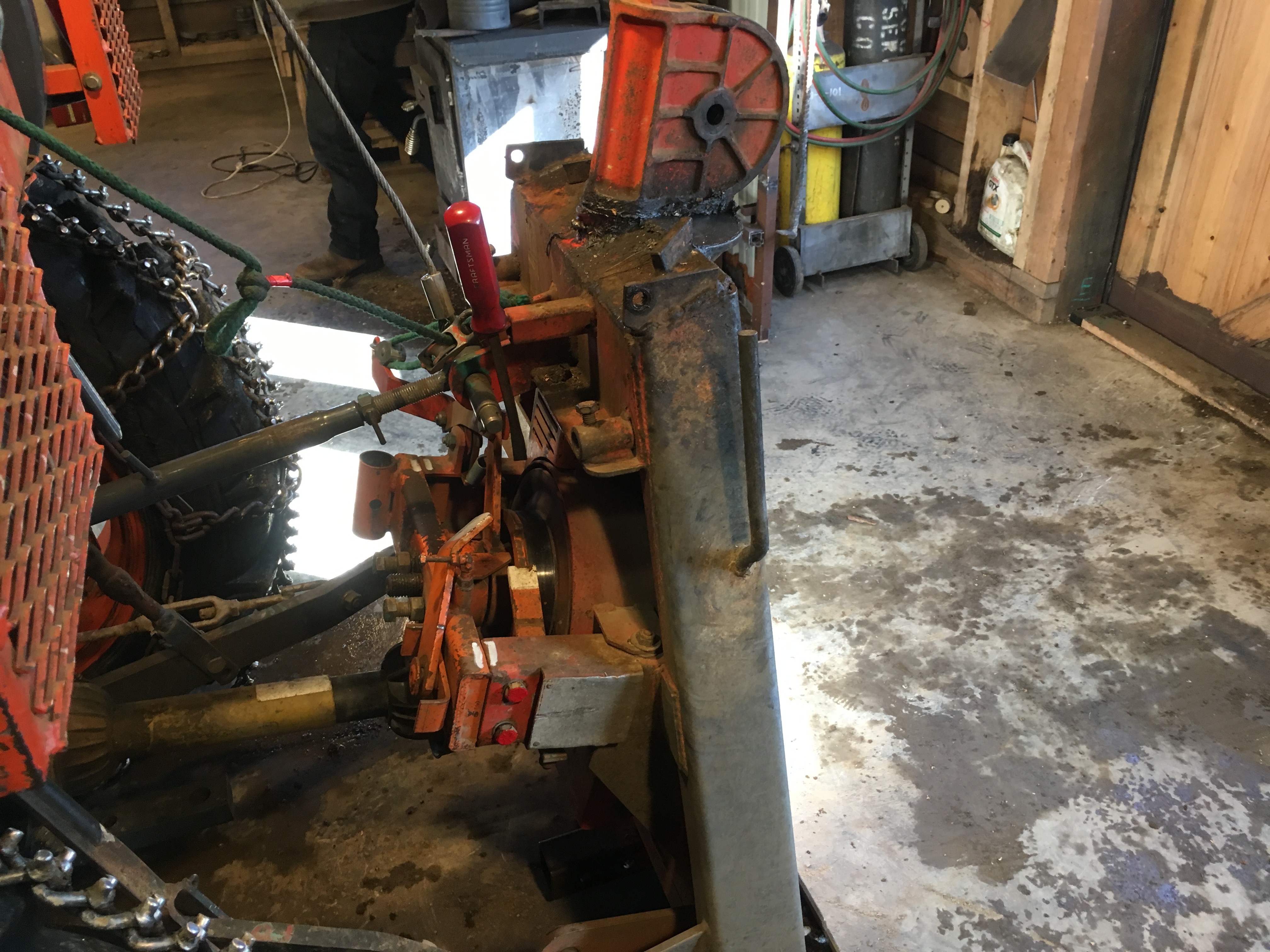

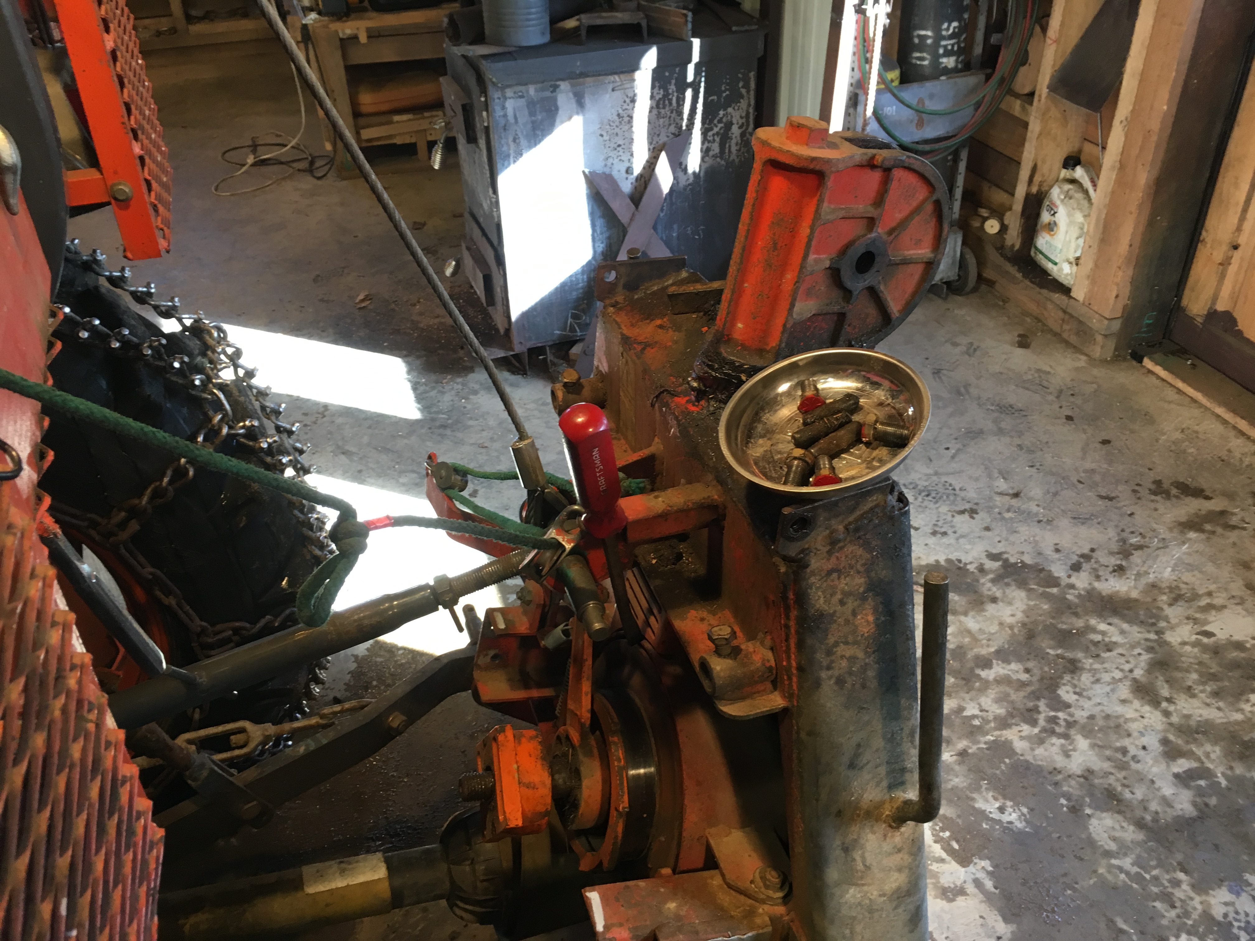

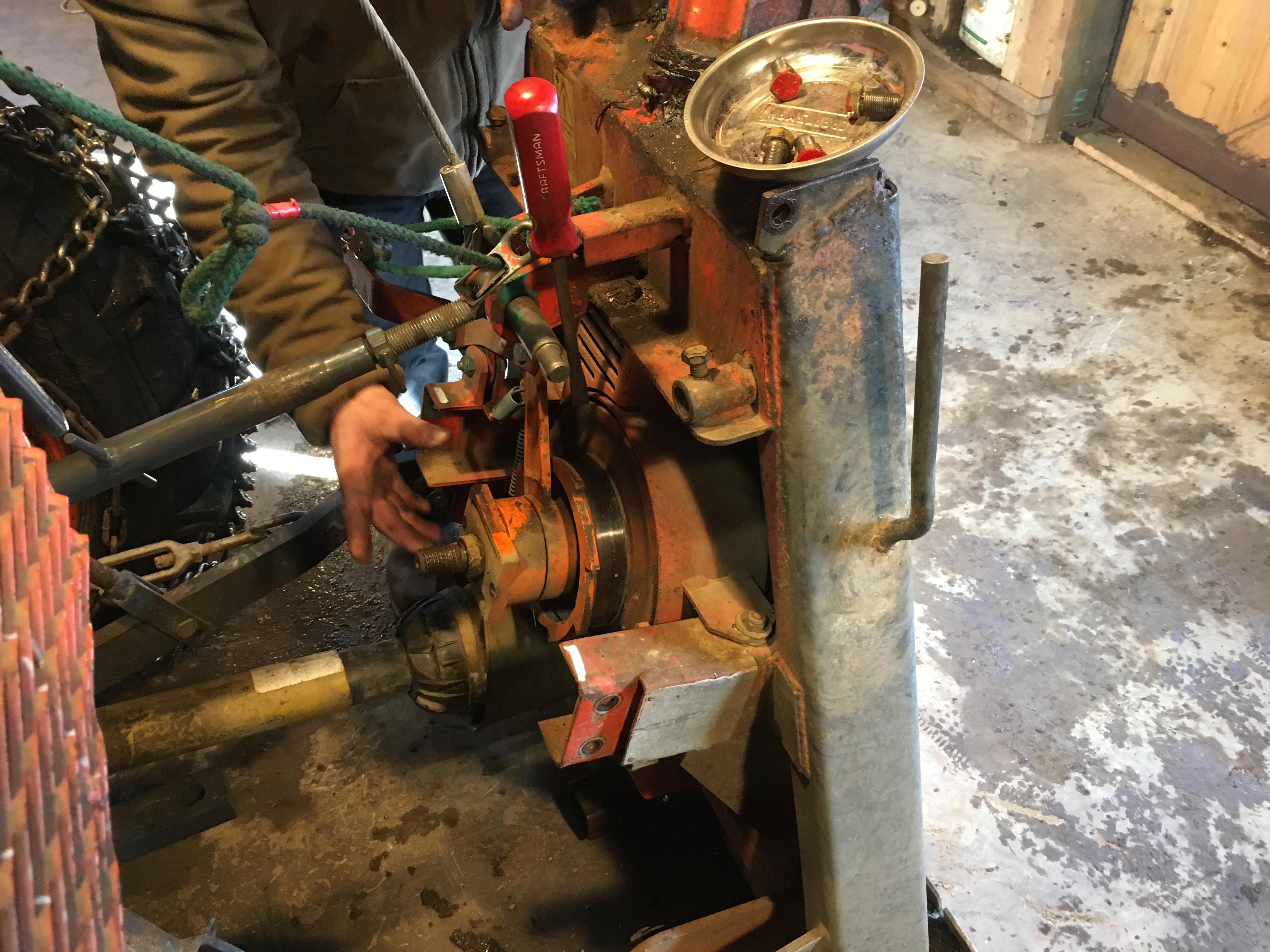

I think your epiphany will work a lot better this time, as you said (even pressure around the thrust area) and free spool is a big plus. That last picture to me looks almost like the same idea on my Fransgard, your ramps are external, my ramps are internal but uses 3 floating pins set in ramp shape grooves between the front block and the block handle (3rd pic) and that pushes the spool against the brake pad sprocket, the three pins are in the tray nest to some bolts on top of winch in last pic.
Also the pull rope goes threw a small pulley then routes back to the pull side for more leverage or fulcrum. My winch is still apart, waiting for new bearings for the spool.

Looking at your pictures raises a couple of questions. Did you make the mechanism to hold the brake lever in place? Also, regarding your recent comment about the top pulley; perhaps a brace on top, so that all of the pressure isn't on the bottom of the pin? I never had the problem which you describe, yet by the time I sold it the frame was bent so badly that I had to adjust it (with my 16 lb sledgehammer) after the spool wore a groove through the outside housing.
Anytime I took my old Fransgard apart I would lay it on it's back which made things easier to get to.

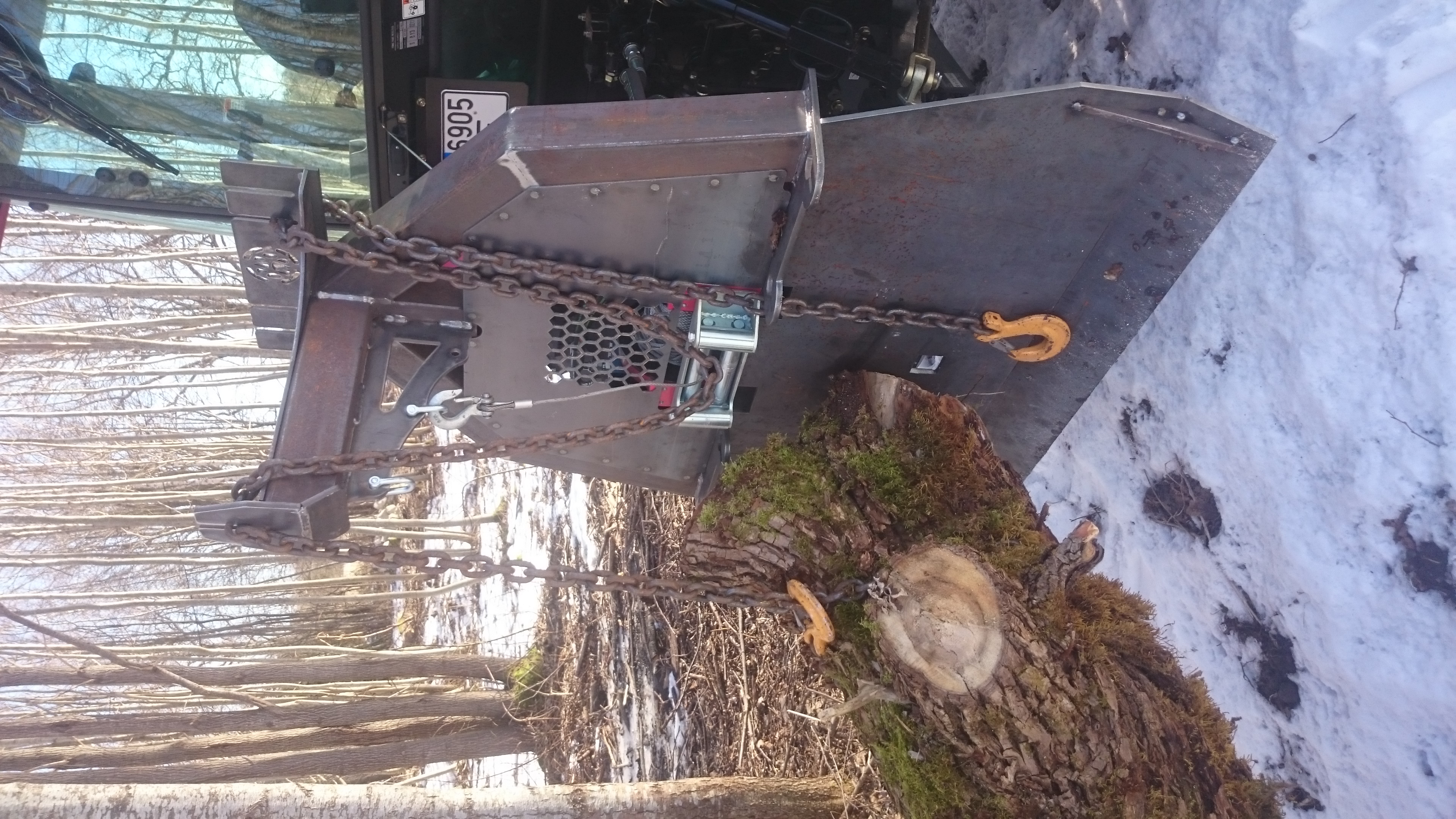

Yes it hard to mix metric with inch, I think your going the right way, I was just comparing what I thought was the similarities of your idea and how Fransgard engages the clutch. As far as slipping, my 8mm cable usually breaks on my winch before clutch slips and or pulls tractor backwards, that's why I tend to do the hard pulls straight on so's not flip tractor over incase my reflexes are slow, and this is I think the smallest winch Fransgard makes.

Oh no, the pictures was supposed to raise answers. Ok atleast the 1st question easy, yes that mechanism by the brake holds the lever over, couple times while winching when tractor leaning a little, a tree bumps against something and jars the tractor a little and the locking dog would flop over or half catch the teeth on spool, the trees fall back on the ground, so I just tack weld that stud on there and the lever stays locked fully on teeth until I swing the lever back around. Next ???, I got to do some Sherlocking on that pulley ???

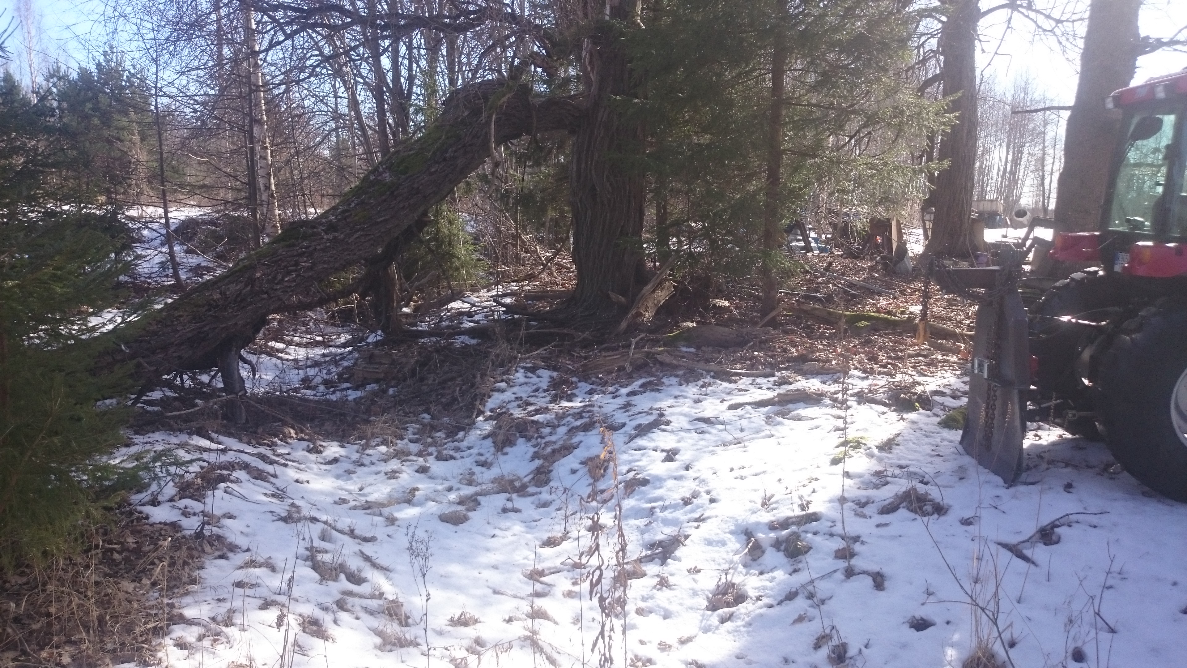

I loaded the tractor up and hauled it over to my buddies property to skid some trees for next years firewood. The first tree I hooked to was a 24' piece about 12" across at the butt, yanked it to the winch like a champ! I ran that one to the pile and came back for another larger Maple, I knew I couldn't haul the entire thing so I cut about 20' off the bottom which is about 20-21" across. I hooked it up, gave the lever a push and I heard a clunk, looked and didn't see anything too obvious so I gave it another push and heard a terrible clank,!
