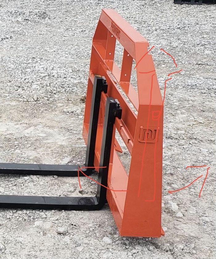

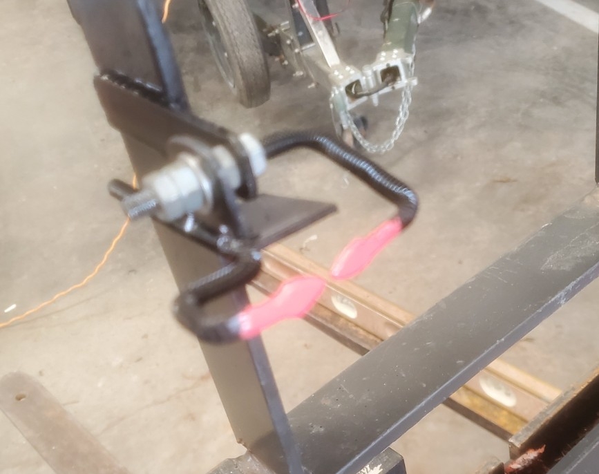

Got inspiration from this thread and built a prototype. Sorry for a bad picture.
So far works very well, no mater how high the forks are, it always show when they are parallel to the ground.
I'll give it a try for a while and see if it is useful i'll build something better.
I could see a bar attached to the bucket sticking up high with a pendulum hanging from it.

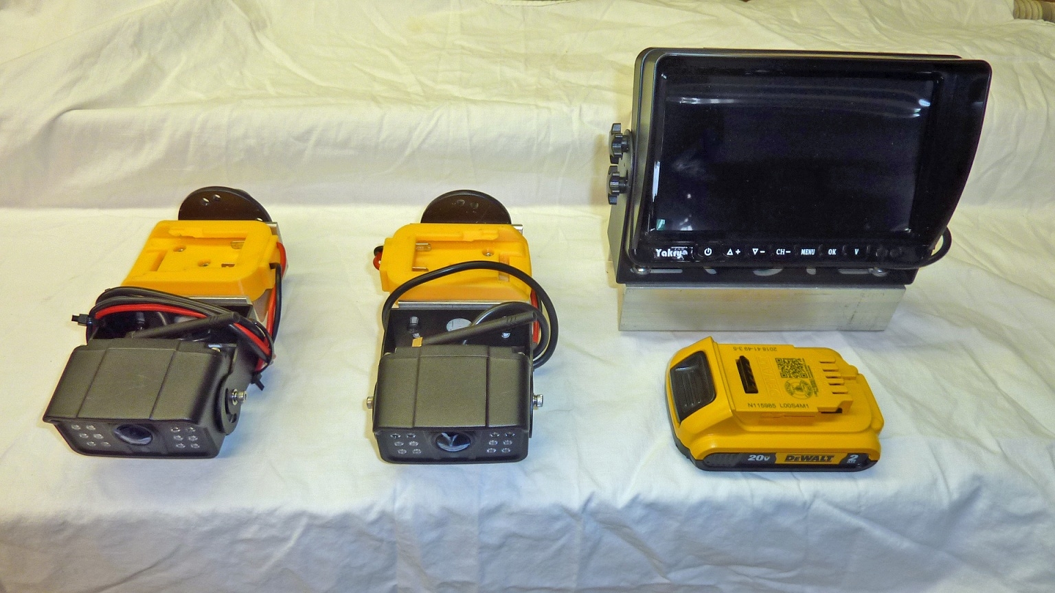

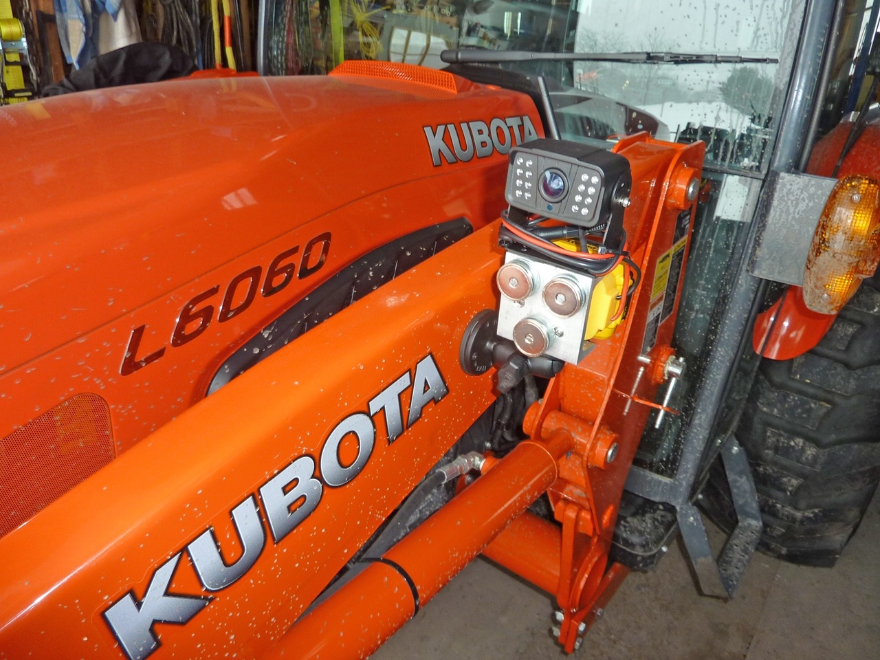

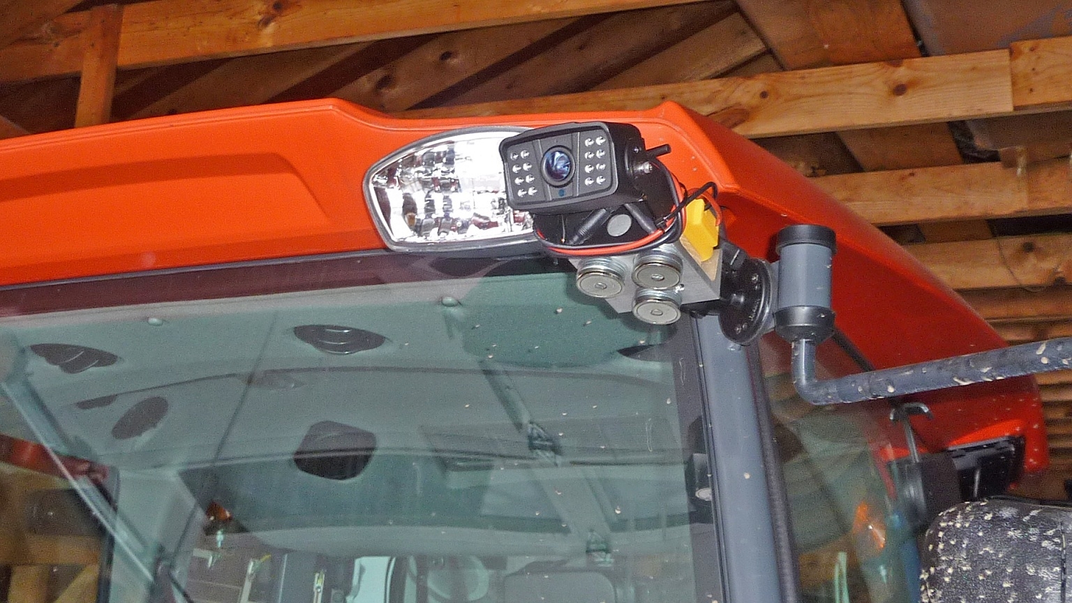

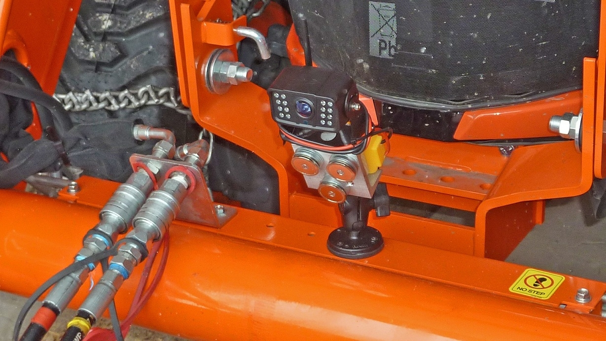

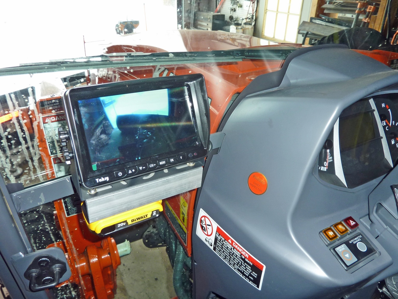

I use a portable wireless camera held with a magnet on the bucket, forks or FEL arms, or placed nearby off the tractor. I can then see the precise bucket / fork position on the screen in the cab. Once set up for a particular work operation, it works perfectly. The trick is to make sure the cameras are mounted out of harms way.
