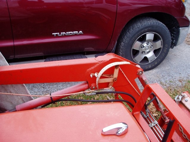

I could not find any indicator that I liked so I built my own. The curved face is linked to the bucket and rotates as the bucket is tilted. There are two pointers to indicate position. The one closest to the curved face is linked to the loader frame and shows the current level condition of the bucket. The other one is fixed position to show where the loader will be when lowered to ground level.
The dimensions required to make it work accurately are a bit tricky and would be different for each loader so some experimenting is required.
Interesting design. How well does it work for you?

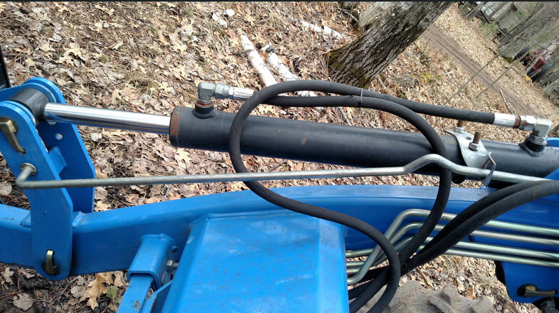

Use mine all the time...it has a factory bend in the indicator rod, so it follows the curve of the loader arm. It's tucked out of the way.
