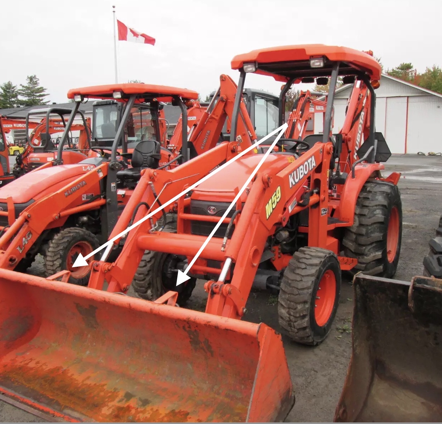

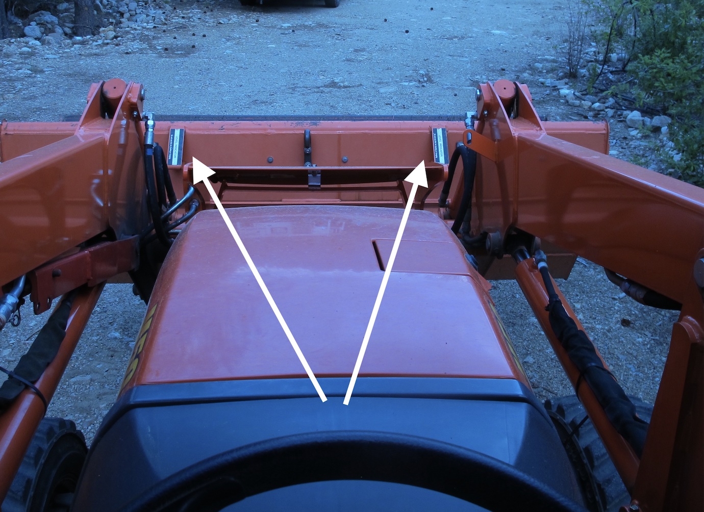

I fiddled around with the bucket level on my L4060 for a year or two, then just gave up. I can see the bucket's flat top, and my eye is much more accurate than the steel rod, marked or not.
That's what I do. The Kubota bucket has two pieces of strap steel welded onto the top of the FEL bucket so that they set at exactly the same angle as the bottom of the bucket.
Ours have reflective tape, and Kubota positioned them where they are easy to see past the hood.
Much easier to see than an indicator rod, quieter, and I find it easier to tell the angle of the bucket.

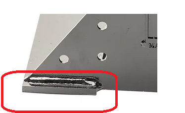

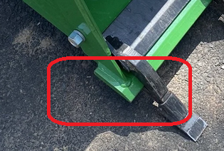

I've never had one and never thought of needing one. Am I missing out on something?????
Seems all my buckets and fork cage have welded edges like this so I just look at either side of bucket to see if bucket running parallel to the ground, or trailer deck or heaped piles or whatever i want to match or adjust angle to. going to pay more attention to this tomorrow as I go push some snow.

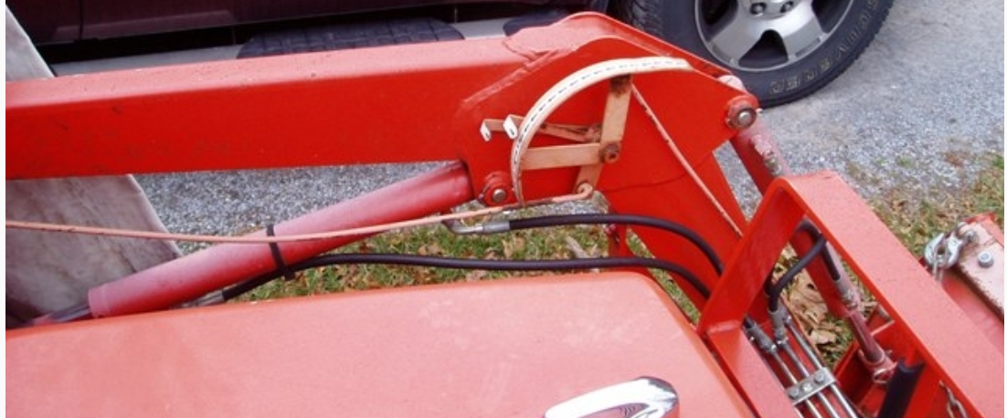

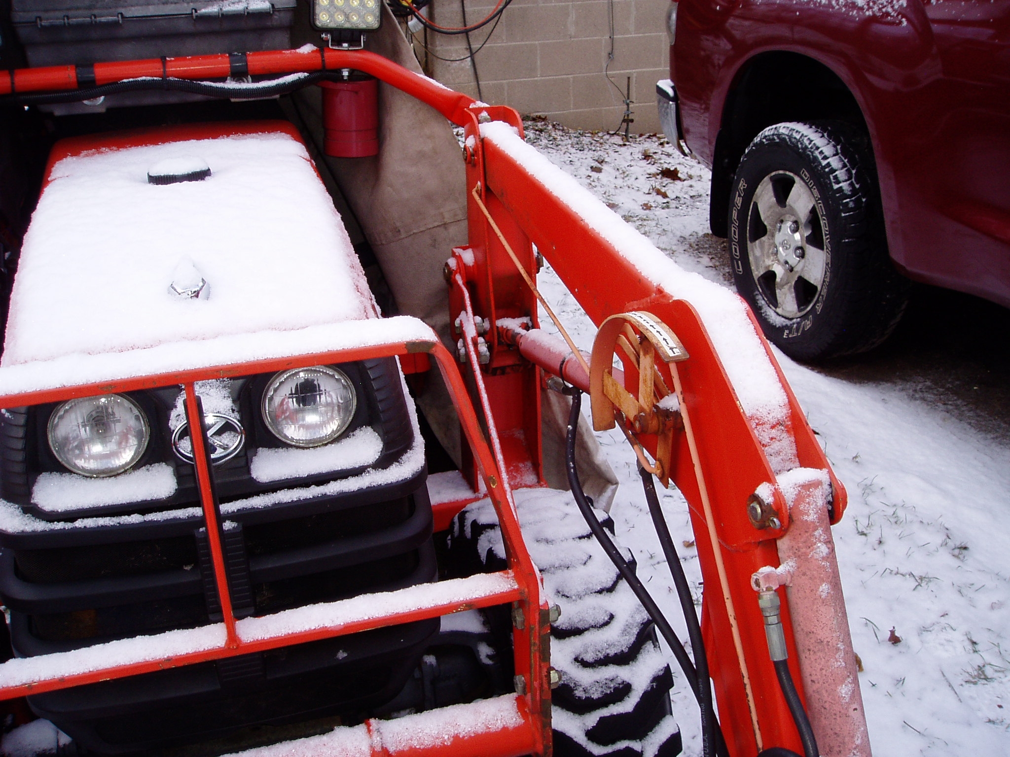

I could not find any indicator that I liked so I built my own. The curved face is linked to the bucket and rotates as the bucket is tilted. There are two pointers to indicate position. The one closest to the curved face is linked to the loader frame and shows the current level condition of the bucket. The other one is fixed position to show where the loader will be when lowered to ground level.
The dimensions required to make it work accurately are a bit tricky and would be different for each loader so some experimenting is required.
It would be nice to see more pics of your set up. What is the purpose of the lower rod on the left?
   / Fragile, Inaccurate, or Useful? Let’s Talk Bucket Level Indicators! #24
That rod moves the inner pointer which indicates the bucket level at the current lift arm position. It is primarily for finding level when using a fork attachment or grading something above ground level.
Here is a front view which shows most of the linkage.

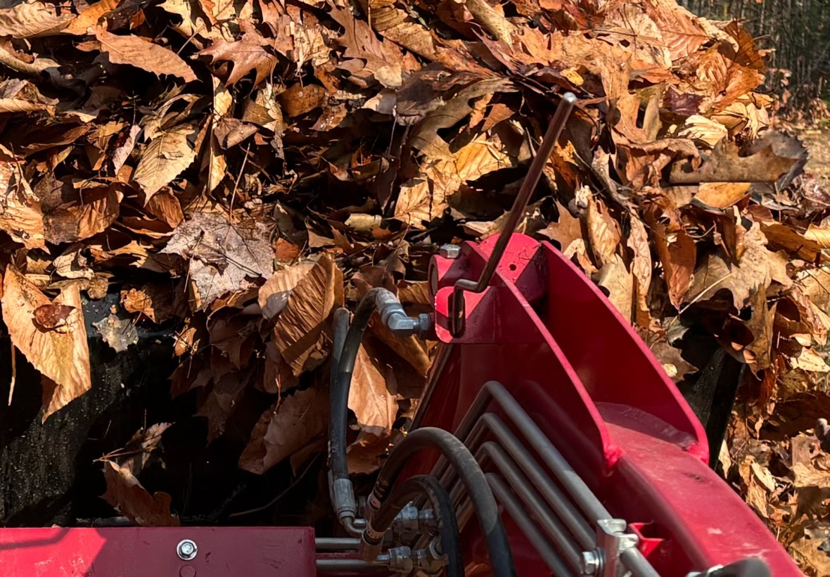

I find a bucket level indicator extremely useful. Mine is the standard pipe and rod set up. On the Massey 20C you cannot see the bottom of the bucket at all and very little of the top. A square hood, metal cab panels and poorly placed loader arms give you no visibility so I made a bucket level indicator. When operating a verity of equipment you do not always have time to develop the 'feel" for level for each machine. A level indicator is a quick way to operate more efficiently. I like the bent rod style as it gives you a better indication of how much out of level you are and they do not freeze up like the tube style does.
I like a level indicator as it lets me get the bucket level prior to setting it on the ground. This saves time as you do not have to stop to level the bucket prior to digging into a pile, or when you have to lift the boom to swing over an obstacle prior to digging. I do have to keep it out of the brush and make sure no trees snag it when mowing, but its worth it to me.
For pallet forks, once they are in the air I can eyeball level fairly well. When picking up a pallet getting the forks level that I struggle with and the level rod helps with that. I am lucky that my main set forks, and my main bucket have the same angle so I do not have to adjust the level rod much. The other set of forks are 6' long so most of the time you can see the tips.

Don't know who came up with the lame welded on indicator on the top of the bucket but it's totally useless.
My IH2500B had a similar indicator. Not just the rod through the tube. Very handy. (y)
