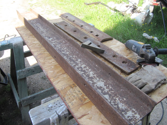

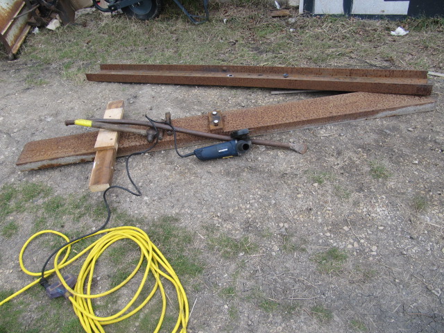

I don't expect anyone has never been frustrated while trying to level an uneven surface such as a driveway using a back blade on the 3PTH. I've been thinking about and planning to build this implement ever since my first time using the back blade. Well, a few weeks ago I got started and I'm up to the point where I have tested it out and determined some of things I'm not happy with.

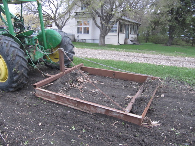

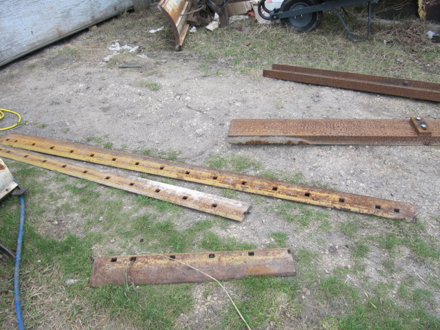

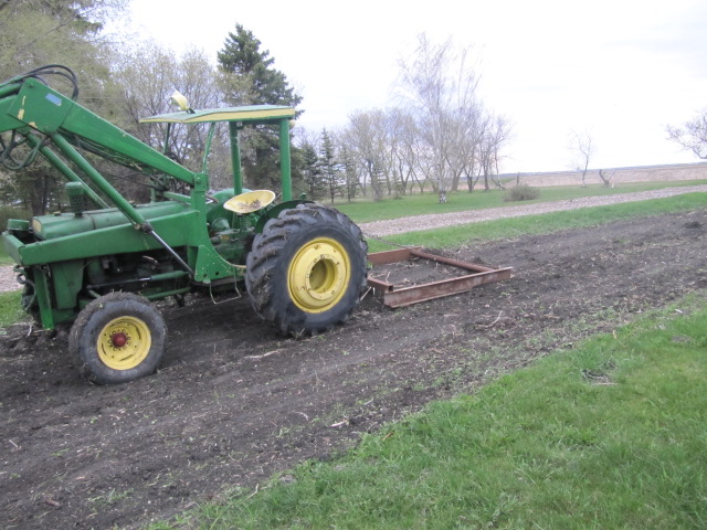

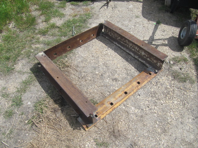

The first three photos show the basic materials I started with. I had to separate the C-channels as they were riveted together. Photos 4 and 5 show the positioning of the front blade. It's purpose is to bite into and loosen up high spots. Photo 6 shows the rear blade that picks up and drags the loosened bits left by the front blade. 7 and 8 give an indication how it will smooth out the dirt I had hauled in to fill some of the low spots on our property.
OK, now the changes pending: Those chains have GOT to go!:( And that brace at the back, too. It interferes with the loading of the rear blade. The only chain that will stay is what I'm using as the top link. It's only there for lifting the whole business off the ground. I need to reinforce everything some more to make it more rugged. Also, it needs to be heavier so I plan to place angle iron so that I can pile on patio blocks for ballast.

That's just a piece of flat bar across the back? I think the first time you find something that doesn't want to move (rock, root, etc.) it is going to bend.
I'm thinking about making one with the typical angle iron (open face down) and I'm afraid that 4x4x1/4" angle won't last past the first immoveable rock.

The pictures don't show it very well but the front blade is welded to the bottom side of the C-channels with the good cutting edge - I got these blades used from the municipality - facing down. The theory behind that is the front blade will only cut up to an inch or so and take down high spots. That material will get pushed over the blade as it moves along and be picked up by the rear blade which is mounted with the good cutting edge flush with the bottom of the rear of the C-channel. Once I have replaced the chains with rigid bracing, I'll move that rear brace, which is interfering with the overflow at the rear blade, far enough forward to allow overflow. For leveling dirt, I may hitch on a water filled/weighted roller for compaction. We'll see.

Nope, that's a pretty stiff and hefty grader blade (used) and with the brace in there, one of the welds will break instead. If I find that happening (and I don't have a lot of big rocks here) I'll gusset the corners top and bottom or wherever it seems appropriate and see if that works. Thanks for the heads up! Norm

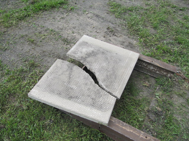

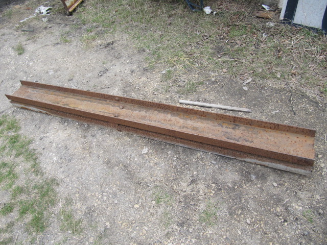

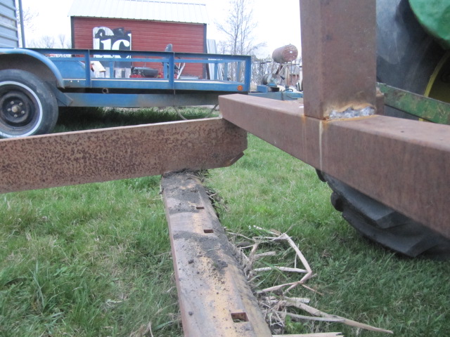

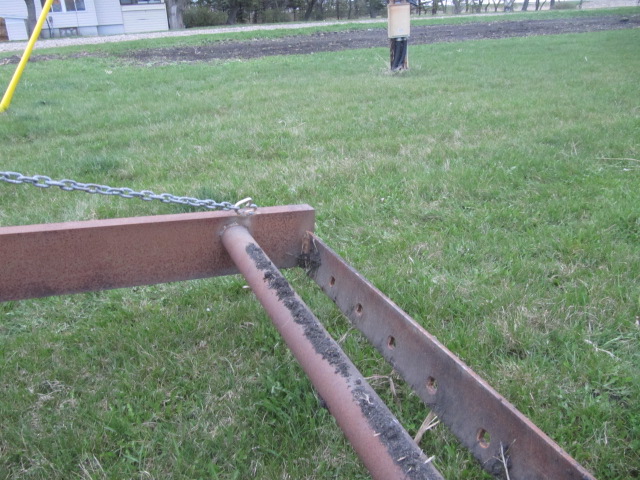

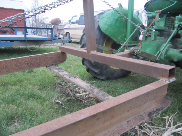

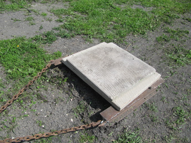

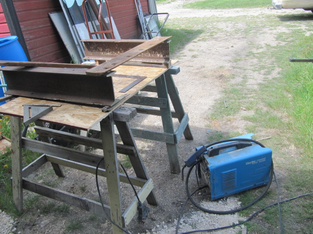

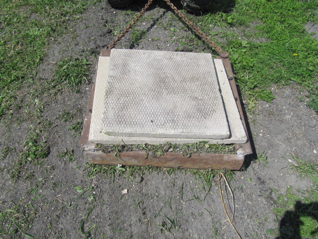

The scraper I built was never meant for the garden tractor to pull but just for fun I tried it anyway.:p;) As expected, it would sit and spin whenever the front blade took a bite of any high spots. I needed to build one garden tractor size!:)
So, when one of my coffee shop friends informed me that he had located a steel I-beam 5' long, I was good to go!:thumbsup:
1) Ready to get started 2) leveled and squared - kinda 3) ready to test drive 4 & 5) too much weight and too much bite; stopped me cold and also not enough room for debris to spill over the back 6) obviously no wire mesh in this block and so it broke after about an hour. Probably had a crack to begin with.
For now this implement will hitch up with a chain. The garden tractor has no 3PTH - yet. I need that for the roto-tiller so when I have it, I'll make those changes. For now it is doing a fine job taking down high spots and grading gravel where I don't want to go with the bigger one.:thumbsup:
