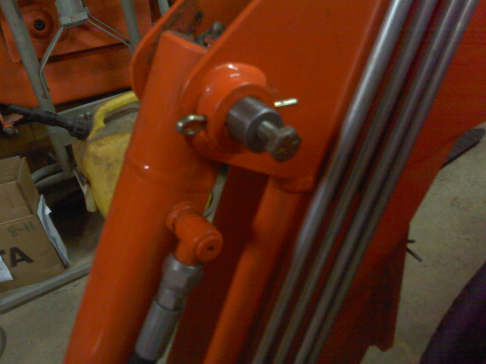

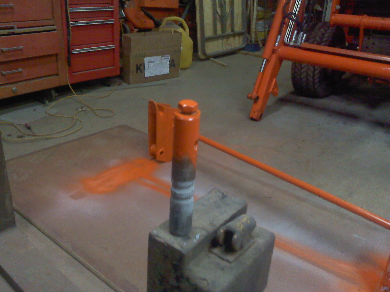

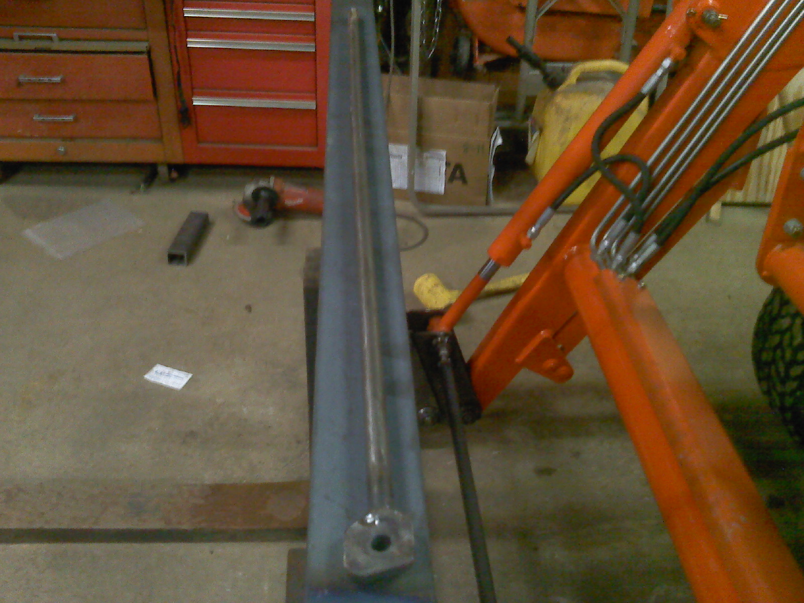

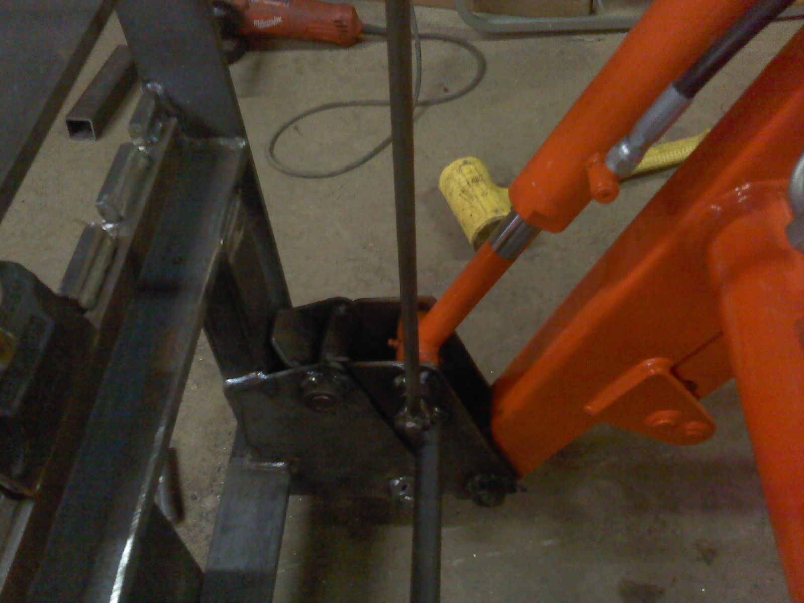

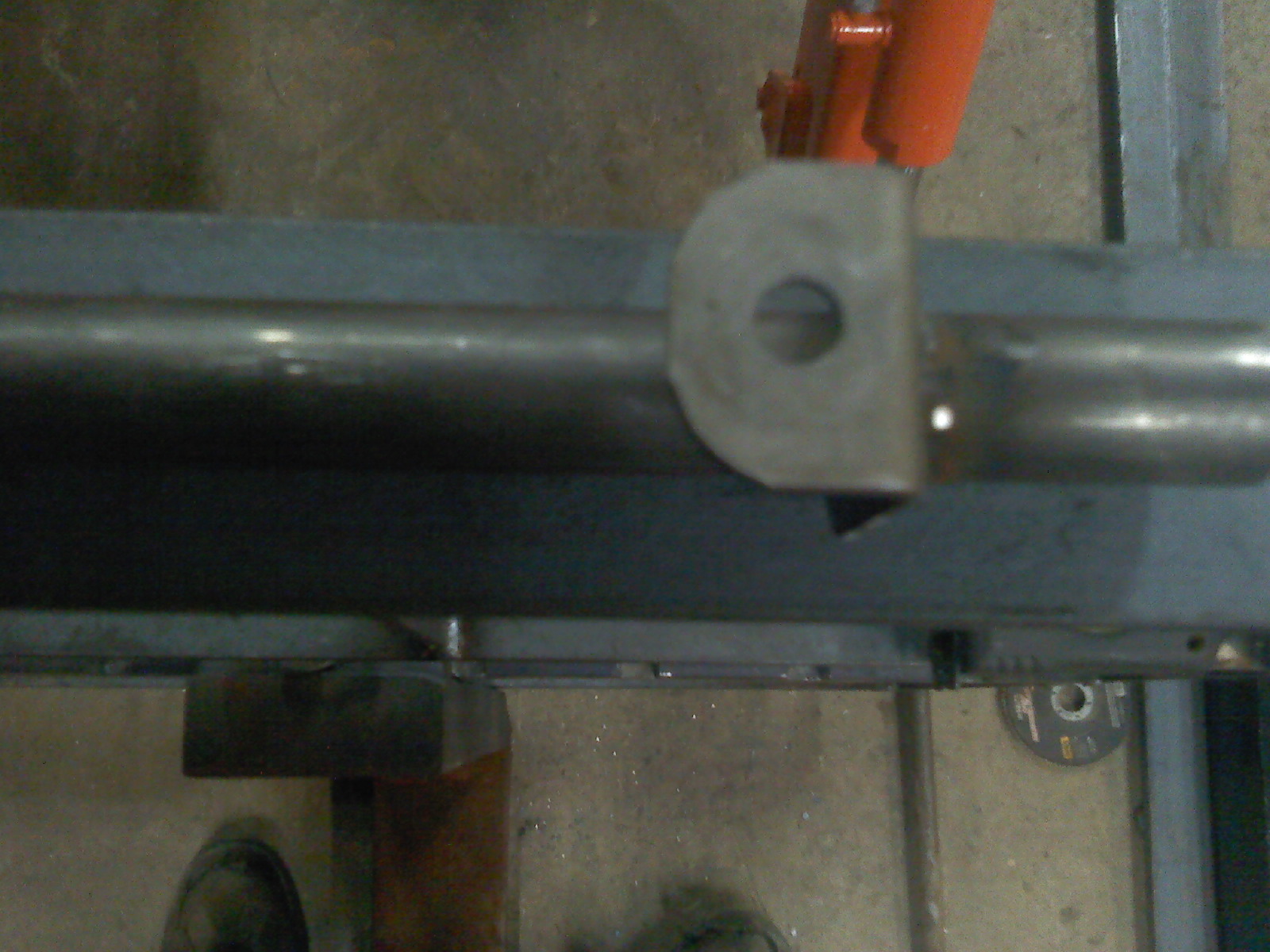

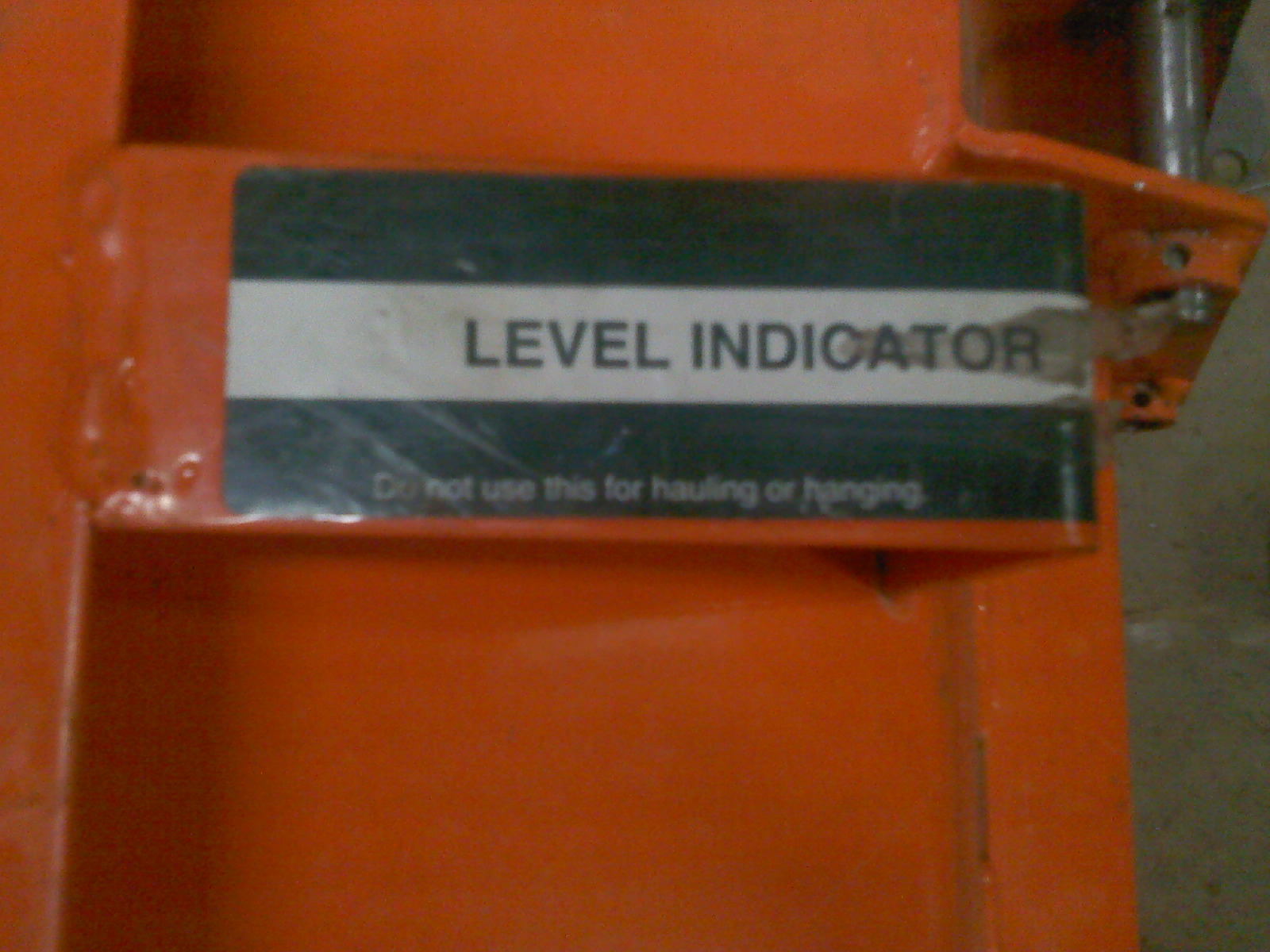

Hey Kubota, whats with the crappy level indicators on your smaller FEL's?

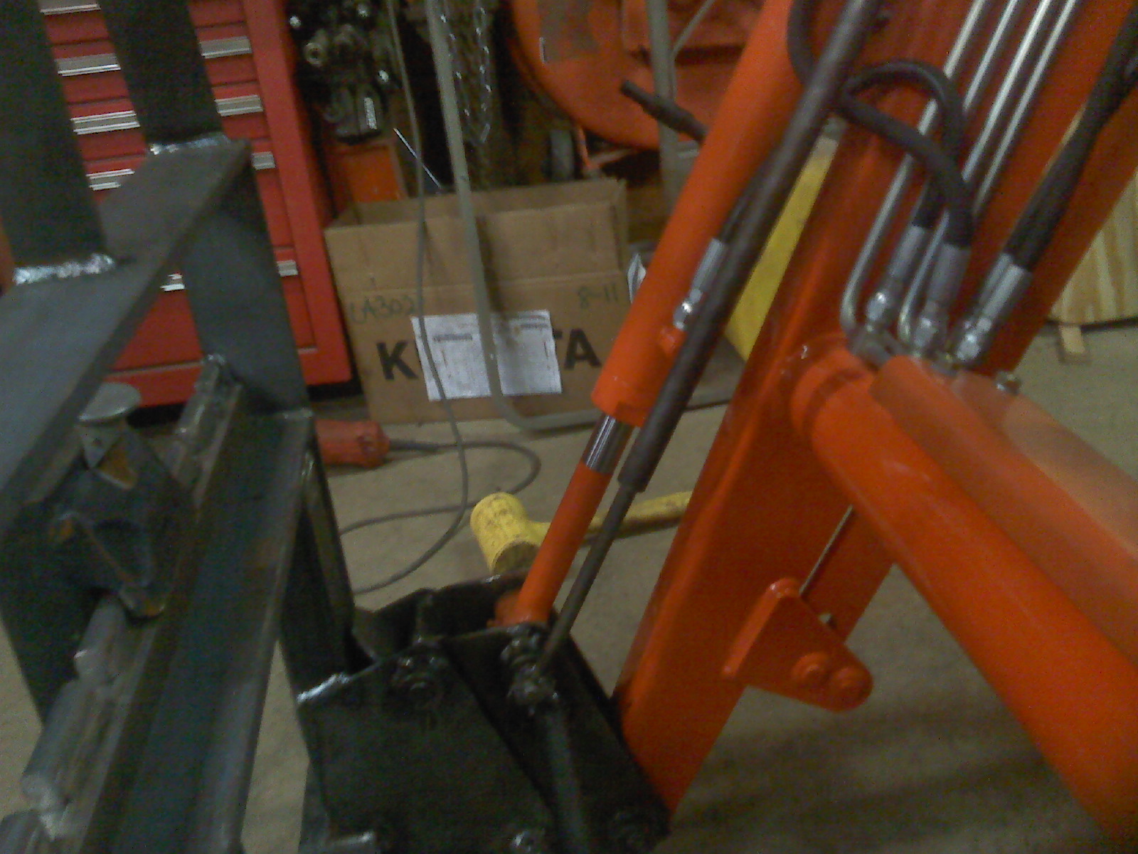

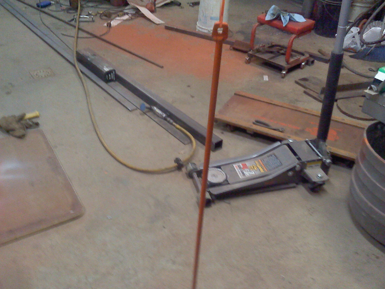

Week 3 of projects for me....since there is no snow to ride the sled on, I decided to get another project done.
Do you have the crappy level indicator that Kubota puts on the smaller loaders? I laughed when I saw it and asked the dealer if there was an option for the rod type indicator, Nope was the answer so I have been looking at different types and Used a modified version I saw on a Mahrinda.

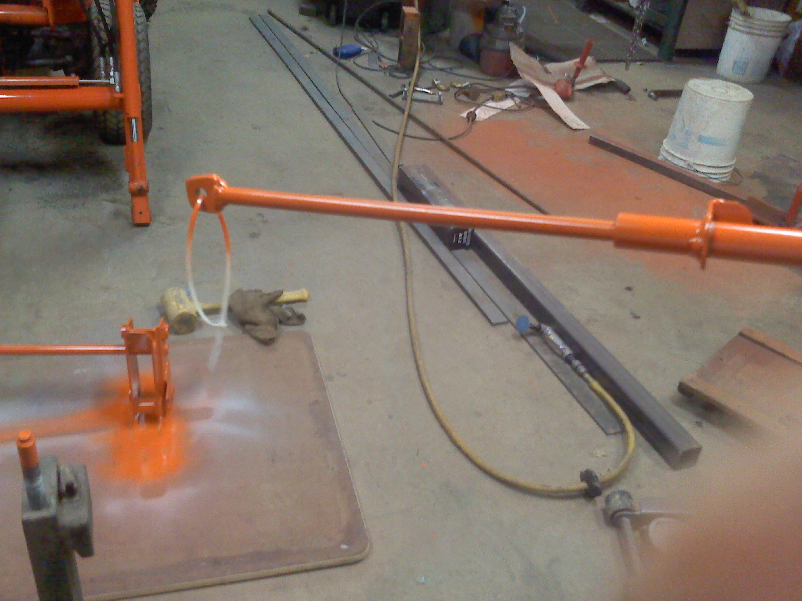

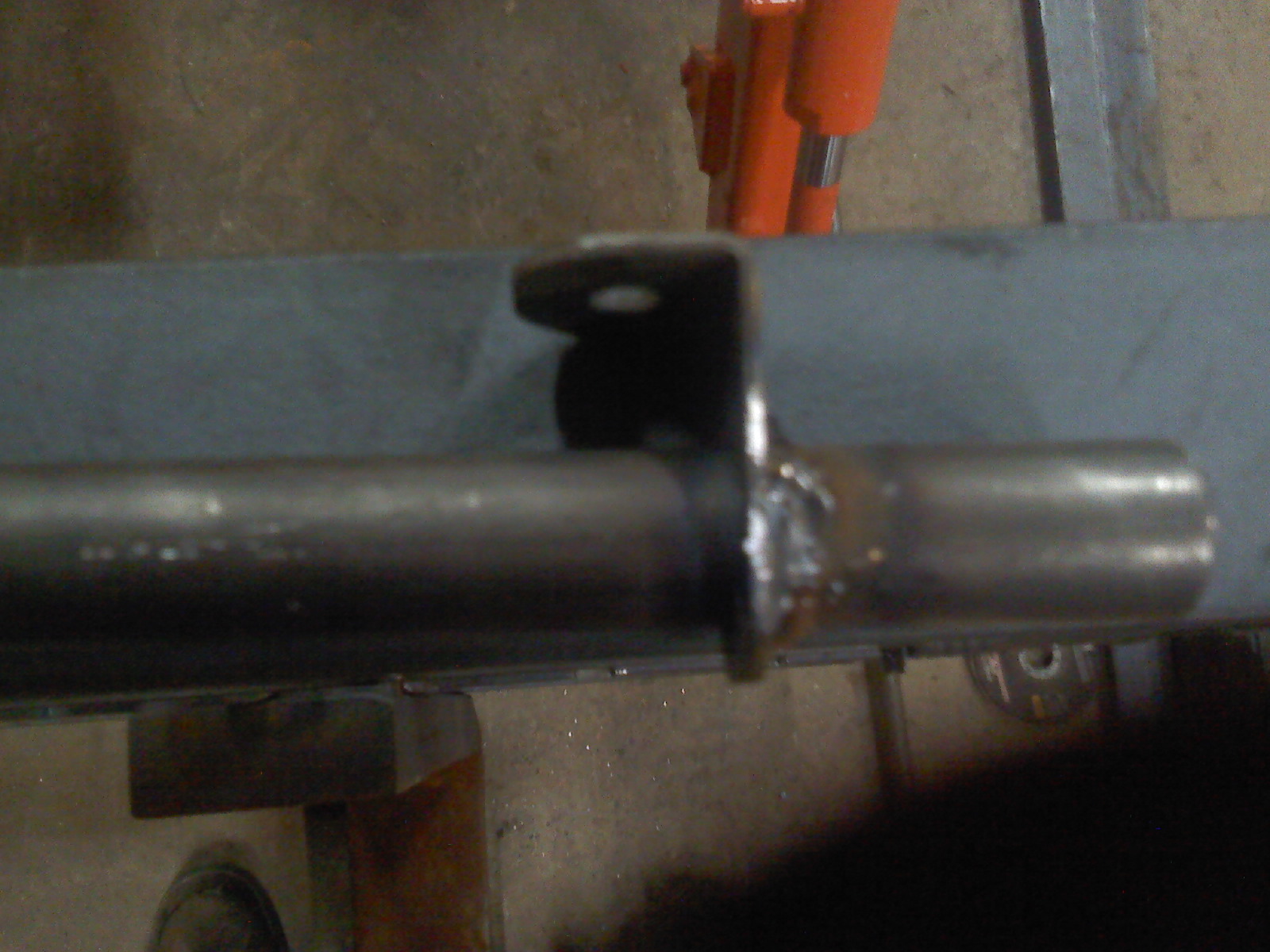

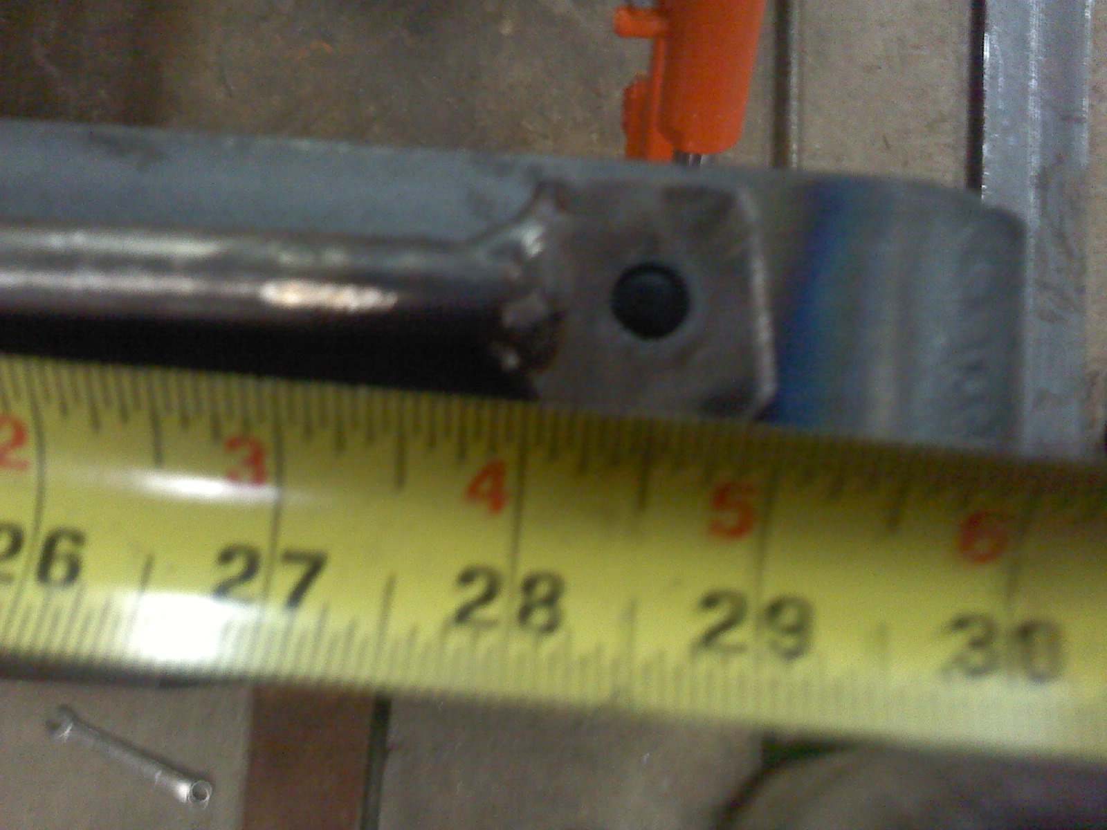

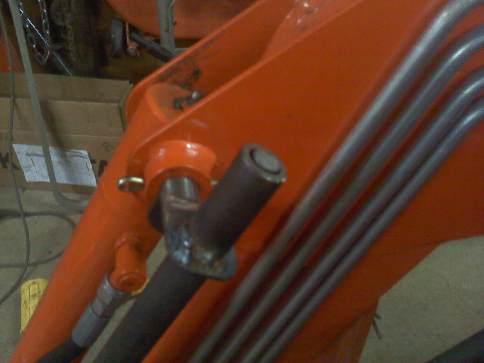

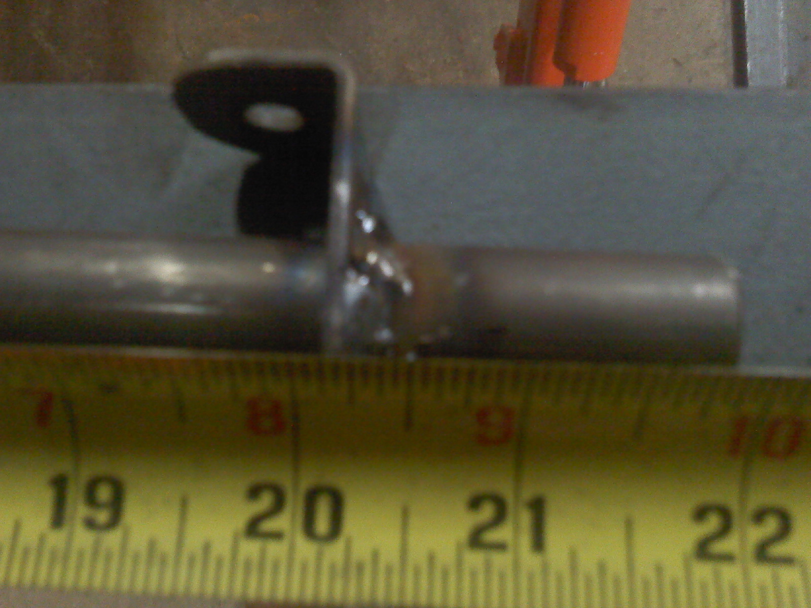

I started by making new pins for the curl cylinder to make them 1" longer then drilled the center and tapped it with 5/16x24x 5/8 deep. Made an "L" bracket out of .090 material at work with a 5/16 hole on one side and 3/4 hole on the other side. Then made a rod 7/16 dia. 28 1/2" long and welded a small lug on the end with a 5/16" hole and bolted it to the lower curl pin. Then I bolted the "L" bracket to the upper curl pin. Next I cut a piece of 1/2" i.d. tube 22" long slid the tube over the rod and into the "L" bracket, with the bucket level I matched the end of the tube to the end of the rod and welded it there. DONE! About 3 hrs. and I now have a level indicator that is usable!! Simple as that Kubota!!! Total cost is about $5.00!
When the rod is flush with the end of the tube the bucket is level!
I will get some paint on it as soon as it warms up enough.

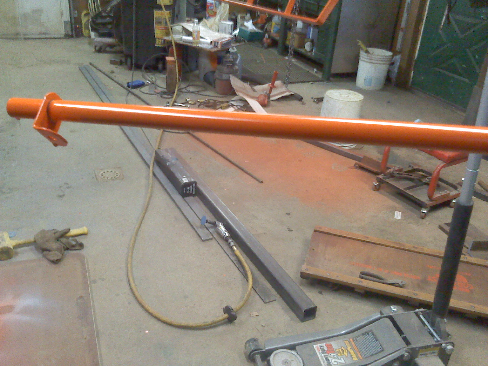

Thanks rickshaw, It really was that simple to make!
I took it off today and painted it. Hows it look now?

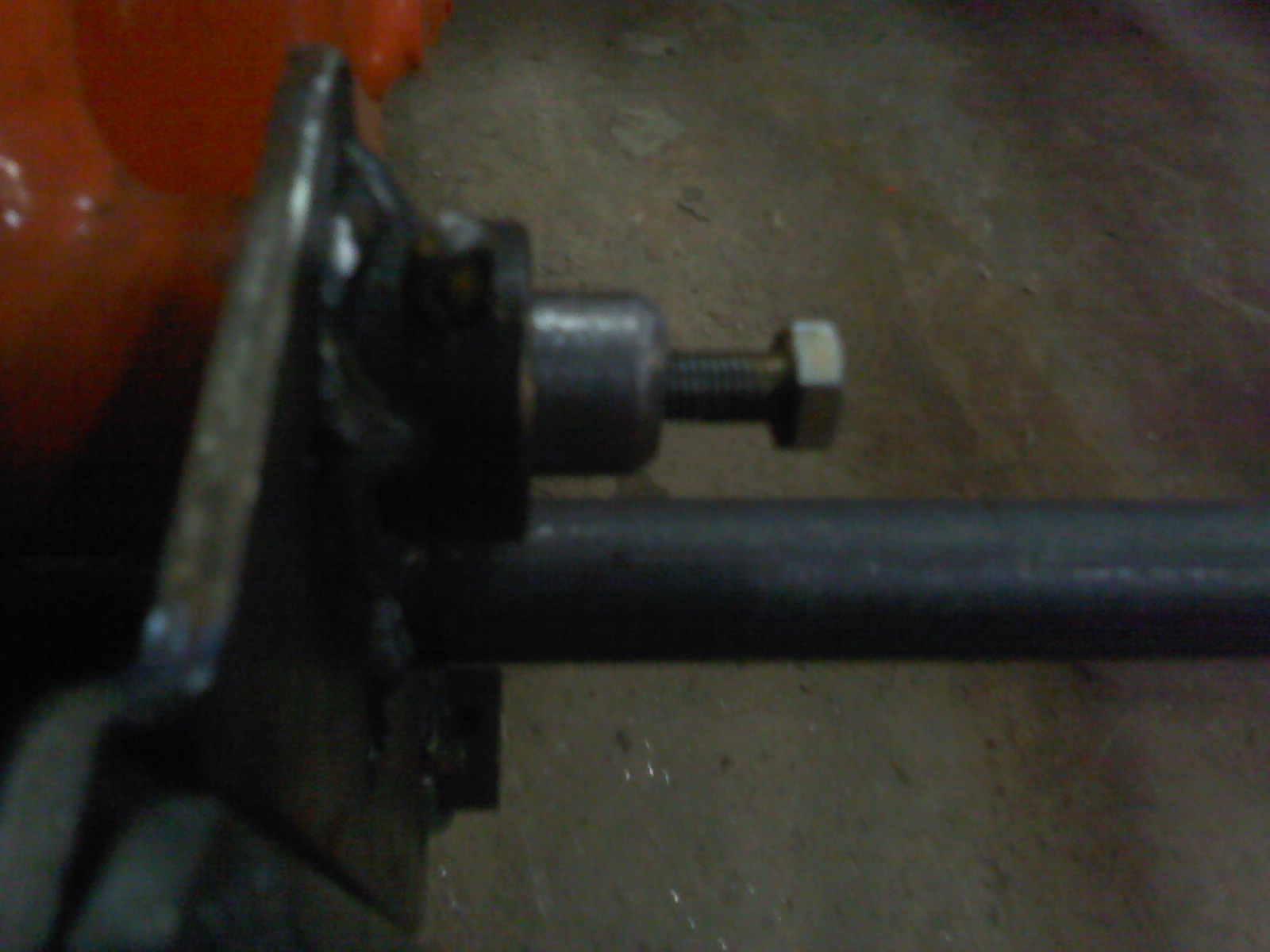

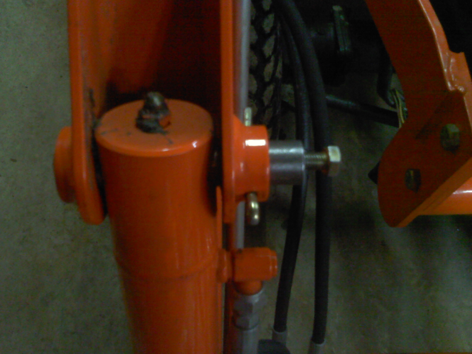

Thanks Guys, I thought about making them and selling them.......for just a second! :laughing: I will be making one for my buddy that let me copy his quick hitch though! :thumbsup:
Here's a couple more pics of it. I also shot the ends of the pins that will be sticking out.

Very nice job! I like how you mounted the tube to the upper pin. My JD uses brackets and hose clamps to the curl/dump cylinder. You way is much cleaner looking. Have you tried it out? any binding issues?
To save the cost of new pins, you could weld the head of a bolt to the oringinal pin. Use a spacer on the lower pin and make the "L" longer bracket to suit at the upper pin.
I would use 3/8 or 1/2 diameter bolts, length to suit and locking nuts.
/ LA302 BUCKET LEVEL INDICATOR
#9
Thanks Zebrafive, I have tried it out and it works perfectly! I drilled the holes shallow and bottomed out the bolts to lock them and left enough room so they didn't bind the indicator. My pins are just 3/4" so I figured 5/16 bolts would be fine. I didn't want to weld the bolt heads to the pins because I wanted to protect the threads for easy removal if needed. I had some 3/4" round bar on the shelf to make the longer pins so cost was minimal
