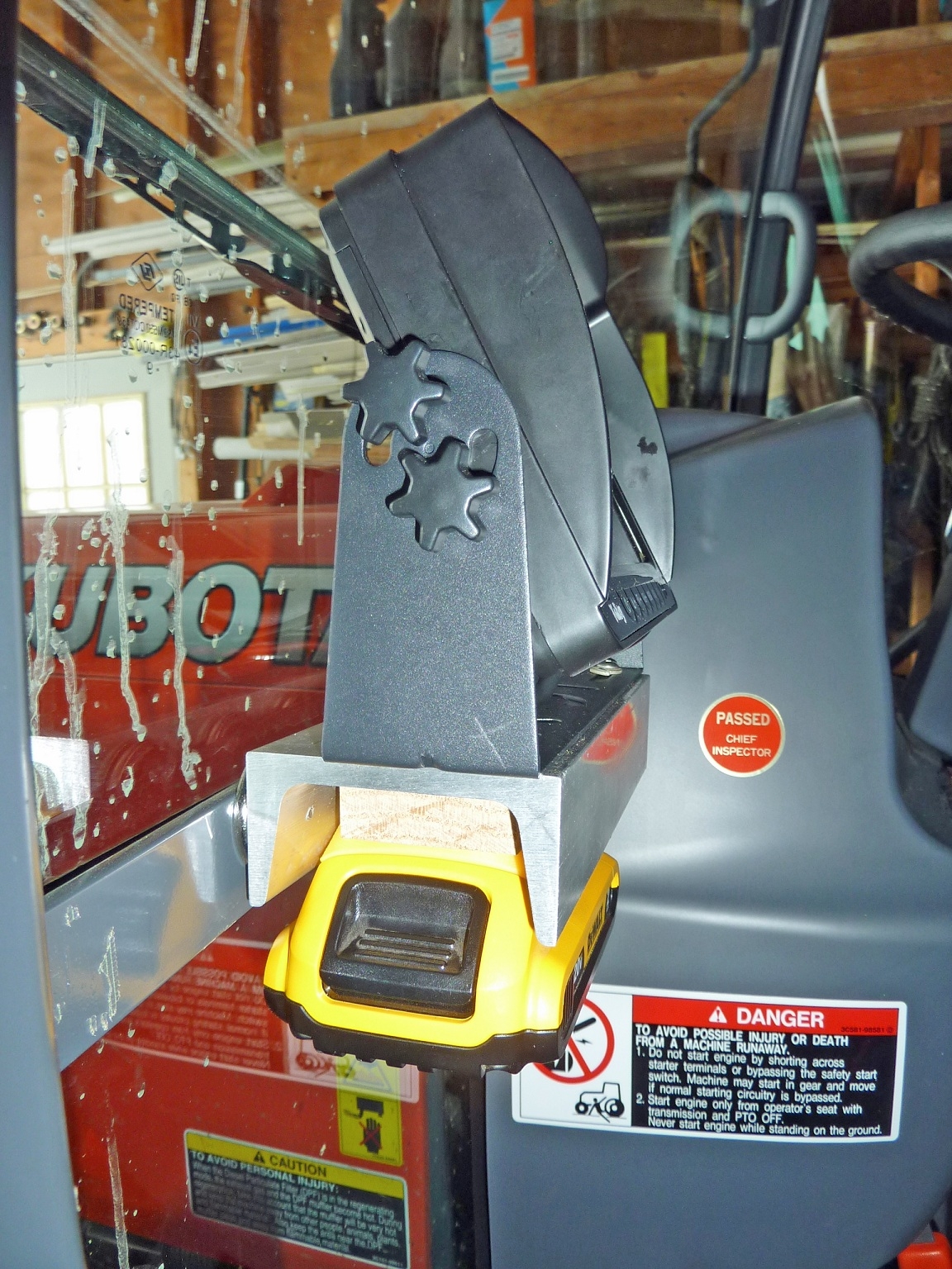

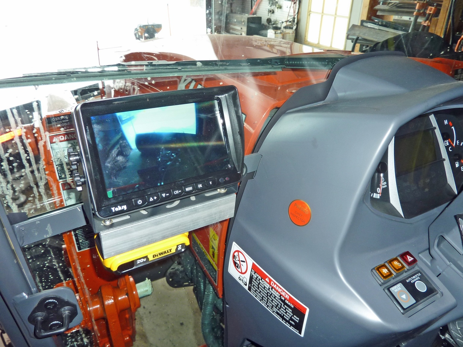

The M12 Milwaukee batteries with adapter should work fine to power both camera and monitor.
If you have a cab, there is usually a piece of iron a magnet will stick to:
Monitor mounting on open station tractors is more difficult and there are also sun glare issues.

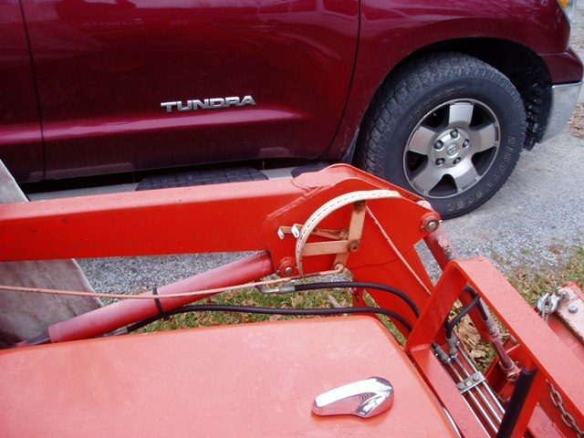

This right here. Thanks rscotty for the picture. Of all the other systems, how many can tell me when the bucket is level six feet off the ground and drop rocks on it and have it still work like a charm. Simple and effective.

Thanks, I found that simple flat bar on top of the bucket useful too. My hat's off to Kubota for doing it - and doubly so because they did it without any fanfare or even any explanation. For the longest time I wondered what those flats on top of the bucket were there for. I bet I'm not alone.
And anyone can easily add that feature to their FEL to better judge the angle of the bucket cutting edge. The downside to that simple solution is it still needs well-calibrated Mk II eyeballs to confirm how the level changes when the loader arms are moved. The better the eyeball, the better the leveling.
I am also greatly intrigued by Medonsy's setup back on message #11 - the one where he shows a curved gauge with dual pointers - one pointer showing bucket angle now, and the other pointer showing the angle the bucket will have if lowered at the ground.
That is a one very clever idea. .

I could not find any indicator that I liked so I built my own. The curved face is linked to the bucket and rotates as the bucket is tilted. There are two pointers to indicate position. The one closest to the curved face is linked to the loader frame and shows the current level condition of the bucket. The other one is fixed position to show where the loader will be when lowered to ground level.
The dimensions required to make it work accurately are a bit tricky and would be different for each loader so some experimenting is required.
