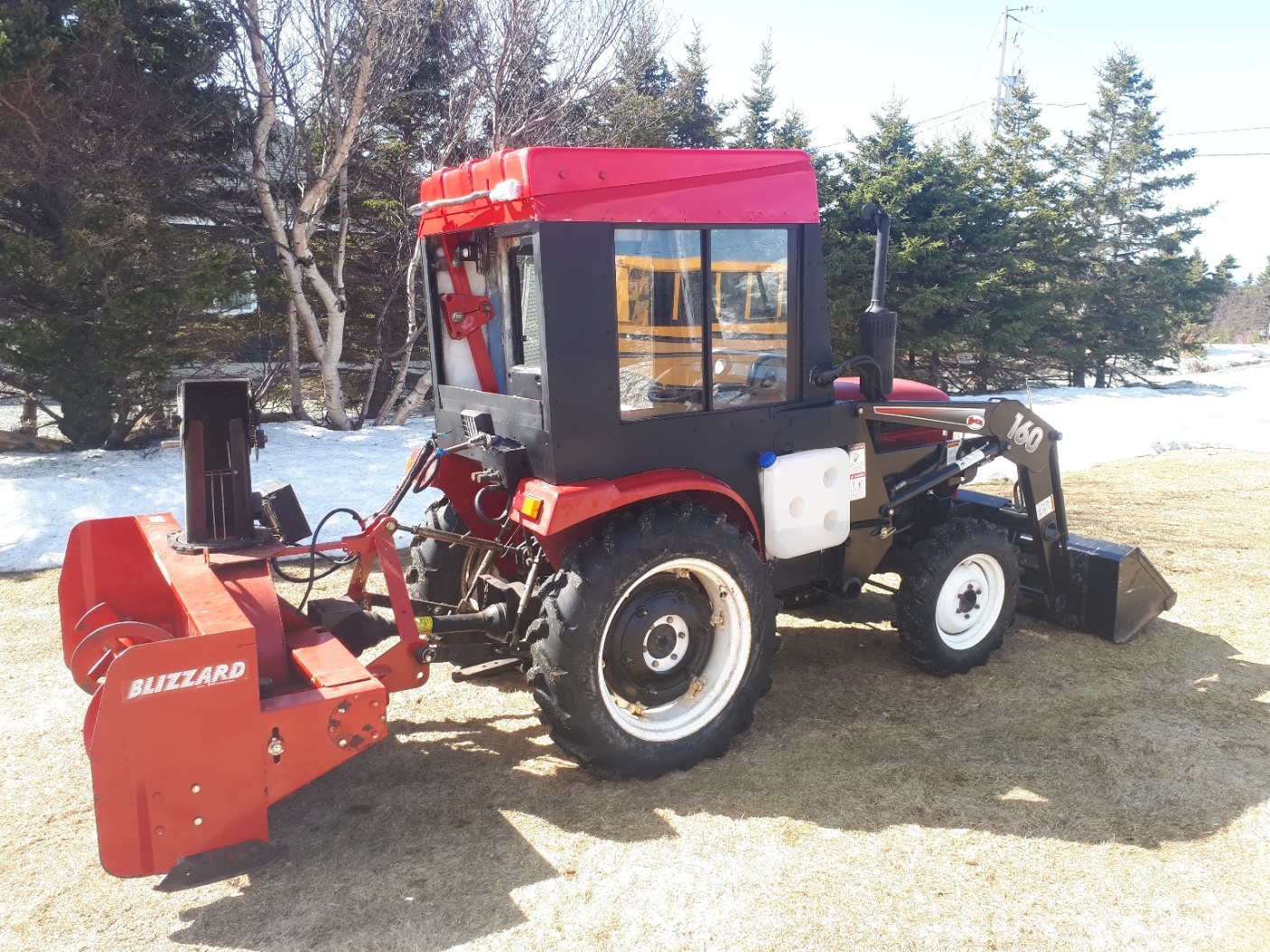

I picked up a Farm Pro 2425 a few years ago in need of repair that came with a rear snowblower attachment. I live on the east coast of Newfoundland, our winters consist of predominately wet snow fall with high winds. I liked the snowblower, but not the open cockpit!
I decided to attempt making a cab using some stock I had for the frame (much heaver than needed, but I already had it) then shaping metal I sourced from roof panels of a school bus, in cooperating the canopy already on the tractor. I used the sliding windows, also from the bus, for the sides & had a local auto glass guy make the windshields for the front & rear. Got a Chinese diesel heater in it and life is a lot more comfortable cleaning up the snow.
I saw some other posts here with versions of their diy cabs, hopefully my attempt will help with ideas for anyone thinking of doing the same.

Oh wow, you've got all the features in that cab minus a radio! That's one heck of a home built cab, extremely nice. That you've got that skill is awesome.

Thank you for that!
