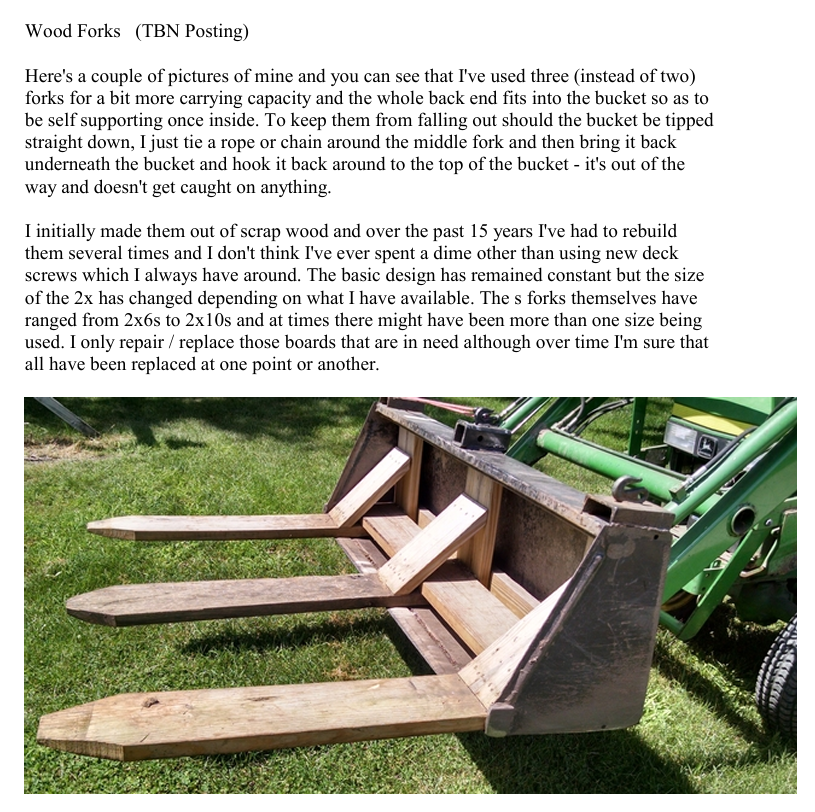

Off topic, but here's something that was on TBN about Poor Man's (light duty) debris forks.
