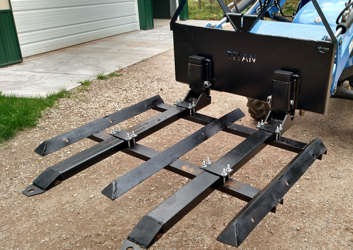

I had a couple of pieces of scrap angle iron and made bolt on Debris Forks.

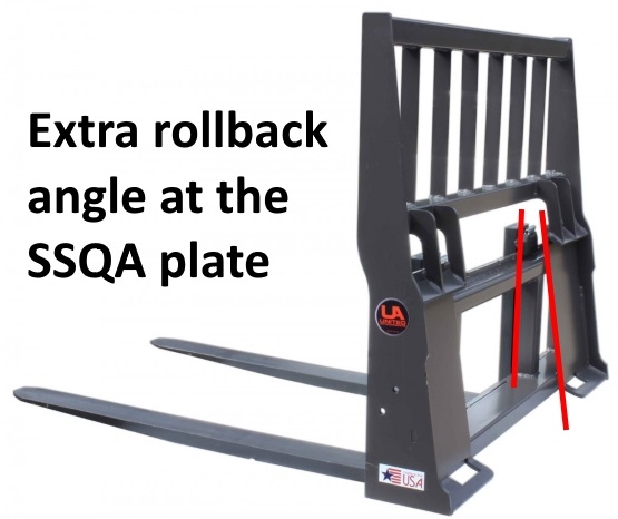

Every set of forks I have the back frame is 90 degrees to the bottom. There’s no real need for a bunch of rollback angle at ground level. I would also adjust it so the back frame doesn’t protrude under the bottom of the forks.
Rollback angle in the frame:
/ DIY SSQA forks? #37
Yep, they need a roll back angle if it is not included in the QA FEL side itself. Get it wrong and the curl suffers at either full lift or lowest position.
