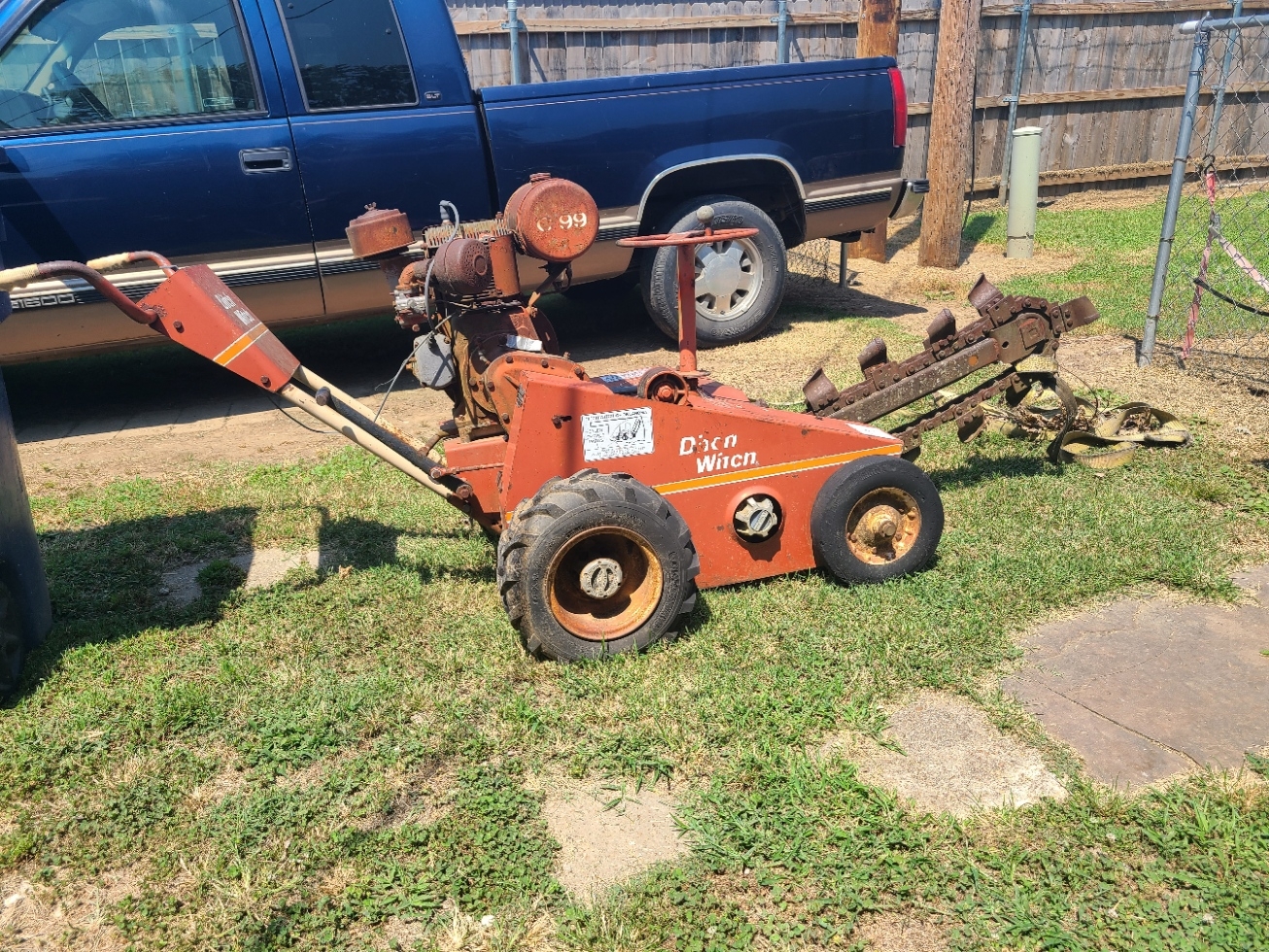

Thank you for the manuals. I really appreciate that. The C99 seems to be mostly all there but is pretty rough. The ignition switch and wiring is gone so I haven't been able to check for spark. Also the pull rope does not engage when I pull it so I haven't been able to check compression. Tires were flat and I aired them up. They seem to be holding air at least.

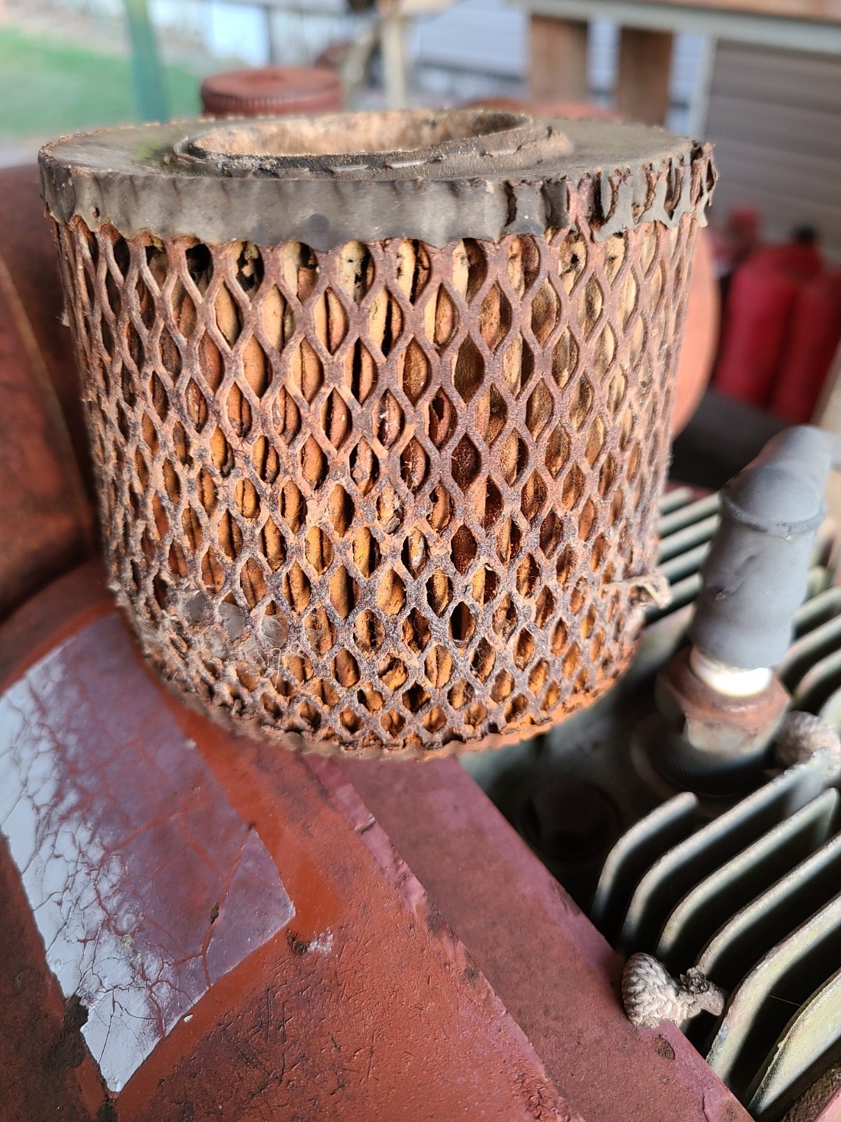

I am needing to get an air filter element for the Ditch Witch C99. The one I have is the round dry element filter and it is totally shot. Cant seem to find any place that sells them. I would appreciate any information.

Got some time to work on the ditch witch today. Found this setup for a recoil starter rope instead of a sheave type. Of course the flyweights are rusted and unmovable so have to clean and lube that. I put a socket on the crank bolt and was able to get it to turn, but only about a quarter turn. Can turn it back and forth easily but only about that quarter turn. After that quarter turn in either direction it stops hard. I have the sparkplug out so nothing is compressing. Does anyone have any ideas about what is stopping the crank turning?

I got the Wisconsin engine on the C99 to free up today. It is making full revolutions now. I adjusted the planetary gear selector and it freed up after that. So i guess that was engaged to the engine and stopping it from turning.

I got the recoil starter rope cleaned and lubricated so that the fly weights would engage the crank again. It works but not well really. The weights only engage after the rope is pulled fast enough (about half way out). Then you only have about half the rope left to start the crank turning. I may need to convert it to just a sheave setup. I guess the crank not turning completely was because of the reducer gearset. I adjusted the lever and was able to get the crank turning complete revolutions. I got a look at the magneto today ...it was pretty crusty. I sanded the points and tried to get a spark with a spark plug tester light but it was no good. Time for a magneto rebuild I'm guessing. I got the carb off and dunked it in a can of carb cleaner for overnight.
