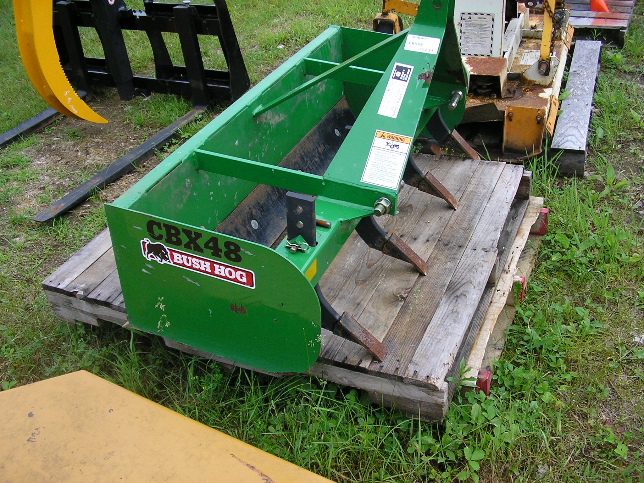

It weighs 250 lbs. I think it's a bit lighter than other 48" BBs I've looked at. But the price is right. They will even deliver it for the $350. Not a bad deal.
That's not bad at all. I looked at my "Kubota-branded" ballast box today and the label on it reads that for B-series tractors, it should weight in at 500#, and for BX-series tractors, it should be at 300#.
Most of us seem to find that going over the ballast recommendations is preferable to under, so adding either a HF QH, which adds another 61#, and makes hooking up implements (as long as they fit the industry standard for Cat 1 hitch dimensions) dramatically easier (for approx $70-80 using the ubiquitous HF 20% coupon on sale).
The more expensive route is to add any other three-point adapter to make implement swapping easier (Pat's EZ hitch, JD or other QH (IMHO more money, but no > quality), or Stabilworks pin-adjusted 3-point stabilizers (and since only the QH's add any real weight), add some more more weight to the BB.
BTW, I, for one, second JohnThomas' post wholeheartedly!
