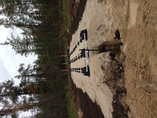

I have a slightly larger machine (B2620) with a backhoe and for what I was doing the bucket was WAY faster than using the backhoe.
It was a septic field install. Of course I used the backhoe to dig the hole for the tank but for the field I dug a 2000 square foot hole 12" deep with the bucket.
Once I had the leading edge of the field dug I simply used the bucket in a vertical position to shave off the edge then tilted bucket horizontal and scoped up the cutting.
In total I have moved 320 yards of material (almost 2,000 bucket loads!!) Would have loved a bigger machine but "I danced with what I brought" as the old saving goes and the B2620 different let me down 1 bit!!!
So this little machines are definitely slower than the full size machine BUT still very capable and a lot of fun as long as you are not in a rush.
sorry for upside down pics but have no clue on how to flip.
