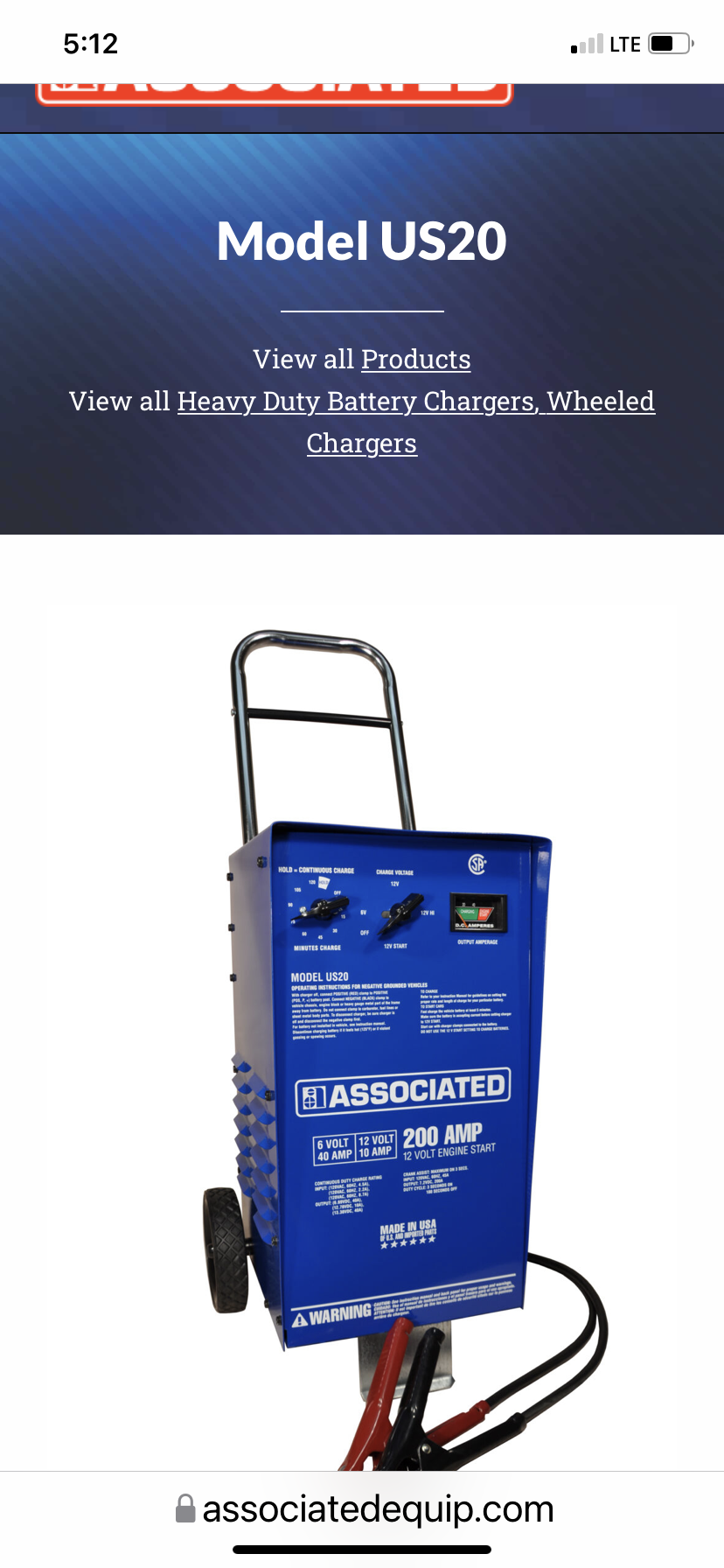

My Kubota’s only a couple/few years old and already a dead battery, by chance my ranger battery is on it’s last leg, my riding lawnmower battery is kaput and I have a stack of other dead batteries.
This guy
claims that this charger will fix any and all dead and depleted batteries and he has over 6000 comments supporting his statement.
( didn’t read all 6000 but didn’t see anything contradictory)
Charger is over 300 bucks…….. I don’t believe that 6000 viewers of his video has a 300 plus dollar charger so what do you guys think?

Scam. No battery charger can "fix" a battery. A battery that is still fairly new can be revived to an extent but not to "new" specs. A battery that is beyond its life span and truly dead cannot be revived. If that were so, somebody would be buying up old batteries and "reviving" them to sell again.
If you have equipment that is not used every day then you need to invest in battery maintainers that will keep the battery topped off and in top condition. I bet I have at least a dozen of them...on both tractors, on my motorcycle, and everything else I don't use daily. Since I started using them my batteries last 2X what they used to.

I have a battery maintainer on all my seldom used equipment. Yes - it keeps the batteries topped up and they DO last longer.
What 1930 has found is obviously a scam. And a pretty expensive one at that.

They appear to want it to look like a big shop charger, but it's only a 10 amp "dumb" charger. 10x (at least) more expensive than a comparable 10a charger.

Ok, so a new battery is pretty expensive. If this actually worked, the charger could pay for itself very quickly. Plus there may be an advantage of having a heavy duty "starter" charger.
Not all dead batteries are the same. If there is significant swelling of the battery case, that is a sign that the battery is pretty well toasted.
Sometimes a battery will come back to life for me, sometimes it won't. Frequently if I recover a badly discharged battery, it will work for a while but never be quite up to snuff.
What I haven't done is that 15 minutes on cycling. I usually end up trying a high power, then forgetting it and letting the battery cook... and thus kill it.
Anyway, it isn't the worst thing in the world to try... if one just has ordinary dead batteries, perhaps with one dead cell.
