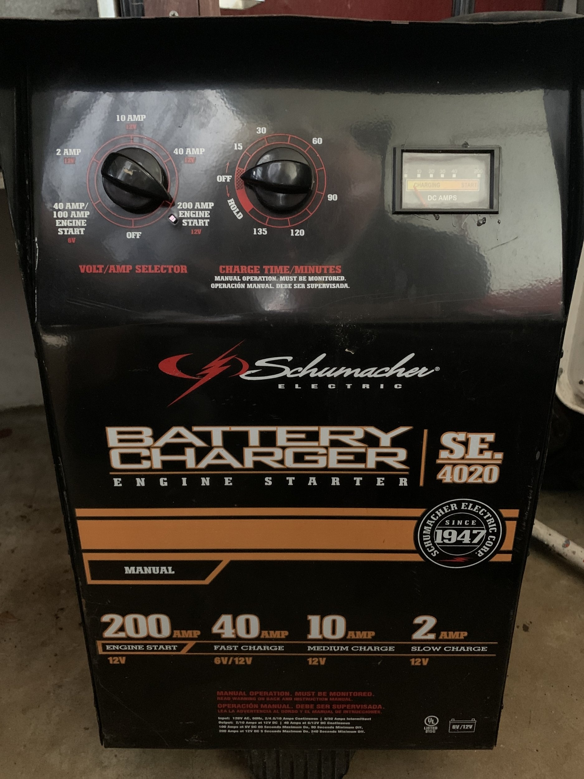

I’m trying it now, turns out I had a charger with the 200 amp setting.
Buried and didn’t know I had it.
The battery I’m trying it in was seemingly dry when I took the caps off.
I filled it to just below the proper level and hooked up charger.
The water immediately started bubbling and coming out over the top.
I wont fill the next one as much.
My cables are getting warm, I’ve turned it down to the 40 amp setting, the battery is still bubbling/boiling but I feel more comfortable.
Big numbers difference between 40 amp and 200 amp but maybe if it’s still boiling at 40 amp it means it’s still working?
Anyway I’d rather do it a few more times at 40 amp and not burn up anything if at all possible.
I started out at a 12.68 reading on my multi meter before I started, not sure why at over 12 volts it wouldn’t even hardly make the lights come on for my Kubota?
Anyway will keep you posted
You’re not putting current into your battery at a 200 amp rate. Your charger probably has a 200 A on it for advertising peak current when using it to start an engine. Most likely your charger is rated 10 amps and is outputting less than that when charging your battery, especially since you measured 12.68 volts

Charger

200 amps is what could theoretically flow into a starter motor with almost a short circuit resistance. 14-15 charger volts on a 12 volt battery is only a potential 2-3 volt differential. It won’t flow 200 amps. Trust me

Remember, one can get a battery to read 12v(+) but that don't mean it's good. The real test is a load test. Have run across batteries that would have good voltage but no "strength" (amps) for starting equipment.

I was taught to NEVER add acid to a battery once the initial filling was completed. Probably the danger from hydrogen gas is the reason--a very good reason. Batteries are expensive, but a new shop and a stay in the hospital are "expensiver."

From what I understand, after having read it and from experience, is that a low charge (1-2 A) over a longer period is the best way to try to recover a "dead" battery. Once/if the battery shows signs of taking a charge the amps can be upped.
With smart chargers/maintainers it's often possible to trick them into working by connecting a good battery to the "dead" one for maybe half an hour, or until the smart charger will recognize the "dead" one.
Either way, quality maintainers definitely help batteries live, as do good solar chargers, and anything with desulfation really helps.
Having about 80 batteries to tend to, I have learned a bit about what works and what doesn't. A disconnect on the negative side, for example, does help.

To me and dead battery is a dead battery, IF is does not come back to life in a 12 hour charge from old school 6 amp charger, it really dead....
Didn't see it emphasized -
I've read that most of the recent chargers sold are "smart" chargers. They require some minimum charge.
If a battery WON'T kick off a modern charger (usually has "smart" features I try my old (pre2000) Schumacher, that sometimes gets a little juice into it and it then will take a charge. But the battery is on it's last legs at that point.
