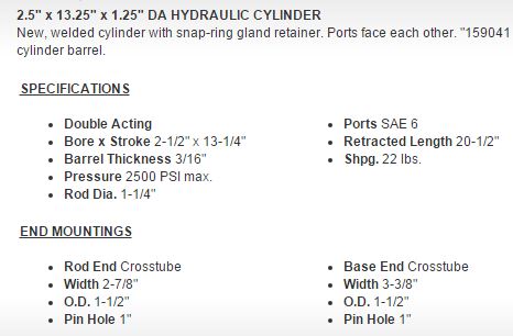

You're correct. My max pressure is 1991 PSI per Kubota WSM.
Sounds like I gotta nail the retracted length @ 20 1/2" for sure - no compromises. I could get there with the original 12" stroke cylinder that I was looking at by hacking both ends off and converting to 1" DOM and adding a 1/2 spacer on the cylinder end. That would get me to an "effective" extended length of 12 1/2" vs. the 13" extended length of the mechanical linkage. Any of the longer stroke cylinders that I looked at from Bailey's have a retracted length that's too long.
The good news is that my existing thumb linkage is linear; Channel that slides within another channel. So it mimics the operation of a cylinder and makes taking measurements pretty simple.
I'll search on on here for other sources of cylinders. Suggestions welcome! I imagine a true custom cylinder will cost an arm and a leg.

While I agree with dfkrug, 1" is better than 3/4", Bolts and pins in shear are incredibly strong. A 3/4" Grade 8 bolt is over 40,000 pounds. Of course this is measuring pure shear, not the fasteners ability to span a gap and resist flexing. This is why, when you inspect a piece of hydraulic equipment, the gaps or spaces between cylinder clevis and their mounts will be minimal, typically a thick boss or bushing will be welded to the structure and will mate up to the cylinder clevis with 1/8" or similar gap.
On my B3350 tractor, the WSM says 2450 psi for the relief valve setting. Backhoe may be less, haven't checked, but the machinery operating pressure will be whatever the relief valve with the lowest bypass setting in the circuit is. BTW, it seems small tractors often have their hydraulic relief valves set low for some reason, and more power can be had by adjusting them to spec.
If you have the machinery to cut and weld, then starting with a cylinder that is too long, it's possible to custom make whatever length you need, within reason. Best to take the cylinder apart, before cutting and welding, but not required. If the cylinder needs to be shortened, the ram can be extended and the cylinder end cut off, shortened and re-welded. Wrap the barrel with wet rags and extend the ram fully to weld it back together without disassembly. Same idea for shortening the piston rod end, or welding in a spacer between cylinder and mounting clevis to lengthen the retracted dimension.

Update: I may have stumbled on a cylinder that will work with only minor trimming (3/16") to the base cross tube:dance1:
20.5" retracted length, 1" pins, and 13.25" stroke. Any reason NOT to consider a 2500 psi cylinder when my relief valve is supposed to be < 2000psi? The hoe cylinders are 3000 psi. I guess the only issue would be if I ever sell the hoe I gotta tell the next guy that it's only a 2500 psi cylinder if he's putting it on a strong tractor

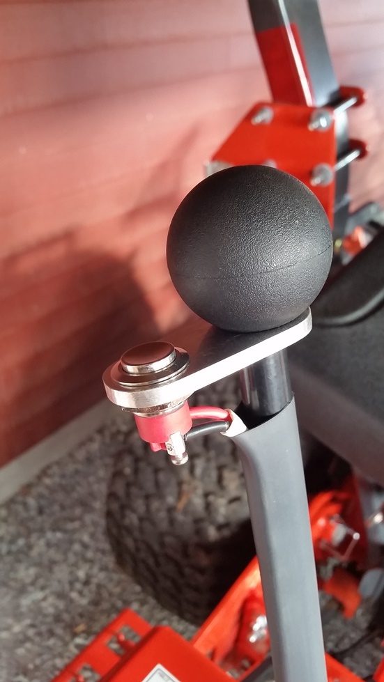

The hydraulic thumb on my Woods BH75 is complete and in-service! Could not have done it without the outstanding advice from this thread - especially DFKrug and Bumperm. The key was stumbling on a cylinder at Surplus Center that had the right 2.5" bore and exact same retracted length as the existing mechanical linkage. The stroke gave me 1/2" additional extended length than the mechanical linkage, but that didn't hurt me at all. Fairly minor fab which I did myself included the valve mounting plate on the dipper, cutting off and re-orienting the base cross tube on the thumb cylinder to get my ports on the side, cutting DOM spacers for the thumb pin/rod crosstube, and the little aluminum bracket for the valve switch. I'm into it for $325, not including my time or consumables, or replacing a sneaker that I got a bunch of Kubota Orange II overspray on.
Thumb Switch.jpgDipper Lever.jpgThumb Valve Right.jpgThumb Valve Left.jpgThumb Pin Shot.jpgThumb Cylinder Hardline.jpgHydro Thumb Extended.jpgHydro Thumb Retracted.jpg
I'm not really happy with the switch install. While perfectly functional, it still looks unfinished. Open to suggestions. The machine tools I used to make the bracket include a drill press, belt sander, Milwaukee Porta-Band, and a Dremel, so I'm pretty limited on what I can do.
One really dumb thing I did was cut the wires that tee off to go up to the switch too short. Only discovered it after I was completely done and testing the wire and hose routing for pinching over the full range of motion of the hoe. When the dipper and boom are fully extended (reaching as far away from the machine as I can with the bucket teeth), the wire up to the switch is uncomfortably strained. If I'm reaching down digging a hole I'll have a problem with that wire. So that's on the list to fix. Also gotta get some dielectric grease on the valve spade connectors. And get some hours on 'er to get all the air worked out. I'm shocked that I have no apparent leaks at any of the fittings, including the hardline compression fittings. I'm hoping that if I don't have any on start-up that I won't have any later (unless I whack something).
Do you guys think the hardline will hold up without being anchored/braced at the base end of my cylinder?

Awesome job. Looks very cool.
Would you be so kind to post the parts list you had to buy to make it?
Also, for the switch I think the control knob is hollow as well as the control tube. You could run the wire inside of the hollow rod and just drill the knob to accept a round momentary switch to work the diverter.

Very nicely done! I especially like the solenoid valve mount, clean and out of the way. I may have to modify mine again - thanks a lot:ashamed:
I had my switch mounted like yours originally. Worked, but not so ergonomic. My current mount is a lot better - I like it a lot! Angled off to the side it's much easier and more comfortable to use, with my original one, like yours, I'd end up pushing the button with the side of my finger, clumsy.
I drilled out a length of Delrin rod, drilled and tapped the end for a set screw, then cross drilled at an angle to slide onto the joy stick arm. The switch threads, no nut, is a push press fit in. Wires pulled through as switch is installed. Quick and easy as with this sort of thing you kind of don't know how well it'll work until you try it.

Bumper - ya, in addition to not looking finished and being exposed, the ergos on my switch mount kinda suck. Initially I thought it would be good; just depress with middle finger and go to town, but the bracket is too close to the top of the knob. Amazon is my go-to for all purchases these days, and they have a one-foot hunk of black Delrin for $14. McMaster has it for $5/foot + shipping. I may do that, but I'm going to give it a day or two and prowl the aisles of my local dealer and Home Depot or Lowes. It occurs to me that I can use just about any kind of plastic as long as it's reasonably hard and machinable. Maybe I can come up with a Kubota branded screwdriver that I can cannibalize a handle from. Might be just the finishing touch I'm looking for. Thanks for the idea!
/ Custom hydraulic backhoe thumb #157
Have you thought about going to a foot switch for the thumb? You could also replace the know with a trigger style setup like in picture. You may can find one from an old bobcat that has the switch for 4:1 bucket. I really like the thumb you done great my friend.

I made my own switch knob. I got the knob from O'reilly Auto Parts and the switch from Radio Shack.3-3-12 $23.60 in knob, switches, and hinges.jpg3-11-12 Knob switch & harness with Valve.jpg3-8-12 Switch Harness.jpg Works great with my thumb. It is on my loader joystick, but you can buy 8 ball knobs with the switch on the side online. I have about $20 in making mine. 8 balls go for around $50 online.
