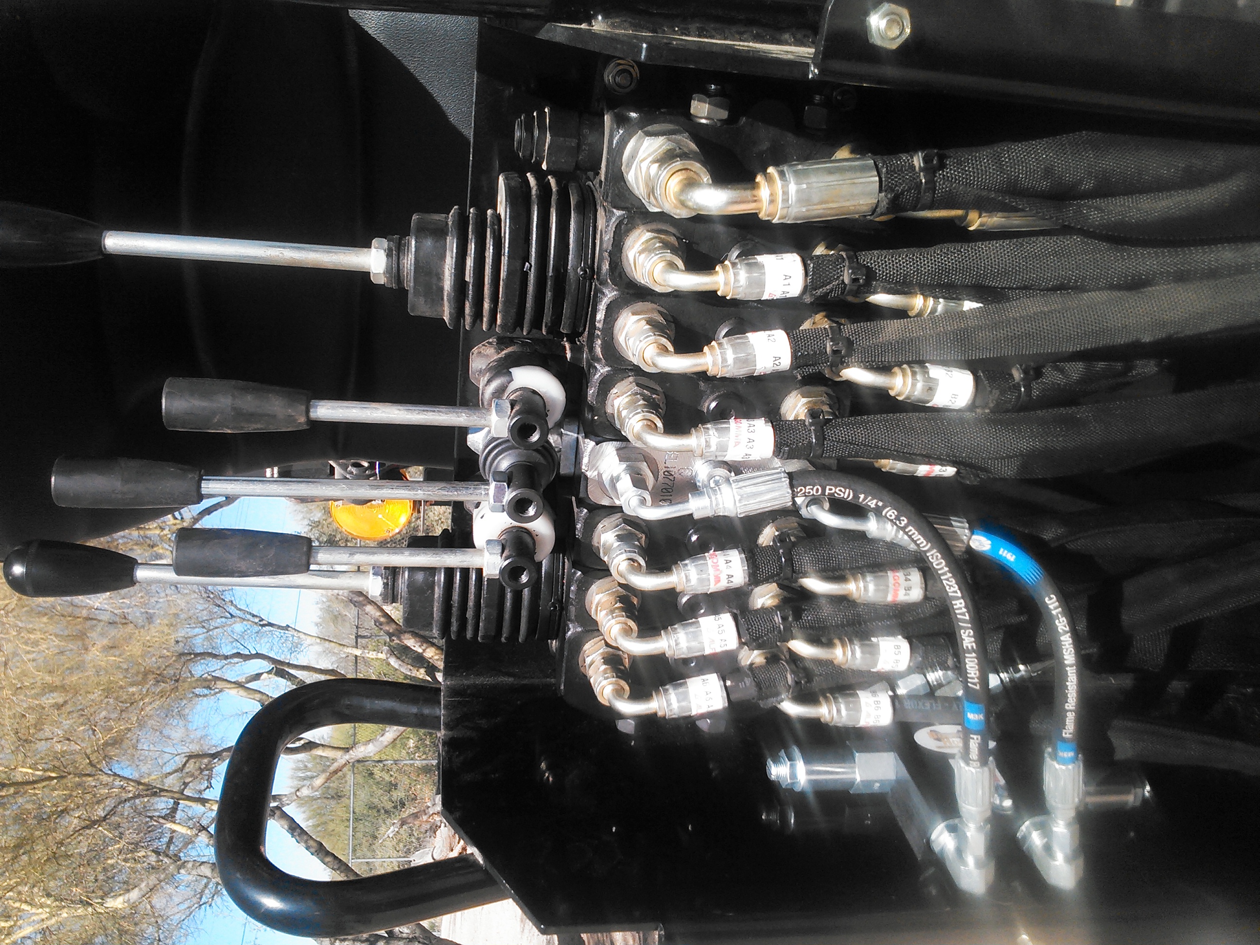

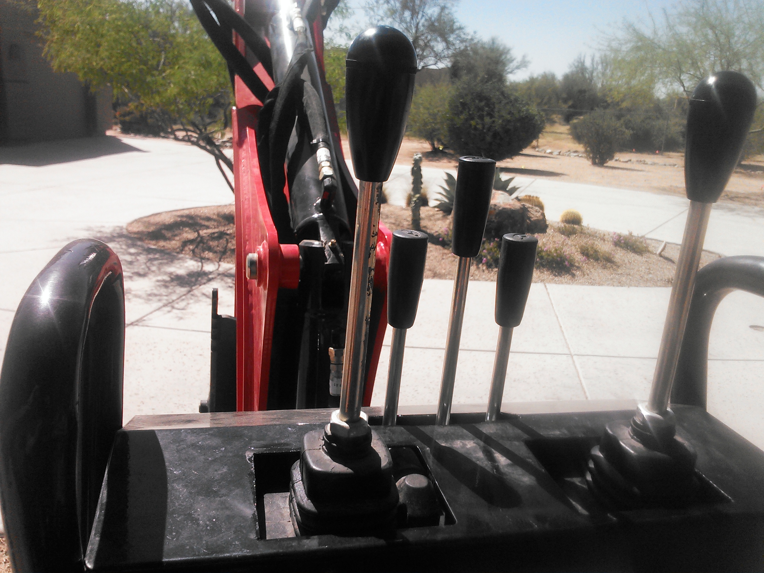

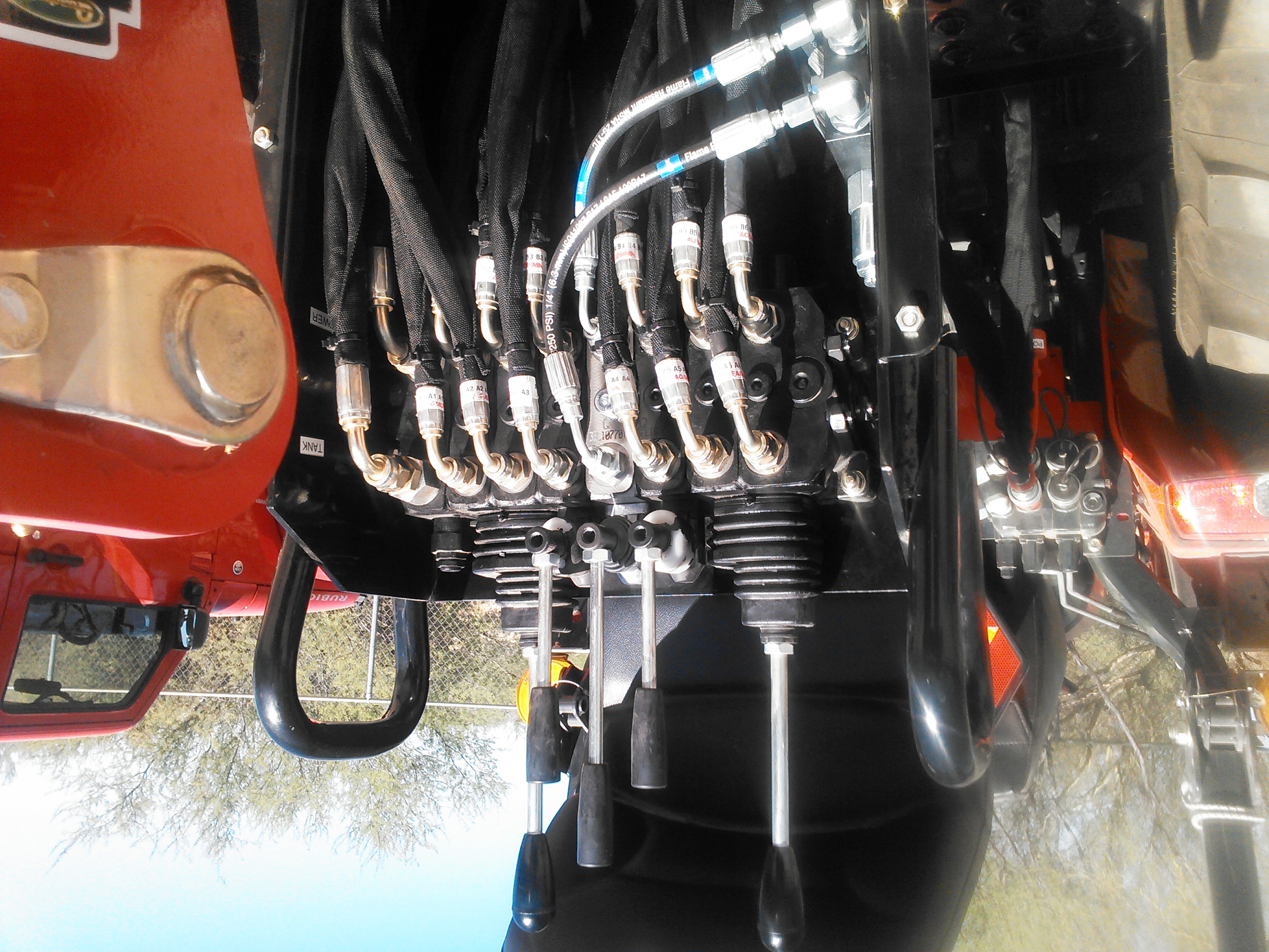

Aquamoose. I finally finished my hydraulic thumb conversion. I added another stablizer valve betwween the two stablizer valves. Part description: SDS100/7/Q-101-8L, Working section "Q" style w/o Rings Cyl. Spool Spring Center. Price was $224.37 from Hydraulic Controls Inc. Phoenix, Az.
The cylinder I used was from Bailey Hydraulics. 2" Bore x 10" stroke x 1.25 rod. This folds back the thumb to the right place without hitting the cylinder. SKU #207384. This cylinder allows you to rotate the ports 90 degrees from each other which helped with the install. Price was $175.00.
I also installed a double relief valve under the controls stack on the side to be on the safe side. Boltonhooks.com price $100.
The mechanical thumb just didn't work for me. I'm probably into this beween $650 and $700 when fittings and hoses are added in. You have to trim the sheet metal cover a bit to acomodate the wider valve stack and drill new mounting holes 3/4" wider on each side of existing holes. You also have to get 1 1/2" longer bolts to hold the stack together because of the valve you add in the middle being 1 1/2" thick.
All and all I think it was worth it, it is just like an excavator now. This was done on an Ansung BH65 which is one of the brands Branson uses for their backhoes.
If I ever figure out the picture loading on my Samsung Note Pro I'll load some for you.

/ Custom hydraulic backhoe thumb #208
Excavators have electric solenoid operated valves. To operate this backhoe thumb I installed a valve just like the stabilizer valves between the two stabilizer valves. I t makes the stack one valve longer, 1 1/2", which requires three new bolts to hold them all together and some sheet metal modification. It is just one more open center valve in the stack. I installed a handle that is two inches taller than the stabilizer handles right in the middle of all the handles. It is easy to operate with either hand and it is always available. No diverter solenoids, just another valve.

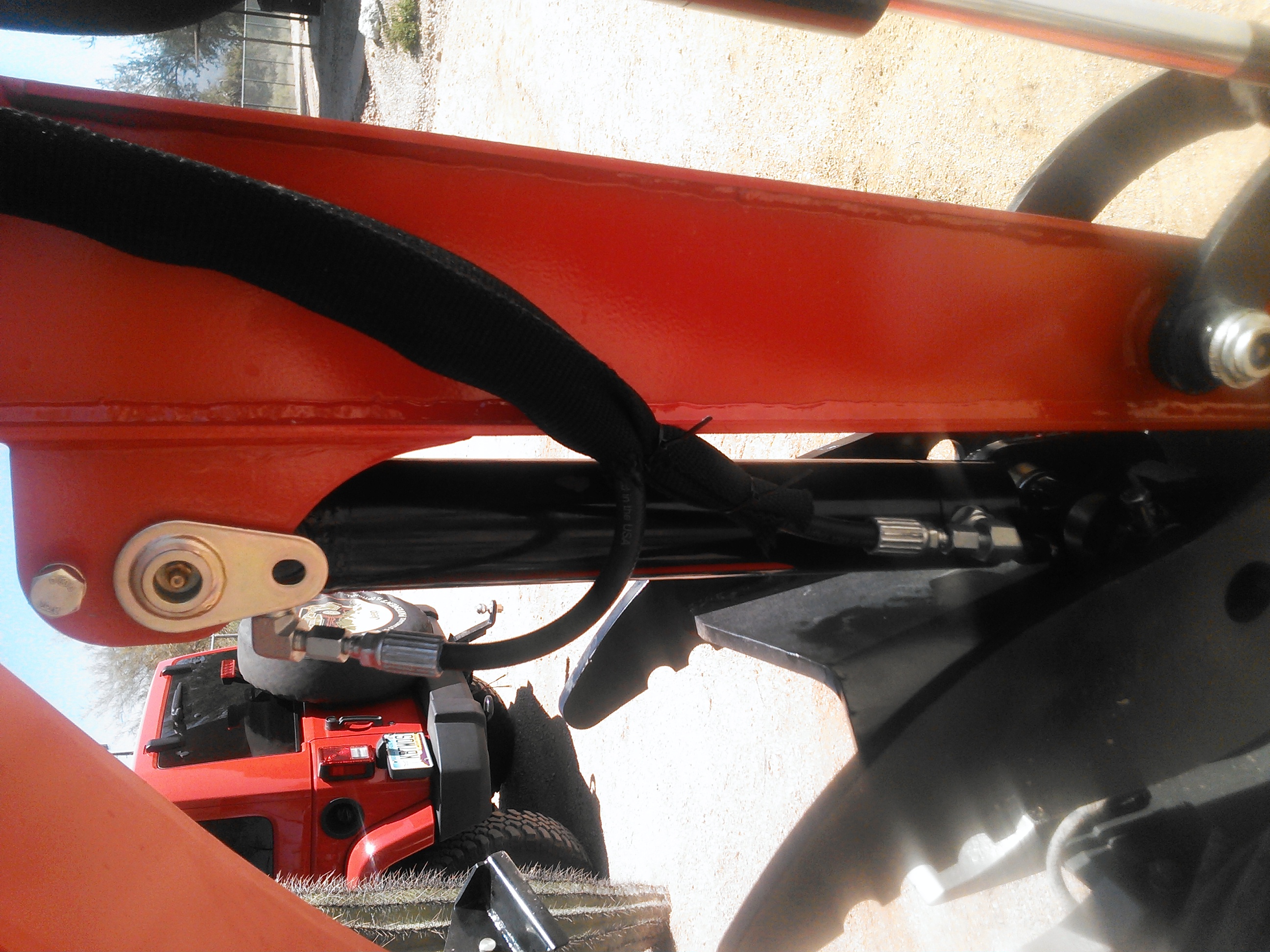

Here's a few pictures NCM_0219.jpgNCM_0217.jpgNCM_0216.jpgNCM_0218.jpgNCM_0220.jpg. Maybe.
/ Custom hydraulic backhoe thumb #211
Wow! Did have to cut the panels to make them fit and drill new holes to keep the valves centered?
/ Custom hydraulic backhoe thumb #212
Yes it did require using a cut off wheel on small Makita grinder and drilling four new mountng holes to keep things centered. Hardest part was working with Walvoil to get the correct valve. So many choices when it comes to hydraulics. Hydraulic Controls in Phoenix was a big help in ordering the correct valve. I used the same cylinder that Bumperm suggested. I first thought about doing this a year ago. Just now finished it up.

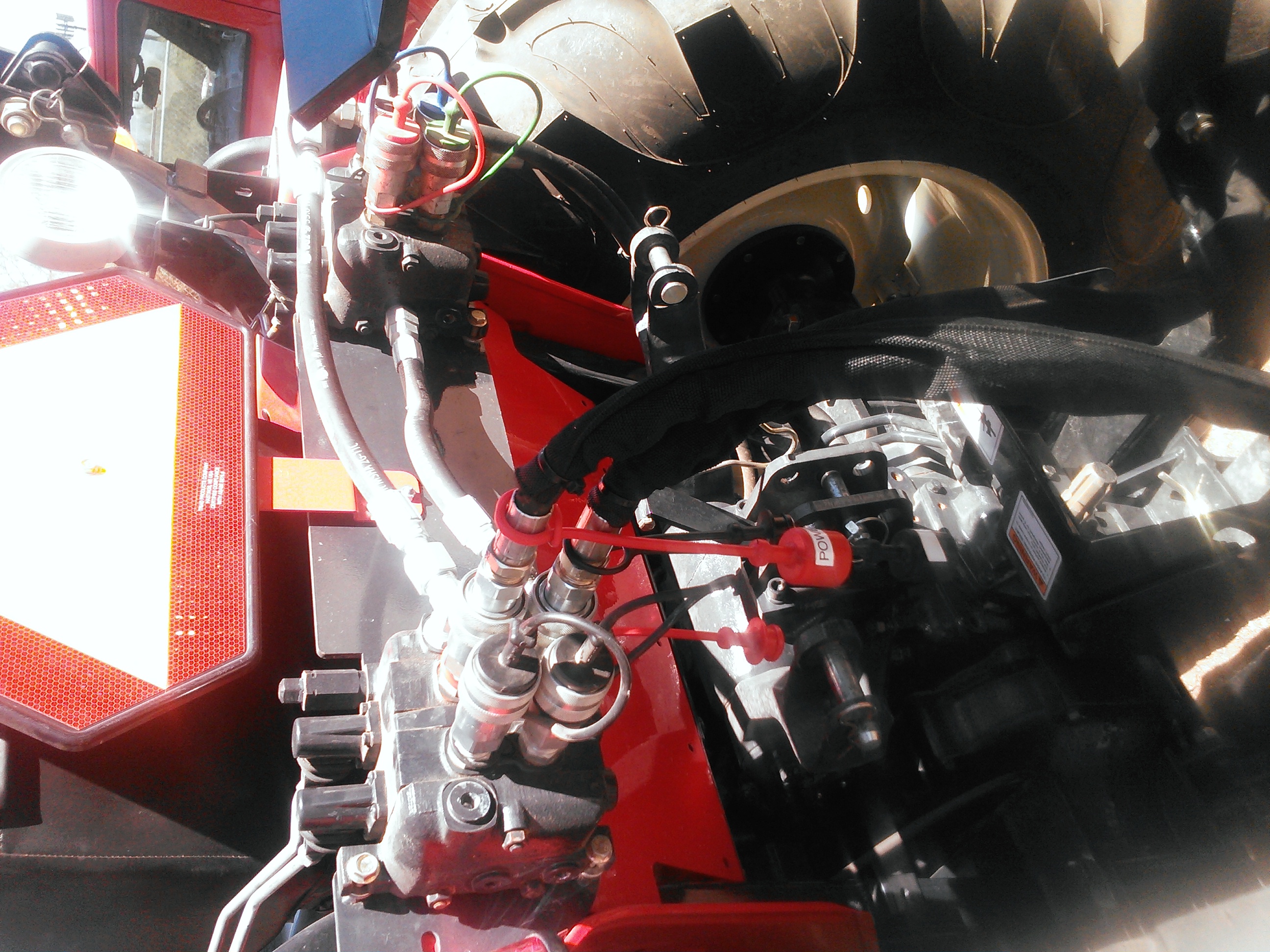

Amazing work. Did you get the chance to operate it? What tractor do you have? What's the last picture of? I see rear remotes, on both sides?

I've picked up a few big landscape rocks and it worked like it should. I have a Branson 4020R that I bought in 2012 to clear land in Oregon. I got the backhoe for it about a year and a half ago to build retaining walls and excavate for a detached garage. "Still working on getting a permit for that"!
The last picture shows the rear remotes which must be different than yours. I bought one single on the right, new with the tractor. Then I decided to add top and tilt. Easy, I'll just move the single to the left side and add a new double valve on the right for the top and tilt. Wait, as long as I am moving the single to the left side where the mounting holes can accept either a single or double valve I might as well make it into a double valve. I ordered the parts to add another valve to my existing single to make it a double as well. Sort of like a snowball rolling down a hill, I just hope that I have reached the bottom. You could connect the two valves with solid lines if you are good. I chose to use flexible lines because it was easier for me. The valves and mounting plate are how Branson did rear remotes in 2012.
The backhoe is plugged in on the left side in the last picture. I just hold the lever open with a bungee cord when useing the backhoe. This seems to have no affect on the use of the loader when the rear remote is open. Because loader and backhoe are both Ansung they are made to fit together. The subrame of the backhoe attaches to a solid round tube of the loader subframe in front, and to the lower three point hitch arm brackets on the axels in the rear.
Removing backhoe only requires pulling two pins in front, supporting on stablizers, unplug hydraulics and drive away. Takes as long to put three point hich assembly back on as it does to remove backhoe. I have since built a dolley to unload it on which actually makes it easier to reattach.
