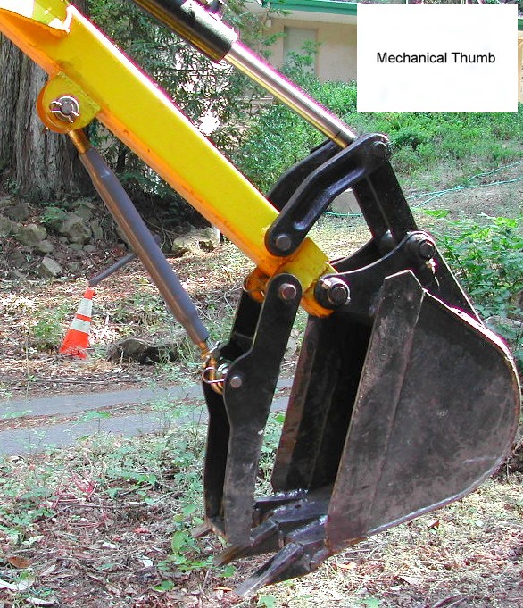

Those who have seen my previous DIY thumb postings will note the many
similarities to my Fixed Mechanical Backhoe Thumb (1st and 2nd generations),
and my Articulated Mechanical Backhoe Thumb. Here is the link:

Two of my design goals were to be able to completely retract the thumb
when not in use, and to be able to grasp objects with more "dexterity" than
a fixed thumb. Both activities had to be performed from the operator's seat.

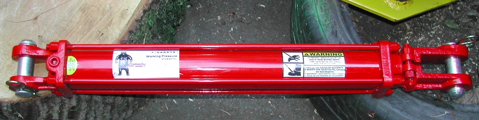

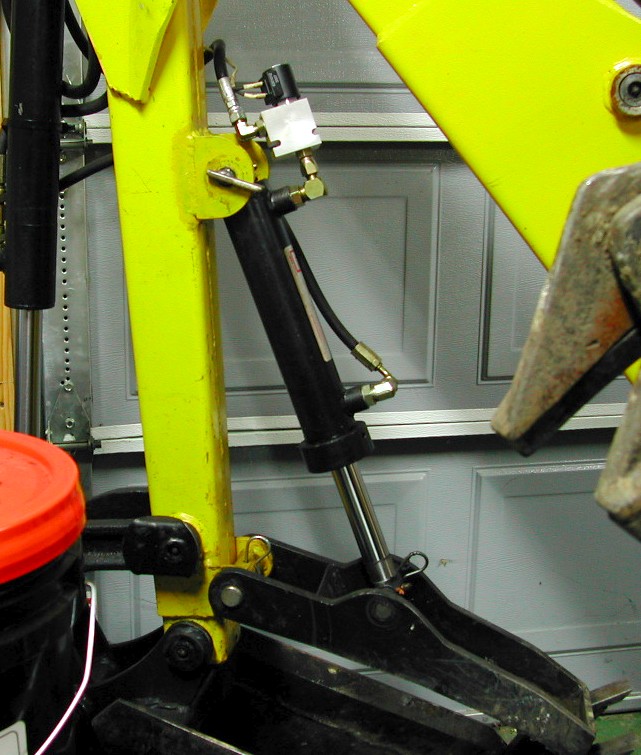

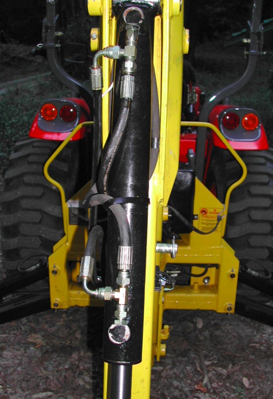

First, the experiments. As a mock-up, I took a 2x8 cylinder I had and
substituted it for the toplink I use for the mechanical thumb brace (2nd
photo). I connected this cylinder in parallel with the curl cylinder so
they operated simultaneously when the curl circuit is activated. This
functionality was very effective in grasping rocks and logs since equal hyd
pressure goes to both cyls. (3rd photo) I moved a lot of rocks and
logs with this setup.
My force calculations and thumb geometry showed that my 2" cylinder
would apply slightly greater force than the bucket at its maximum force
position. At full thumb extension, the bkt force became slightly larger as
the 2 moment arm lengths changed. A 2" cylinder would be best. The
stroke would need to be 11 inches to achieve the desired travel.

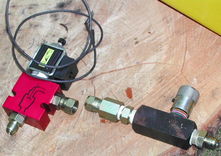

I next tried several kinds of valves in my quest for an economical solution.
I tried manual restrictor valves (photo 1, right), but 2 would be needed and
I would still need to get off the hoe to operate them, essentially turning
the thumb into a fixed thumb. The red valve is a solenoid-operated
poppet valve, which will cut off flow in only one direction. Again, 2 would
be needed.

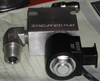

I decided to go with a single solenoid-operated spool valve that would cut
off flow in both directions. I used this in preference to a solenoid-operated
diverter valve because those are a lot more money and they are much
larger, and require more hoses. By cutting off flow to only one side of the
thumb cylinder, I convert it to a fixed thumb, either fully retracted or
stopped anywhere in its travel. The 2nd photo shows the Hydraforce valve
I used. The 3rd shows my mock-up with the new valve. The valve was
about $40, but had to be ordered from a catalog from a reluctant distributor.

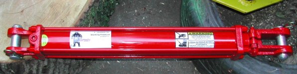

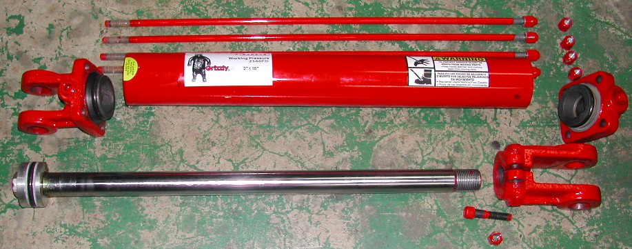

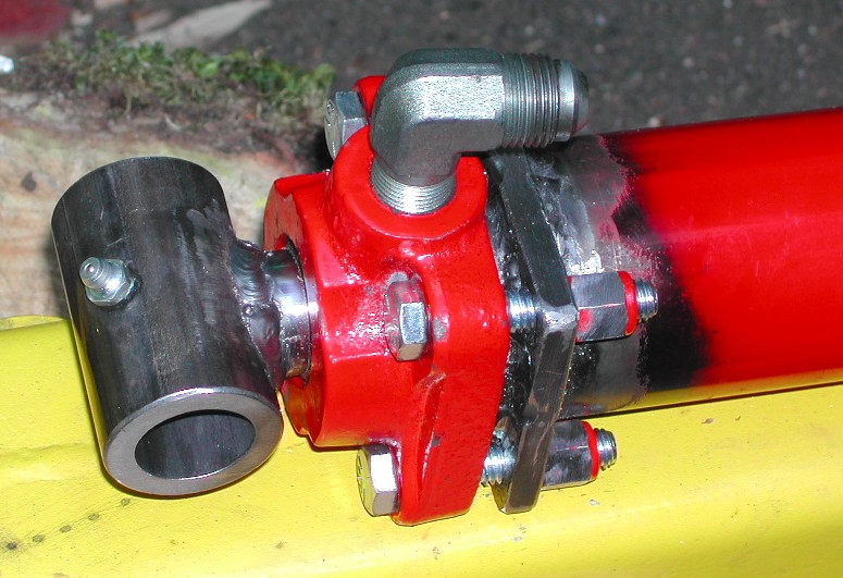

The cylinder tie bracket and end plate I cut out of 1/4" plate so I could
customize a tie rod cylinder. I waited for a long time for a decent 2" diam
cylinder of at least 12" stroke to become available on Ebay or Surplus Center,
but I did not find any for under $80 or so. So I took a Grizzly 2x16 that I
had ($75 from AgriSupply) and cut it up. If someone wanted to to use a
standard size cylinder, they could design their thumb around the cylinder,
rather than design their cylinder around their thumb. I prefer welded cyls
over tie rod cyls cuz I wanted welded cross tubes and the tie rods offer
more places for debris to get caught. 2nd photo shows the cyl intact;
3rd shows it all apart.

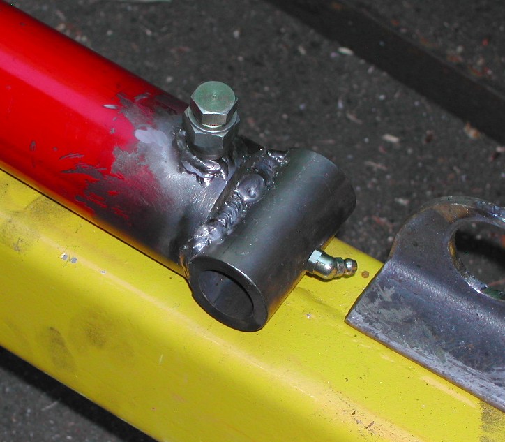

/ Custom hydraulic backhoe thumb
These pix show the cross tubes just after welding them to one end of
the cylinder and to the rod. I also drilled and welded a JIC female
fitting to the cylinder end and capped it for an air pressure test. I am
rarely a good enough welder to get it air-tight the first time. Hence the
air pressure tests. My cylinder is now a hybrid between a tie rod cyl and
a welded one.

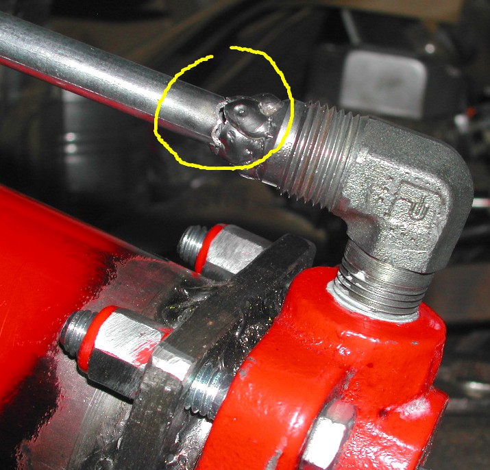

Next, I wanted to use a hard line for the retraction hydraulic connection.
This end is closest to the action so I wanted to minmize risk of hose damage.
Ever have a hose under pressure get ripped out? What a mess! My third
photo shows how NOT to weld up a hard line. My hyd hose shop gave me
the tubing in the photo and I welded it carefully, but it was very weak
at the weld and easily broke. You can see the chrystalline ends of the
break in the photo. Clearly the wrong tubing...it was only .030 in thickness,
too. I went and bought some 3/8 .063 tubing at Home Depot and re-did
it. My next post will show the finished custom cylinder.

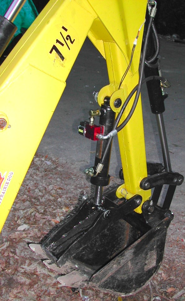

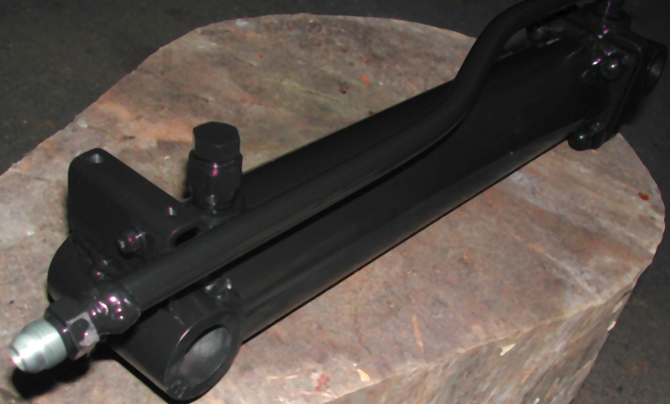

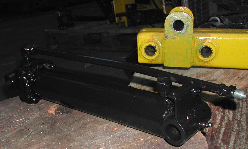

And here is the finished cylinder. The glossy black paint and lighting
conditions make the pix not that clear, but you can see the hard line
and the bracket for mounting the solenoid valve.

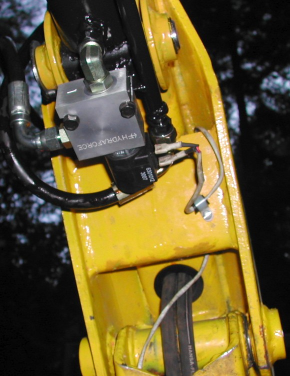

In the 3rd photo, with everything installed on the backhoe, you can see
the valve mounted on the cylinder and the electrical connections. I made
it so there is no hose or tubing between the valve and cylinder. Strain
relief is provided for the wires.

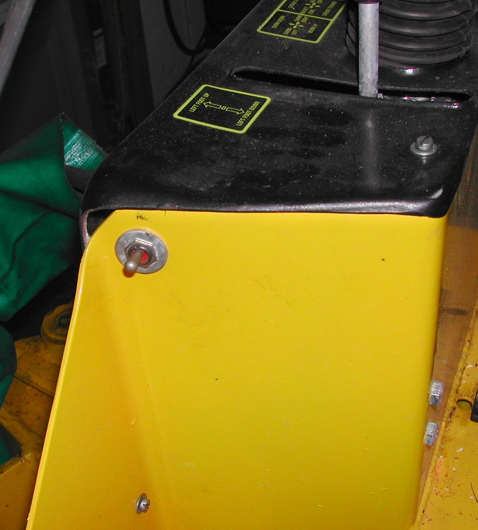

The 4th photo shows my thumb control switch, which is on the left side of
the control console. When ON, the thumb cylinder operates at the same
time as the bucket. When OFF, the thumb is fixed in the position it was
in when the switch is thrown. BTW, this is a water-proof switch...rarer than
hen's teeth.

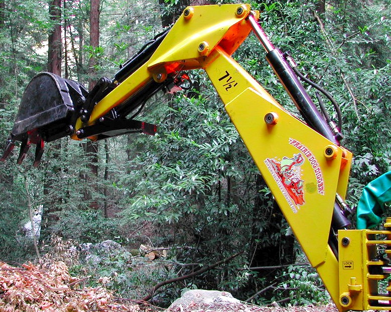

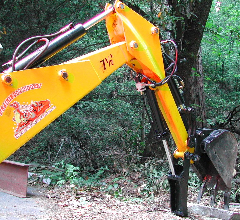

Here is the completed hydraulic thumb showing fully open and fully
closed positions. The only thing I need to change is to have another
short hose made to replace one that has the wrong end fitting.
Thx, MJN & RED
RedDirt said:
1. What is a cost estimate for the solenoid-spool valve?
I quoted about $40 back in post #2, but allow me to expand: I live near
a big metro area that should have plenty of places to buy hydraulic stuff.
Other than hoses and fittings, I have had only poor experiences at retail
bricks&mortar places. Consequently, after Prince closed its direct sales
site, I have been relegated to Surplus Center and Ebay for valves and
cylinders. If I need something specific from a catalog, I can rarely get
a distributor to call me back. I keep PDF catalogs from numerous valve
suppliers (Parker, Eaton, Sterling, etc) and most carried what I needed.
After a month of waiting, I got a Hydraforce disti in Oregon to send me
a couple of their SV08-24-6T-N-12DS valves. This is a 12 volt 3000psi
4.5GPM unit with dual spade connectors.

Have you used the hydraulic thumb enough to to see whether the preferred operation method is locking the thumb in position and moving the bucket toward it or having both the thumb and bucket move together.
Having both cyls operate at the same time is vastly better than just
having a fixed thumb. When fixed at one position, I almost always have it
at full retract to get it out of the way for serious dirt digging. My mock-up
with my 2x8 cyl provided all the functionality I current have, except for the
full retraction and I put a bunch or hours on it. (I was waiting for the
right cylinder to come along.)
RedDirt said:
You say "either the bucket OR the thumb moves by itself...". Why is this an "either" situation? Is it just the dead weight of either at a particular boom angle that makes one movement override the other? Is the override predictable? IE can you tell which one is going to move first, as in choosing where to position the boom when setting up to grab something?
Imagine 2 scenarios: the first is where the dipper is extended outward
and both the thumb and bkt are fully retracted. If I operate the curl circuit,
only the bkt moves initially because gravity helps out and the bkt provides
less back pressure on the bkt curl cylinder. As the bkt nears about 3/4 of
its curl travel, the thumb starts to move since now the backpressures favor
the thumb cylinder. In the 2nd scenario, I have the bkt and thumb fully
retracted and a big rock positioned to grasp. As I operate the curl circuit,
the bkt moves toward the rock, then stops as it touches it. Then the
thumb moves toward the rock. It is quite predictable and the rock does not
get moved before it is grasped. If you go back and look at the articulated
thumb I made, where the thumb and bkt actions were linked, I often got
into situations where the thumb action would lift the hoe before I contacted
the object I was trying to grasp. Or the bkt would move the rock before
the thumb could grab it. On an excavator I operated a few years ago,
I would position the bkt on the back side of the rock, then extend the
thumb with the foot pedal. With my current setup, those actions are
automatic. I do not feel I have many ANY compromises by not using a
separate spool valve or full diverter setup.

My solenoid spool valve, when de-energized, simply blocks the flow of
oil to one side of the thumb cylinder. This converts the thumb to a
fixed thumb since oil can no longer enter or exit EITHER side of the cyl.
There is no need for a 2nd valve at the other cylinder port.
