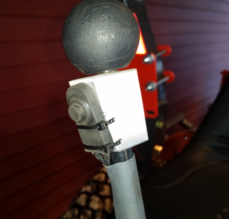

Thumb switch 2.0
Mounting block slips over shaft and stays there with two set screws. Zip ties best thing I could come up with to keep the switch on the block

No worries ac. Part of the fun is coming up with the design on your own. In this case, I was very constrained by the size of the scrap of aluminum bar stock that I had kicking around in the shop. That block has some tooling marks on the other side that I couldn't avoid. If my OCD really kicks in this spring, I might have to butter them with Bondo and paint the thing. Right now just having a ton of fun playing with the thumb to rip out stumps and rocks before the ground freezes (which will likely be tonight!)

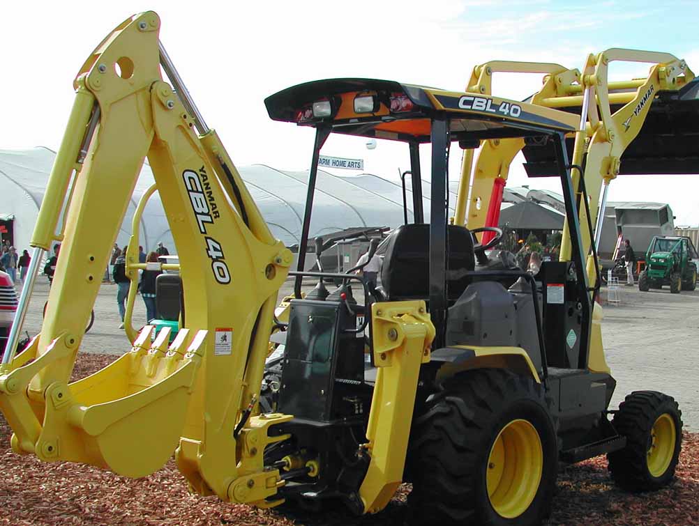

That said, what a fine industrial tractor, the Yanmar CBL40. Does it have an extra valve on the
hoe, for an added function (thumb, auger, breaker, etc)? What is the system hydraulic pressure?
My guess is it runs at about 3000psi for the FEL and hoe.
Finally, what are the extra 2 holes in the dipper for?

Been happy with the machine, Basically a stripped down version of the JD 110 TLB, 2nd owner mostly used on my property but has been dug a few small foundations already. I don't believe a bolt on would work for me, I tend to work my equipment a little hard. I have welding set up so that wouldn't be a problem. Unfortunately the machine is bare bones, No aux. hydraulic set up. That's why I was thrilled to find your posts, seems it would be a good set up for me without becoming a major project, time is scarce lately.So That is why I hoped to use an prefab hyd. thumb and then add your hyd. setup to it.
According to manual the backhoe runs between 3400-3675 psi, FEL is 2350-3000 psi. Didn't realize till now it has 3 separate hyd. pumps.
As to the extra holes, couldn't tell you, mine doesn't have them.
Wouldn't mind any additional input- Thanks!
