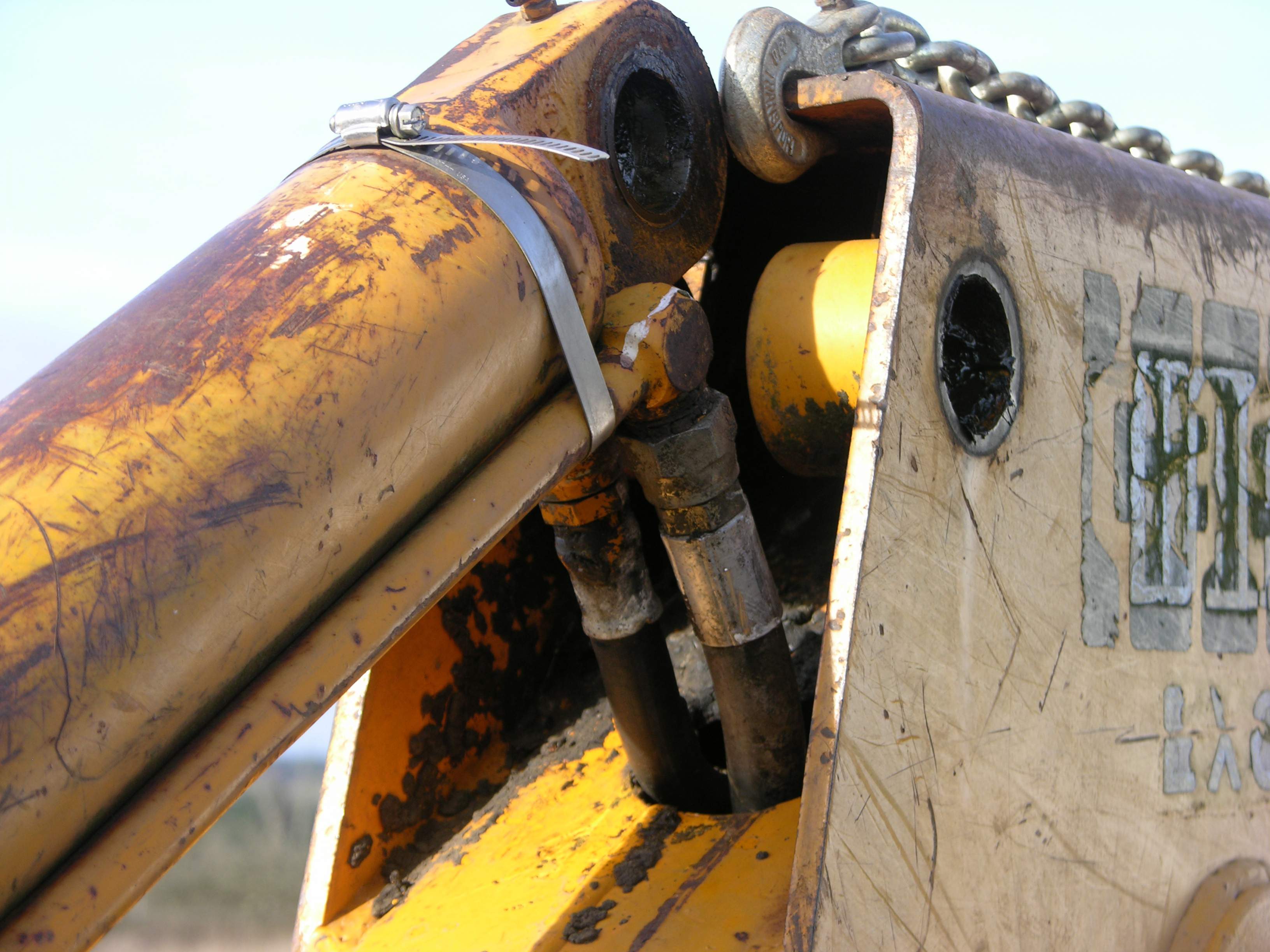

So after reading this forum multiple times, I said to myself, "This is something I HAVE to do". I just got a new Woods BH75 with the mechanical thumb and I can appreciate how useful a hydraulic conversion would be. But I've got a couple challenges that I'd love some expert input on, keeping in mind that I'm mechanically inclined but have little experience tearing into hydraulics.
1. Woods told me the curl cylinder is a 2 1/2", 3000# cylinder with a 12 1/2" stroke. I confirmed the stroke with a tape, and the OD of the cylinder body is a little over 3", so I tend to believe them. Figuring I have to approximately match the applied forces, I thought I'd go with the 2 1/2" Chief WX welded cylinder that has the rotating ports (which Bailey's reports as backordered). Interestingly, the 2 1/2" cylinders take 3/4" pins, while the 2" cylinders that you guys are using take the 1" pins. My thumb has 1" pins. What to do about this? Given this cylinder would only experience significant compressive forces, would I just hog out the ends to 1"? Or bush the bosses in the dipper and thumb and go with the 3/4" pins that the cylinder wants?
2. The pin-to-pin dimension on the existing thumb linkage is 20 1/2" in the stowed position. The retracted length of the 2 1/2" WX cylinder with a 12" stroke is 20". The thumb won't stow quite as tight against the dipper, but probably OK. The range of motion on the existing thumb linkage is 13", so I think I'll be OK with a 12" stroke. You guys with me on this? A cylinder with a 14" stroke has a retracted length of 22" which I think is too long to stow the thumb properly.
3. Now the plumbing. Below (I hope) is a photo of the dipper. The curl cylinder has 90 deg ports welded on. According to Woods, they take a SAE 6 male O-ring Boss fitting. The centerline of the female is only 3/4" off the surface of the cylinder. Can I get a male O-ring Boss tee in there? If I have to spin the tee to thread it in and then tighten the O-ring keeper nut (which is how I think they work), then the answer is NO. If the answer is no, then what? How would you plumb it? Short section of hose off the cylinder fitting and then a tee? Or two 45's to step off the surface of the cylinder? I think it might get real ugly real fast.
4. The part that I thought would be the most difficult turned out to be the easiest: I ordered the Hydraforce SV08-24-8T-12DS valve from Hydro-Air Hughes in CT. All pieces parts were in stock and it should be here on Monday. The 8T designation indicates SAE 8 ports, which I thought would be a good idea since the WX cylinder has SAE 8 ports as well. Would likely mount it like Bumpern did, provided I can still get to the grease fittings.
Looks like this will be a winter project since the cylinder is backordered. I'd prefer not to modify the new cylinder because it seems like the length and stroke will be "close enough". Plus I don't have the right tooling but I could call in a favor to have it done if I need to.
Any other potential issues here? Would really appreciate some fresh sets of eyes on this before I order a bunch of stuff that isn't going to work!
/ Custom hydraulic backhoe thumb #139
Make sure the manual link bosses will provide enough spacing from the dipper boom to mount the cylinder you are talking about.
I'd use two 3/4 to 1" bosses to adapt down to the smaller 3/4 cylinder pin.
"2. The pin-to-pin dimension on the existing thumb linkage is 20 1/2" in the stowed position. The retracted length of the 2 1/2" WX cylinder with a 12" stroke is 20". The thumb won't stow quite as tight against the dipper, but probably OK. The range of motion on the existing thumb linkage is 13", so I think I'll be OK with a 12" stroke. You guys with me on this? A cylinder with a 14" stroke has a retracted length of 22" which I think is too long to stow the thumb properly."
If, as you say above, the mechanical linkage retracts to 20 1/2" and the cylinder retracts to 20", that would have the cylinder coming up short, not being able to retract all the way, banging the thumb into the cylinder, it would also subtract an additional 1/2" from the effective extended length - if I'm understanding you correctly.
Okay, I wouldn't necessarily go by the length of your mechanical linkage unless, that is, it allows full thumb movement in the extended position as well. It is desirable to have it all, full retraction and full extension, if you can get that. I got more extension with the cylinder I used, but that's on a different hoe of course. In order to fully utilize the range of the cylinder, I added a 1/2" spacer to the cylinder end by cutting off the pin boss, inserting the spacer and welding it back up. This also allowed me to correct a small alignment issue, tack welding the spacer in place while mounted to the hoe, then taking it off to fully weld. Also gave me the opportunity to move the zerk fitting so it wouldn't require disassembly just to grease the darn thing.
You are correct on the SAE O-ring issue, you gotta have room to swing the thing to thread it in, ending in the direction you want the fitting aligned, then snug up the nut driving the washer to seal and lock.
I know I haven't addressed all the issues . . . need more pictures and I need more active brain cells.
/ Custom hydraulic backhoe thumb #140
Thanks Bump: "If, as you say above, the mechanical linkage retracts to 20 1/2" and the cylinder retracts to 20", that would have the cylinder coming up short, not being able to retract all the way, banging the thumb into the cylinder, it would also subtract an additional 1/2" from the effective extended length - if I'm understanding you correctly."
You are absolutely correct - I had it backwards. This is an important point!
The photo shows the thumb linkage fully extended which is 33 1/2" pin to pin. The 2 1/2" WX cylinder with a 12" stroke gets me to an extended pin-to-pin of 20" + 12" = 32". This is an inch shorter than the mechanical linkage. Now I get why you added a 1/2" weld-in spacer. I could do the same and get my retracted length up from 20" to 20 1/2" (matching the mechanical linkage) AND get my fully extended pin-to-pin dimension up to 32 1/2". 1" shy of full pin-to-pin extension with the mechanical linkage.
Now I'm curious whether a cylinder with a 14" stroke would work. I'd sacrifice some stowage because the retracted length is 22" instead of 20". Time to get the tape measure out again! Looks like the "ideal" cylinder is right between the 12" and 14" standard stroke sizes, both for range of motion and retracted length.
How tight does your thumb tuck up to the boom and how far does it extend? Does it look anything like mine when fully extended?
I think I'm good on the pin boss on the dipper. The centerline of the pin is 2" off the dipper. This should leave me with 1/2" of clearance using a 3" OD cylinder.
I'm still a little worried about the 3/4" pins given the forces involved. I have 3 7/8" clear between the pin bosses on the thumb. The rod end is 1 3/8", so I would need two 1 1/4" bushings to take up the slop. Bailey told me the cylinder could generate 9300 lb of force at 1900 psi. I don't know if a 3/4" pin is going to withstand that without bending?
And I took a closer look at the bucket linkage. Turns out the curl cylinder linkage pin is 5 1/2" from the pin the bucket rotates on, while the (future) thumb rod end pin is 7" from the pin the bucket rotates on. So the thumb cylinder would impart more leverage on the thumb than the curl cylinder does on the bucket. Makes me wonder if I could get away with a 2" cylinder instead of a 2 1/2" for the thumb. We are trying to match bucket curl and thumb rotation forces, correct?:confused2:
