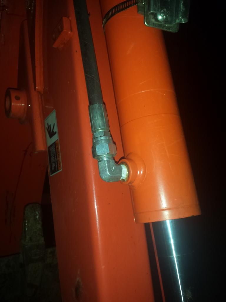

I'm pretty excited about just paralleling the curl and installing the one valve. The plumbing is easy, the electrical easy. Yes, I lose 100% total control of the thumb, but the installation and cost advantages are significant.
A full-on diverter is going at the front of the machine to steal curl for a future grapple.
