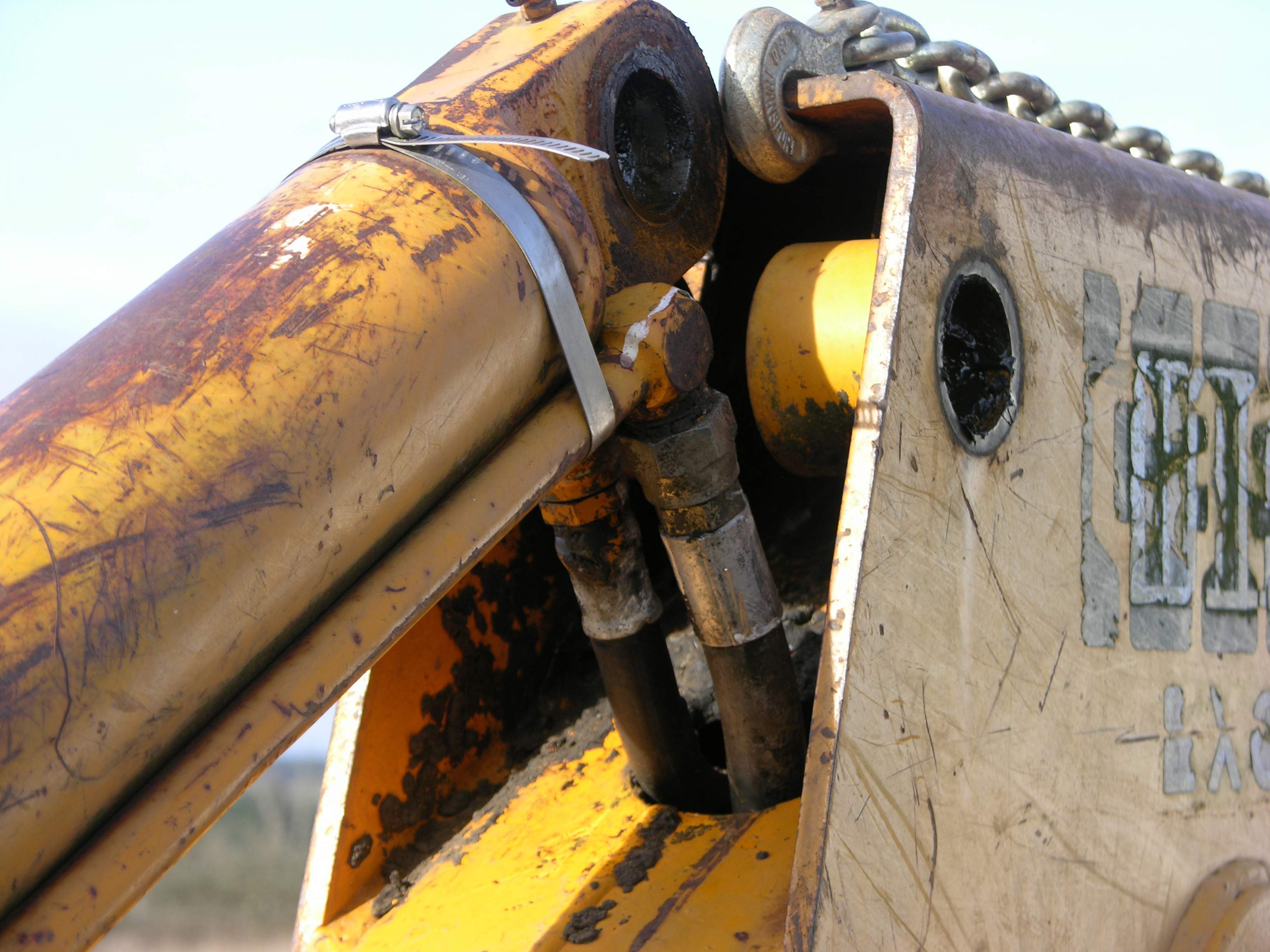

You guys are lucky - I was looking at my Case 580B today, want a thumb on it before next year - unfortunately, I may end up running new hard lines out the boom (hoses where necessary) because Case really buried anything that could snag.
Bucket curl connections are BETWEEN the cylinder and the boom, with access holes in the boom for the hoses to dive into and -12 JIC's - absolutely no room to play with those connections. Here's a pic from a few years ago when I re-hosed the hoe.
Oh well, if it was too easy it wouldn't be as much fun :confused: ...Steve
Yeah, industrial equipment is a lot harder to work on, but they go thru h3ll.
Agree, it's tight. But this T connection may work I'd think: SAE 37° (JIC) Swivel Nut Run Tee
6602-12-12-12
http://www.discounthydraulichose.com/v/vspfiles/photos/6602-1.jpg
This would move the existing hose end fitting towards the hole in the boom, the T fitting going between it and they cylinder to provide perpendicular JIC males for the new hoses to connect, and exit parallel to the cylinder.

Guys, I may complain but I'm too stubborn to give this up without a serious fight - before I bought that 580 I was looking for a used Kubota, found the 580 and at first wondered why anybody'd want one - light on the front end for good downpressure backdragging (figured that one out), older ones you could take off the hoe and replace with a HERKY 3 point with both float and power down (got one, along with a Gannon box) - suffice to say, that's now ANOTHER thing they'll hafta pry out of my cold dead hands :thumbsup:
Bumper, I'll have to check out that run tee plan, thanks for that - also, I've been collecting tons of pix of any and all 580's from CK's up to L's, and noticed a few today that the curl cylinder is in upside down - that would put those inaccessible JIC's on TOP, and they would just clear the back end of the knuckle cap.
Downside is the hosing could get messy, gotta look at that more when I don't get a mouthful of rain :mad:
