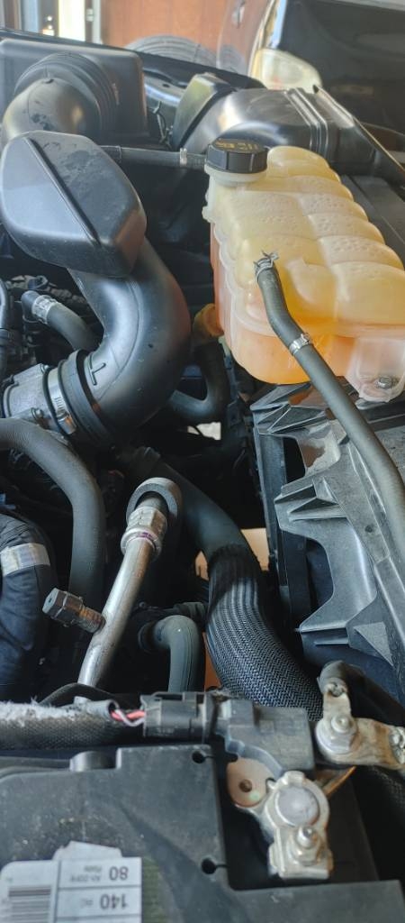

Changing the coolant in my 18 JD 5075E and my coolant reservoir is empty. Still plenty of coolant in the radiator. Tractor doesn't have any issues overheating unless I get the coolers and radiator filled with trash where they can't breathe. I started filling the reservoir with water to flush the system, and it just sits in there and doesn't go anywhere. I have to remove the radiator cap to add to the coolant system. How is this thing expected to gravity feed? The hose running into the radiator sits higher than the reservoir.the only other hose is an overflow hose. My trucks have an extra large hole coming out the bottom of the reservoir to run into the system. The manual says to fill at the reservoir? WTF?
Here's the tractor with the two small hoses and one of my trucks with the large hose coming out the bottom of the reservoir.View attachment 842612View attachment 842613

The coolant system is a closed loop. That is that when the coolant gets hot it expands and overflows into the reservoir. When the coolant cools, it will suck coolant from the reservoir back into the radiator. The reservoir does not need to be higher then the radiator.
Do NOT put water in the reservoir, always put antifreeze in it.

Just an expansion tank and nothing more and it actually increases the fluid capacity of the radiator because it removes the air space in the top of the rad holding tank so no air in there unlike vehicles with no expansion tank. On my trauk and cars, there is no rad cap. Everything is done through the expansion tank and the pressure cap is on the tank. On my tractors, they have a rad cap on the rad and the poly tank is merely for expansion.

Your radiator cap is maintaining pressure in the system. It has two sealing surfaces, the top one seals the radiator cap to the top of the radiator neck, the spring loaded lower one seals the lower portion of the neck to the radiator header tank. As the coolant heats up the increased pressure pushs coolant past the first seal and it flows into the coolant over flow bottle. Once the engine is at operating temp the fluid temp and pressure is fairly constant and the radiator is 100% full with some coolant in the over flow bottle. When you reduce the engine load and then shut down the tractor the fluid begins cooling and contracting this creates a vacuum in the radiator which in turn pulls the fluid from the over flow bottle. This way the radiator top tank is always at 100% full as long as the over flow has coolant in it and the hose doesn't have an air leak and the radiator cap is in good shape.
If you check your radiator with the engine cold it should be full, and the over flow reservoir should be above the low mark, as you work your tractor the level in the over flow will rise, when you shut down and the radiator cools the over flow reservoir should decrease from the hot level back to the cool level.

Question depends on system design. Many modern automotive cooling systems have pressurized expansion tank. Radiator is sealed and pressure cap is on the expansion tank. On those systems the only way to add coolant is through the tank. If expansion tank has unpressurized cap then radiator cap allows overflow coolant to flow to tank when pressure exceeds rating of cap.

Those lines are to show you that there is the correct amount of coolant in the system. When the engine is cold the coolant in the reservoir should be at the "COLD" line, when the engine is hot the level should be at the "HOT" line. If the coolant tank is not pressurized then coolant should be added to a cold radiator.
