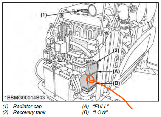

I have a 2020 LX2610 Cab, just took it home from the dealer last week. I ran it for about an hour playing with the settings, etc. I noticed the next day some bring green (almost like smushed grass color) drops on the snow. I checked the coolant and the level is at 25%~. Could it be a leak some where? I am going to talk to the dealer but wanted some tips first.

What was 25% full - the degas bottle or the radiator?
If it was the degas bottle, as long as it’s between the fill marks, you should be ok.
Shouldn’t have any leaks though, so still make sure everything is tight as explained in the prior posts.

Check the clamps, but that is the recovery/overflow/reservoir tank. As said, just make sure it stays between the Low and Full marks. The first couple times you run the tractor it can change as you purge the air and any extra fluid, especially if the fluids were added at the dealer before delivery. Dont worry if it doesn't stay 'Full', eventually it'll find it's equilibrium and then that level will be what it stays at.

Anywhere’s between those lines is good. It needs room to expand/contract with the temp changes. A leak should be fairly easy to see as already mentioned. Not sure if you have dogs but you’ll also want to clean up the spill if it is coolant because it does horrible things to animal innards and it sitting on snow is about the most concentrated way they could get it outside of a puddle.
/ Coolant on the snow? #11
Sounds like the coolant level is perfect. Not unusual for a few drops or spoonfuls to be thrown out when working. Check clamps. Clean up drops to protect our furry friends - it's sweet tasting poison.

It's raining out right now, but took a quick look. The engine bay is dry, no leaks. I ran it for about 10-15 minutes on idle. The clamps on the small hose near the tank is. how would I tighten that one? The larger hose from the radiator to engine, I did not touch yet.

That small hose you circled does not need to be tightened; is good as is.

None of the hoses you showed are leaking, and the level in the bottle is still good. The next step is to run the tractor for a bit while keeping an eye on the temperature and fluid level in the bottle. If the temps stay good and the bottle doesn't over flow, you are good to go - run with no worries. The little bit you saw on the ground was most likely just the engine burping out some air and/or excess fluid added in when the dealer did their pre-delivery checks. It happens.
