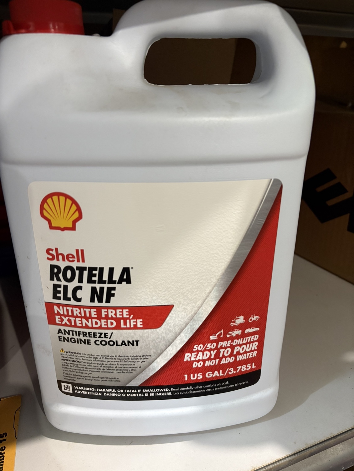

I put this in my B3200. Green stuff was in it originally. Drained and flushed with water a couple times put this in. This is more red/orange color, formulated for diesel engines. Prevents cavitation around sleeves.

I put this in my B3200. Green stuff was in it originally. Drained and flushed with water a couple times put this in. This is more red/orange color, formulated for diesel engines. Prevents cavitation around sleeves.View attachment 3582129
Kubota diesels ARE NOT wet sleeved engines they are dry sleeved as in pressed in sleeves so coolant NEVER touches them. No need to buy expensive long life coolant or coolant that is made to prevent cavatation, as there in none.
Kubota specifies in their manuals, plain old green colored ethlyene glycol. You can use anything you want actually, but no need to waste money on high tech coolant.
Just drain and flush regularly and keep the rad clean outside.
Again, use anything you want, just make sure you flush the cooling system before changing as some coolants aren't compatible with others.

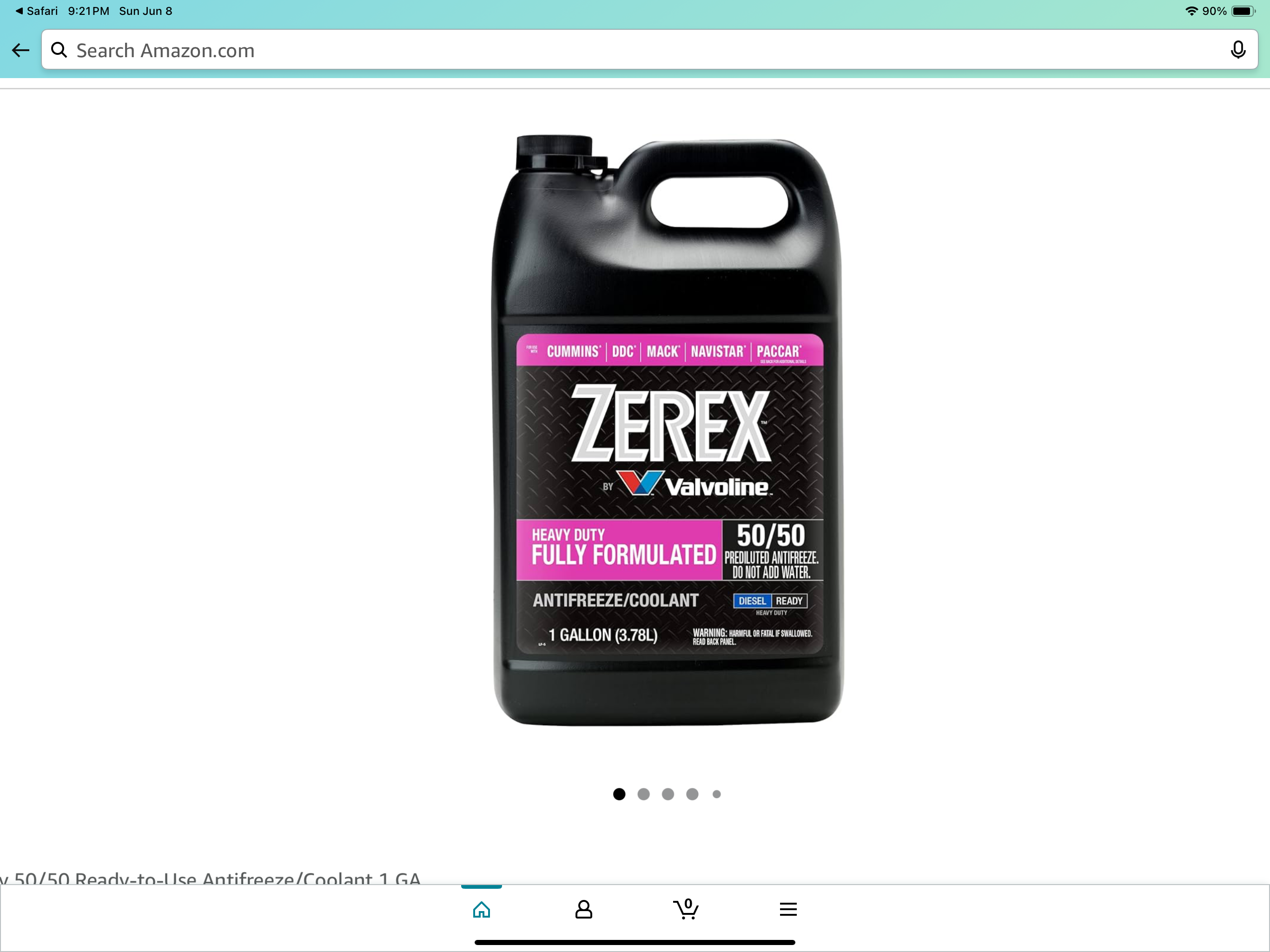

For diesel engines, run the cherry/pink color.
I switched to that in most of my engines for anti-cavitation and long life.
Have you bothered to look and see of your engines have pressed in liners or liners seated against 'o' rings and in direct contact with coolant?
Heck, you can use Jack Daniels as coolant ina dry linered engine if you desire.... :rolleyes:
