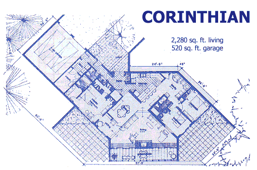

/ Concrete house #71
We live in an earth sheltered home. It was built in 1984.It is open in back for 2 car garage and 2 intrance doors and in the front on 3 sides. It has regular swinging doors in the back and 1 inch thermopane sliding doors in front. It has a 36' greenhouse on the front facing south which gathers a lot of heat in the winter on sunny days. In this greenhouse is a 10' long brick and concrete fireplace that goes from floor to ceiling and it absorbs a lot of heat and transfers it to inside. The house was built with concrete walls and has spancrete for ceilings, it has the grooves and was sprayed with a small popcorn type spray. The spancrete is the same stuff used on bridge overpasses. There is about 3' of dirt on the roof. It is pretty efficient in that when we leave for a few days and turn the heat down to 50, it doesn't kick the furnace on even when it is below freezing outside. It is basically a basement, but does feel like a warm inviting home. Lots of light from the 6 patio doors, 2 -10 footers and the rest 8 foot span. The fireplace is connected to the air ducts and has a 3 speed fan that will heat the whole house with wood, it doesn't take much to run you out, I know this cause my wife loves to keep it burning. I think these were one of the early ways to try to go efficiant and in our case , still does. If you are interested just go to Davis Cave Homes and you will see their idea of how to build earth friendly homes. The ones below are our plan, but was modified slightly by the people who built it. John

Davis Caves was one of the fairly early popularizers of earth sheltered architecture. I havent followed them lately wbut 10 years ago they were still not so modern in their approach and didn't really have many designs that appealed to me. There are a fair number of earth sheltered homes that I have come across in south central Oklahoma. None I think were Davis. Some are DIY and have had some problems due to lack of knowledge on the part of the owner/builder but there are some I have seen that are very well done.
The "heat it with a candle and cool it with an ice cube" comment is often true with properly executed earth sheltered designs. Blower door test? We don't need no stinking blower door test! Infiltration is not too much of a concern and is limited to a few features that are easy to take care of.
