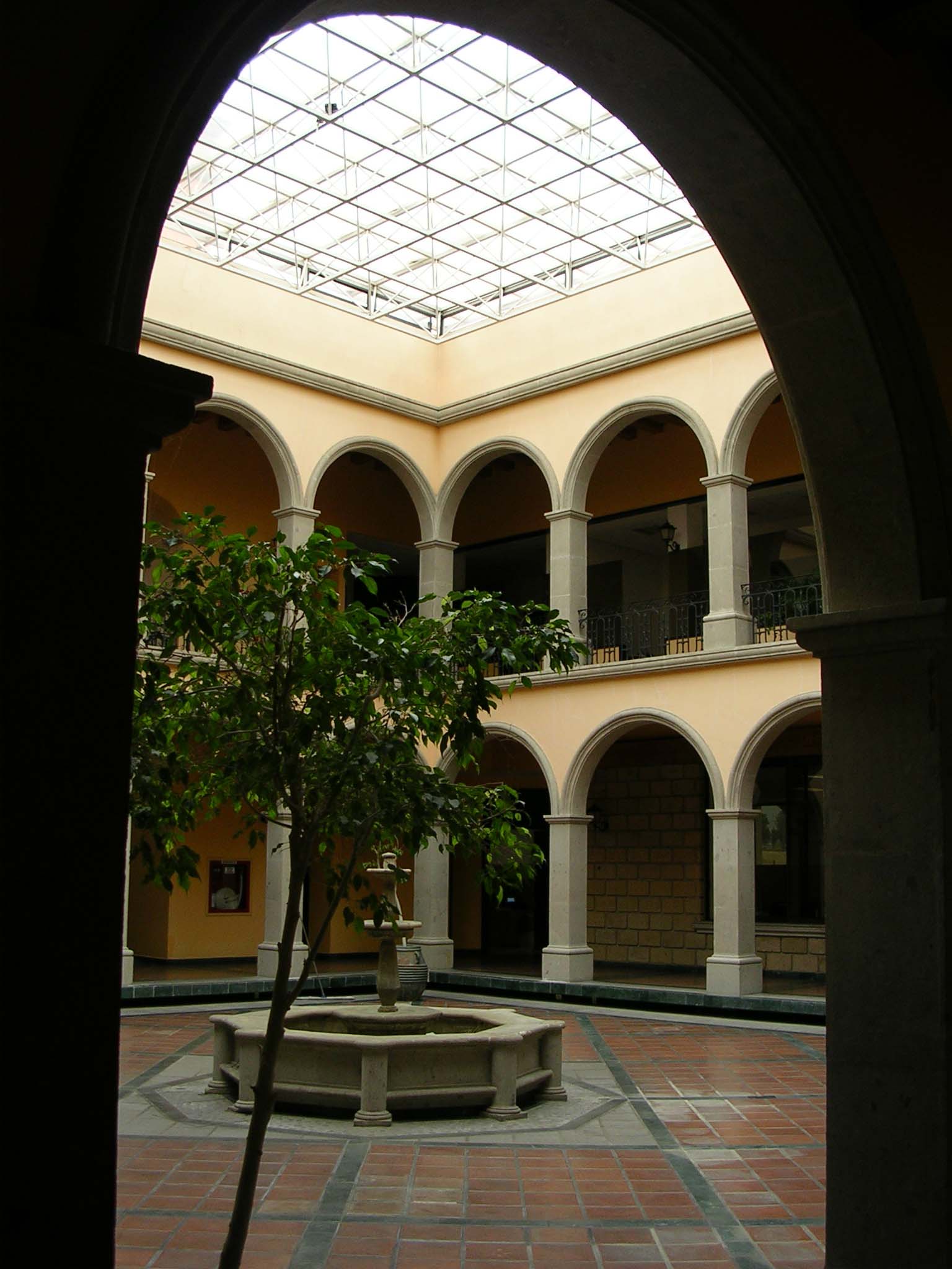

I have two photos I want to post, One of them is the lake view from land site I will build and a nice concrete building in Mexico. My view will be from a bit higher up, say 20 ft elevation. The trees will not impeed my view once I trim.
How do you cut and paste direct into the body of this reply?
