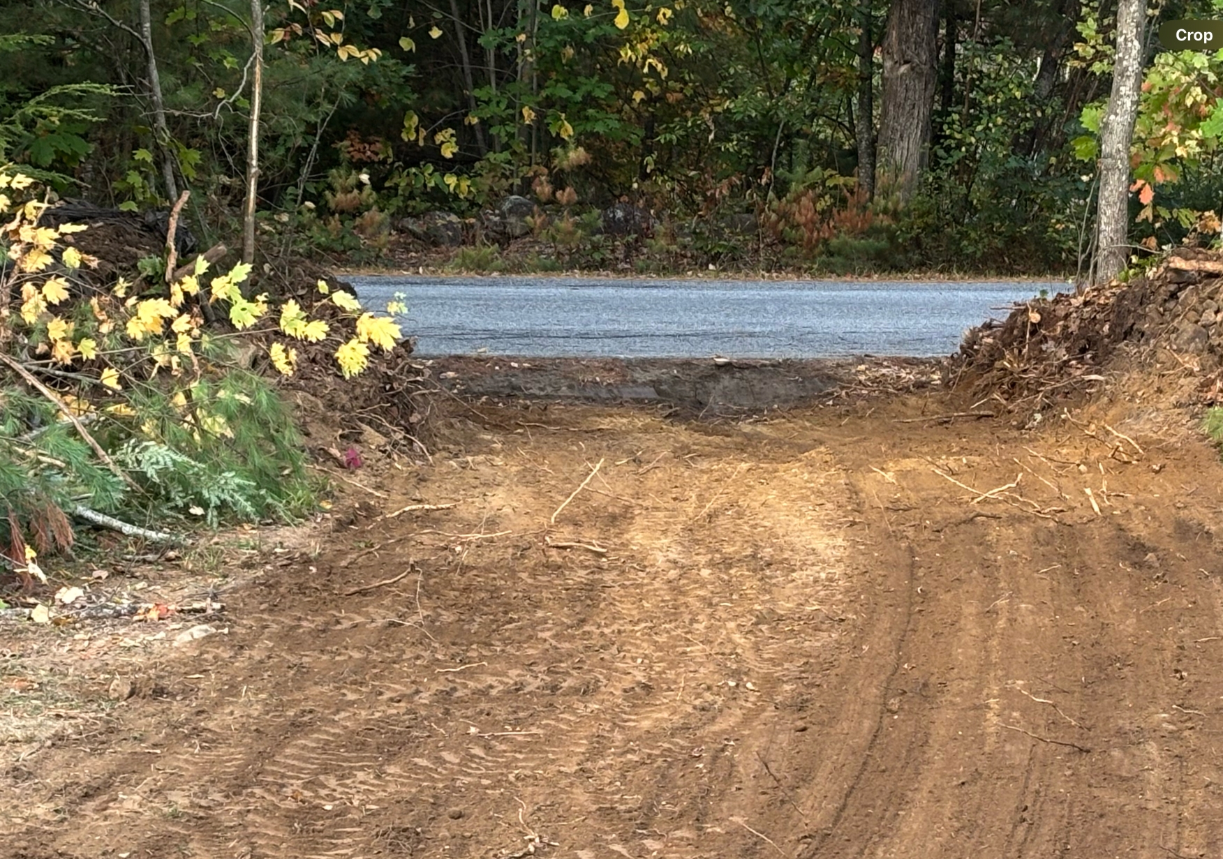

I think I’ve got one of these in my future, probably spring. Considering Typhoon and Kymron. Lots of positive review videos. Seems they both have US support.
I have multiple digging projects and I think it will pay for itself vs renting something multiple times at who know what a whack. Probably 1500 or so every time. I don’t live at the property up north yet so having to plan around when I could get there, weather etc is a concern with renting.
I dug out about as much as I could with my T25 with my bucket on my driveway project, but I need to dig out another 5 feet on width and shape and thin the embankment where it intersects with the road. Then there’s stumps to dig, rocks to dig up (or bury if too big). Lots of fallen trees to clean up etc.
