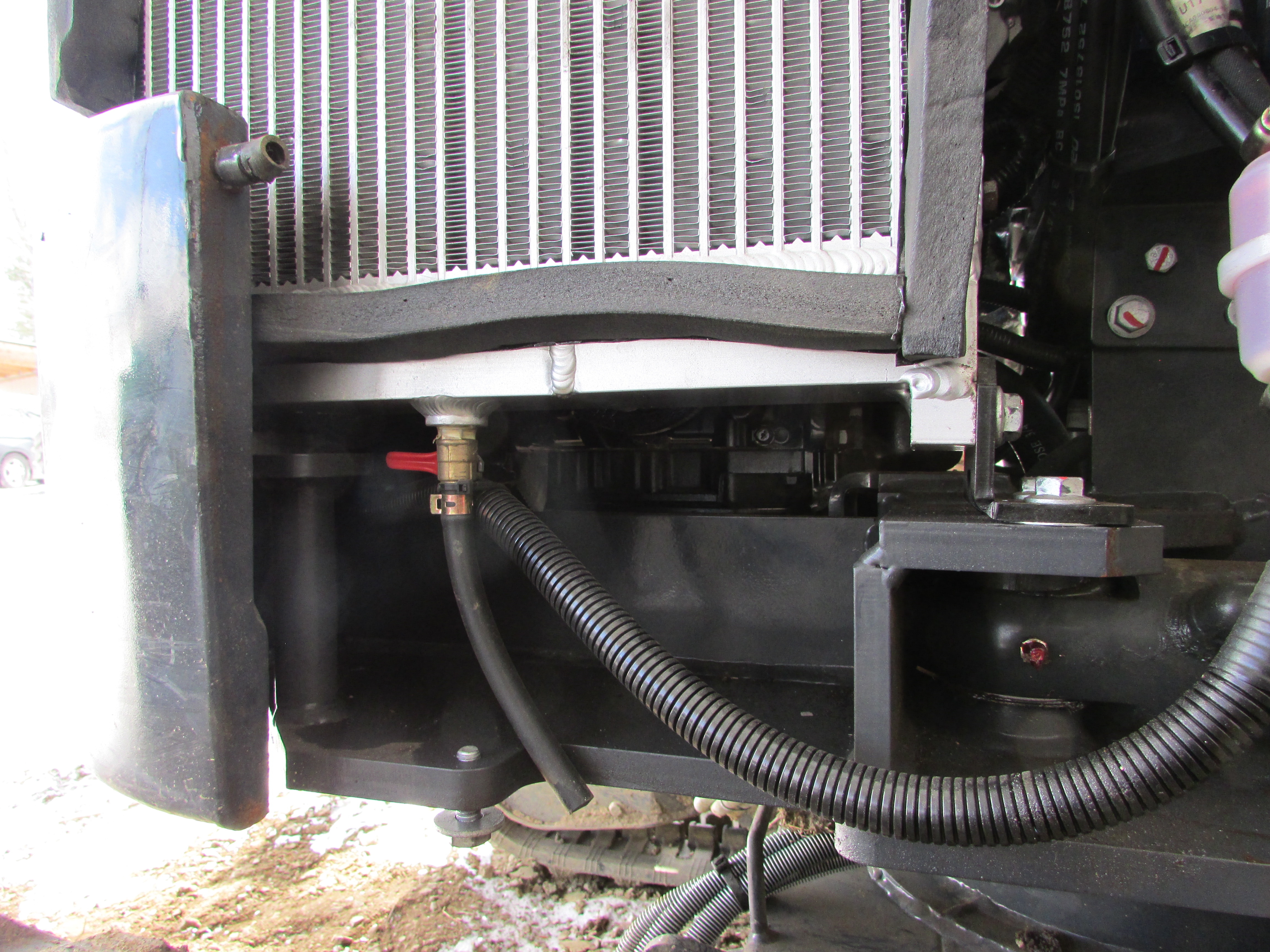

- Reinforced between the drive motors and to protect them from rocks - (XIX has enclosed motors)
Your protection looks good, Carl. More substantial than mine. Don't forget to protect the dozer blade cylinder, even if it is just a steel plate held on by a hose clamp.

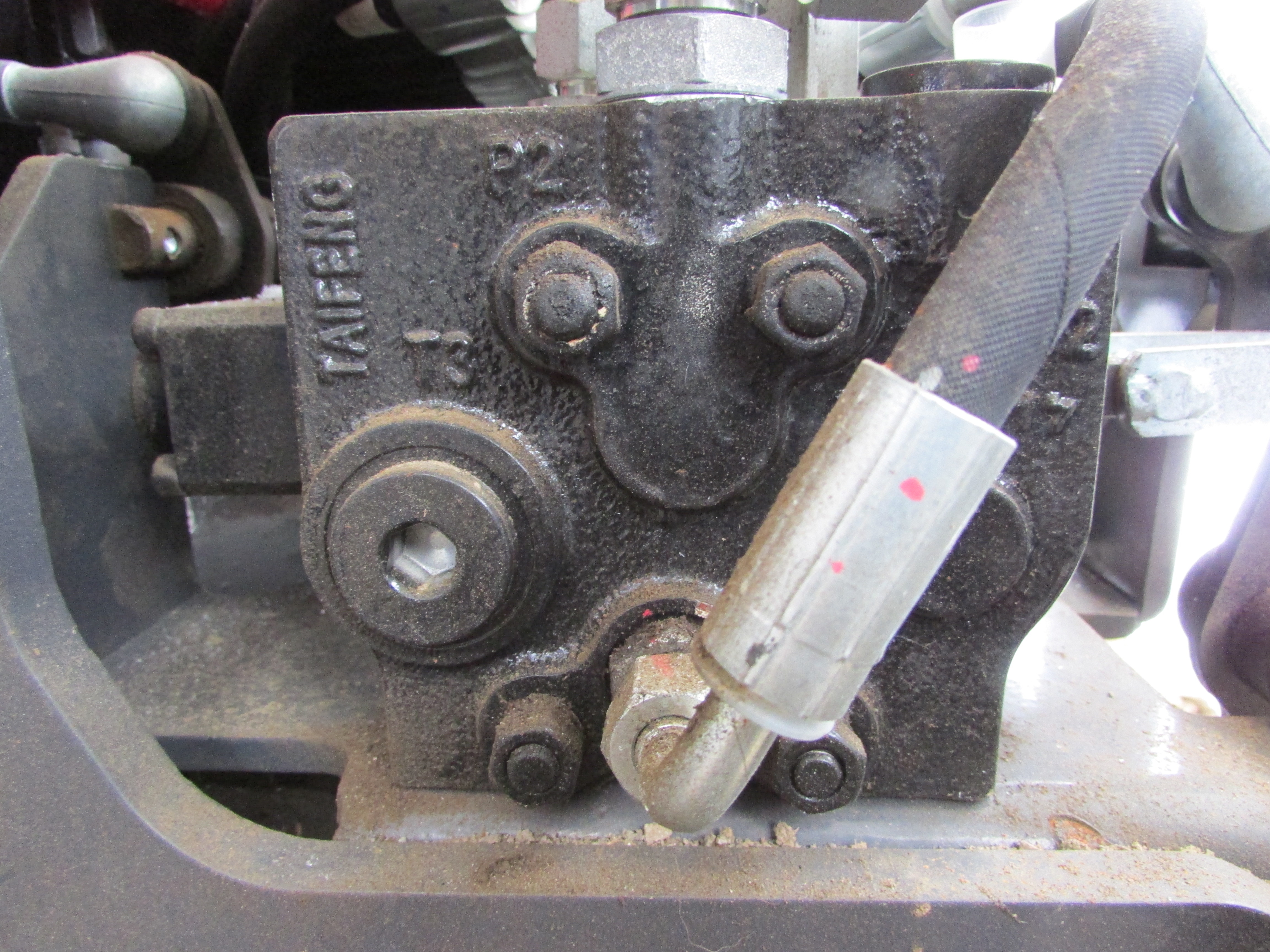

I think the cushion valve on the house rotation motor was not too costly or difficult. Breaking the pinion gear or shaft would be a Bad Day.

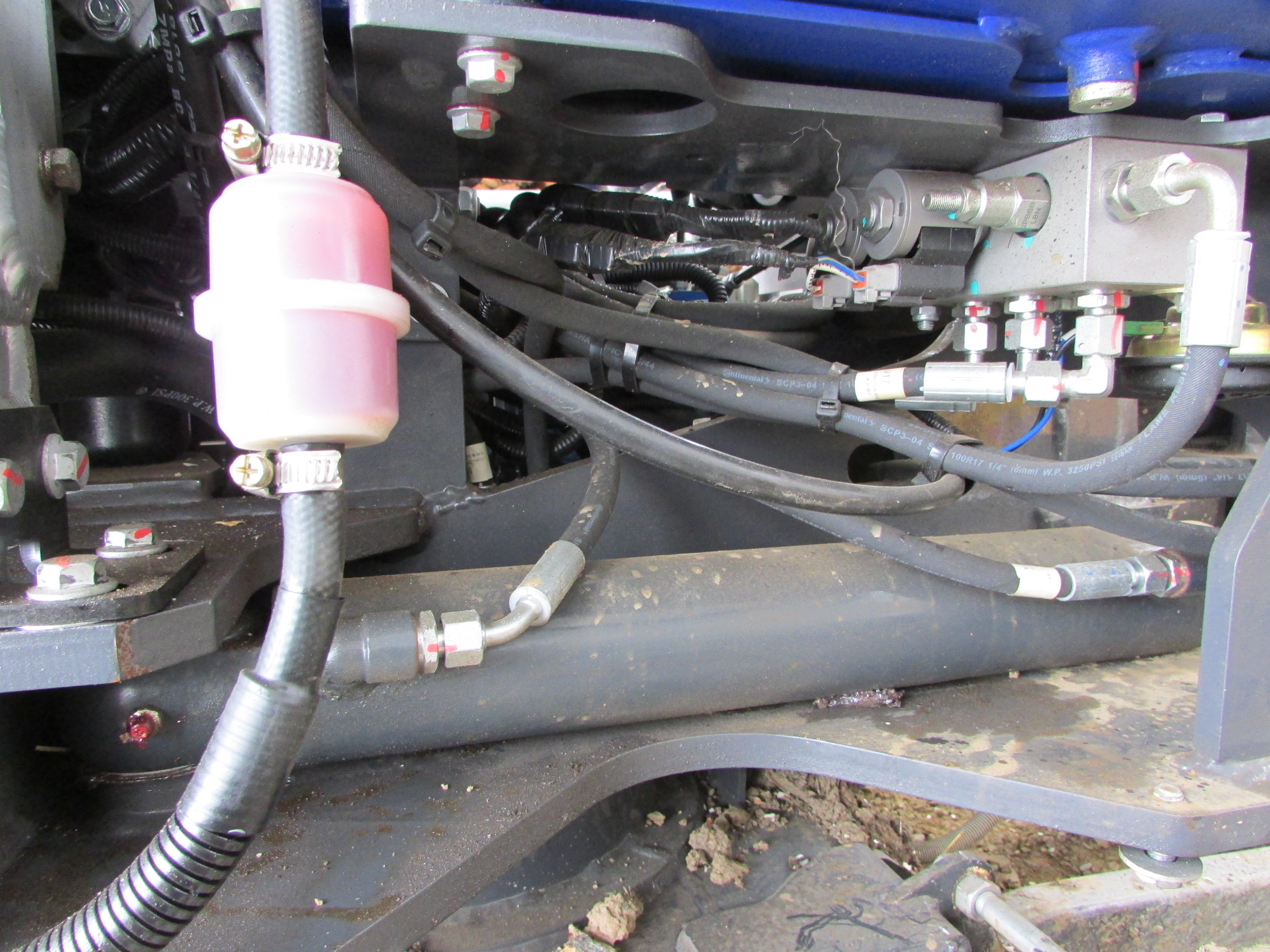

- Added an inline oil return filter - I think XIX has one in the tank

Then the things I wish I had, the relief valve and brake on slew motor, better hydraulics and pumps, more drive speed, but they cost too much and involve too much to change.
I hear you on upgrading hydraulics. No way we could get them at the price manufacturers do.

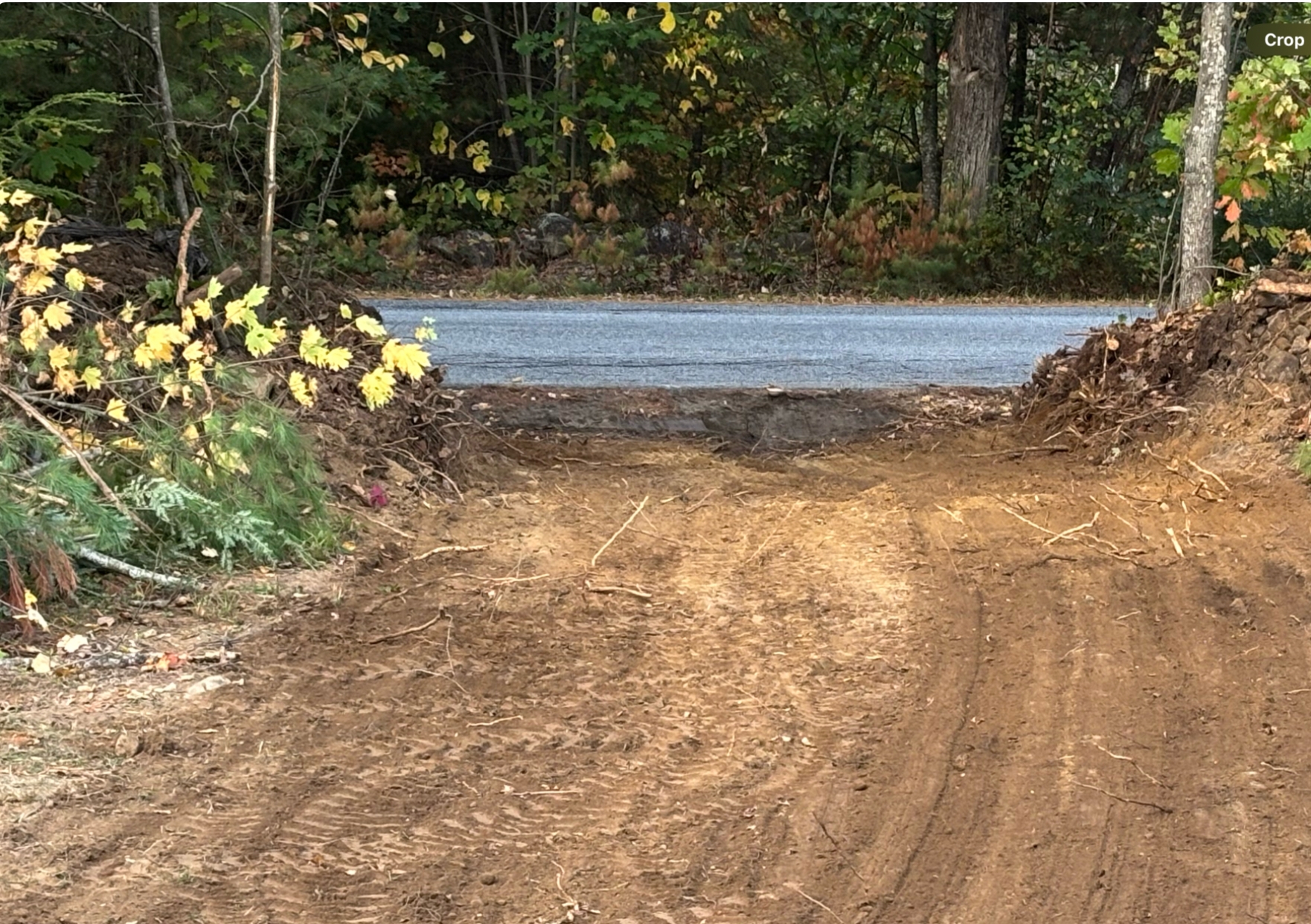

I think I will be ok with the smaller Typhon. My first project will be to dig out a wider swath of this embankment where I’ve started a driveway on my land up north. I don’t mind if it takes longer with a smaller machine. I dug out this part with my T25 toothed bucket, but that wasn’t ideal. The embankment ranges 3 to 4 feet high and like 10 feet deep and all hard packed dirt over stacked rocks and roots. There are some very large trees on it as well. I tried to pick a spot that had smaller growth.
After that I’ll dig down and form the driveway with my box blade and use the mini ex to trench the sides a bit. Then there are rocks I want to dig out or bury in the field that I keep tuning my mowing blades with. There’s also a lot of cleanup in the woods of downed trees from a bad storm a few years ago. Just a few things on the list.
