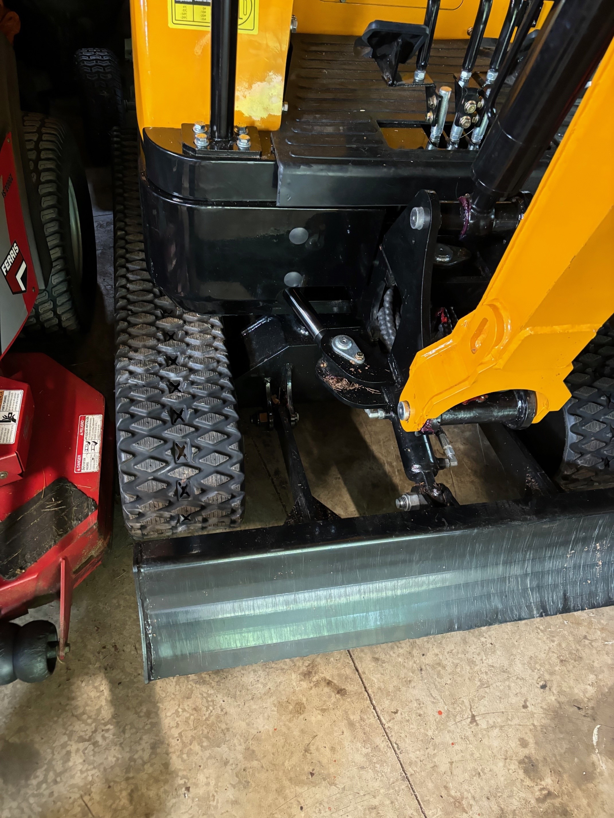

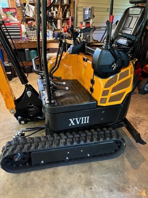

Mods I did to my Terror 18
- 230 MM Turf tracks to replace the 180MM stock tracks ( the XIX comes with 230MM tracks)
- Reinforced the thumb with 1/4" steel braces - (XIX is a different design - may not need this)
- Added a Tach - XIX has a tach in the standard display
- Added an inline oil return filter - I think XIX has one in the tank
- Reinforced between the drive motors and to protect them from rocks - (XIX has enclosed motors)
- Moved/added an Aluminum foot control for the thumb - it was too close and not easy to operate
Then the things I wish I had, the relief valve and brake on slew motor, better hydraulics and pumps, more drive speed, but they cost too much and involve too much to change.
