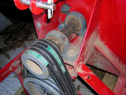

The drive shaft that connects the gearbox to the feed roller is the area where alot of people have had problems. Unlike a regular driveshaft with u-joints, this one has "ball ends" that swing around inside of a socket. There are several great articles on this, here are the key takeaways I got out of them.
1) Remove the driveshaft and make sure they swivel freely, otherwise you will need to take apart and remedy.
2) Rotate the little clip in each socket with a punch and hammer so that the gap in the clip is not in-line with one of the ball ends
3) Drain the gearbox and re-oil while you are there ( I used about 50/50 mix of 90/140 gear oil and Lucas oil additive
4) While the gearbox is out, replace the original belt with a good one ( i.e.) Powerated Gates or equivalent
5) Each end of the driveshaft has a hole in it. Several people ( including me) have tapped this hole and put in a set screw or bolt to keep the shaft ends from popping off ( the spring is supposed to perform this but no harm in adding more protection)
6) When re-assembling, make sure not to overtension the belt - better to slip than to tear something up.

Next came all the per-use checks. Checked all the zerks, and they were there. A couple of them even had covers for them. All of the bearings on my machine only have one zerk fitting. This is different from other instructions and posts in this thread. The bearings look the same except the number of zerks. I operated every part that was involved with a bearing by hand and then greased again to make sure each was properly greased.
Took the feed roller shaft out as noted in this thread and inspected it. I did notice there was a gap where there was a cut out right where the end of on of the c clip was installed. I moved the c clip to eliminate the gap. Other than that, the unit looked in good shape.
Belts were all tight except one of the center belts seemed a little loose. Not sure how that can be tightened if all the others are snug. I decided not to replace them at this point. Will see how they do.
