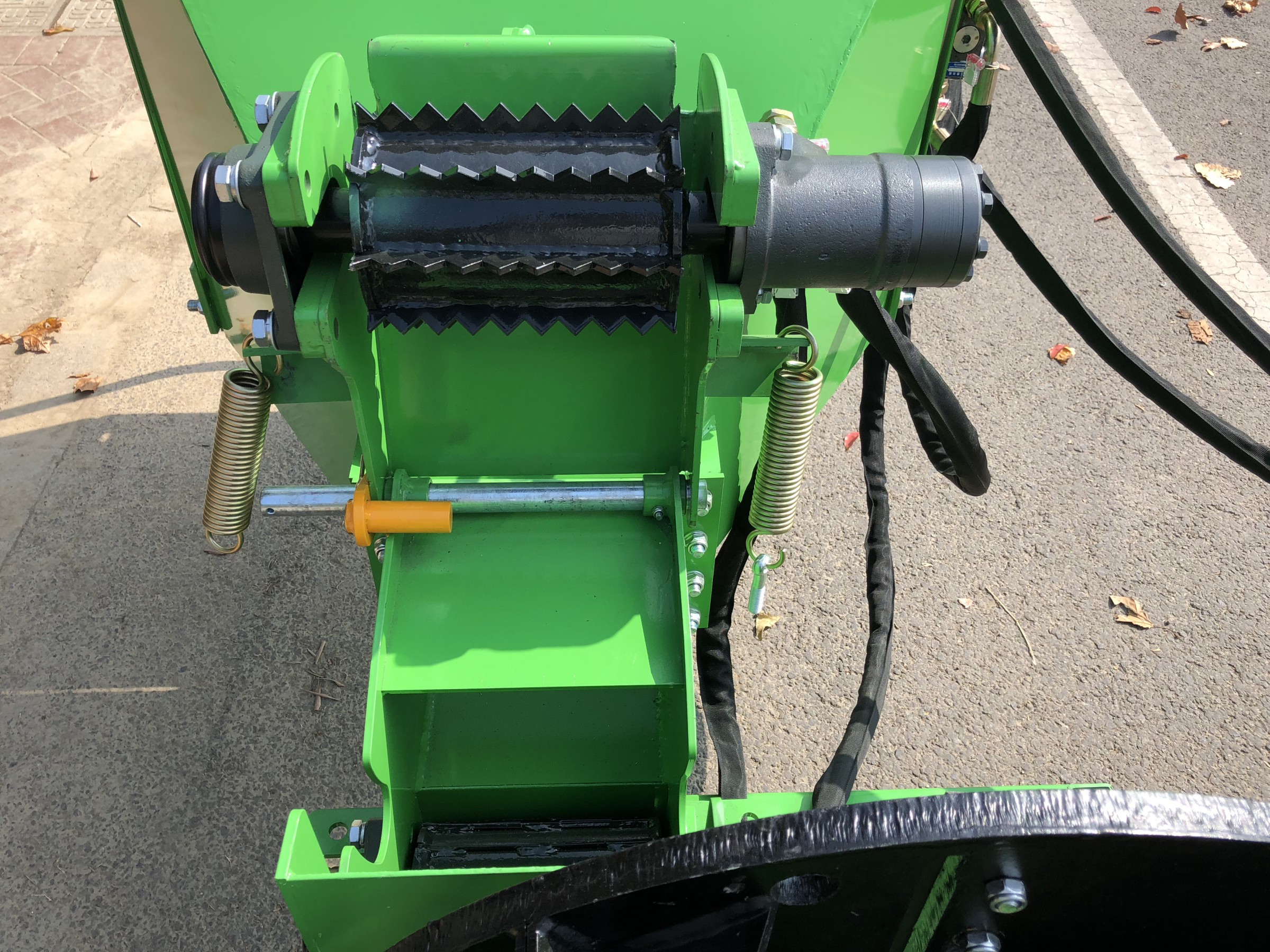

I致e run large commercial chippers down to small self feed units. I own a chinesium 8 inch PTO chipper with power feed.
1. If I had a huge amount of chip work to do I would recommend renting a large commercial self powered unit.
2. I would only recommend hydraulic powered infeed with a minimum 2 powered rollers. Single roller units suck less than non powered infeed units.

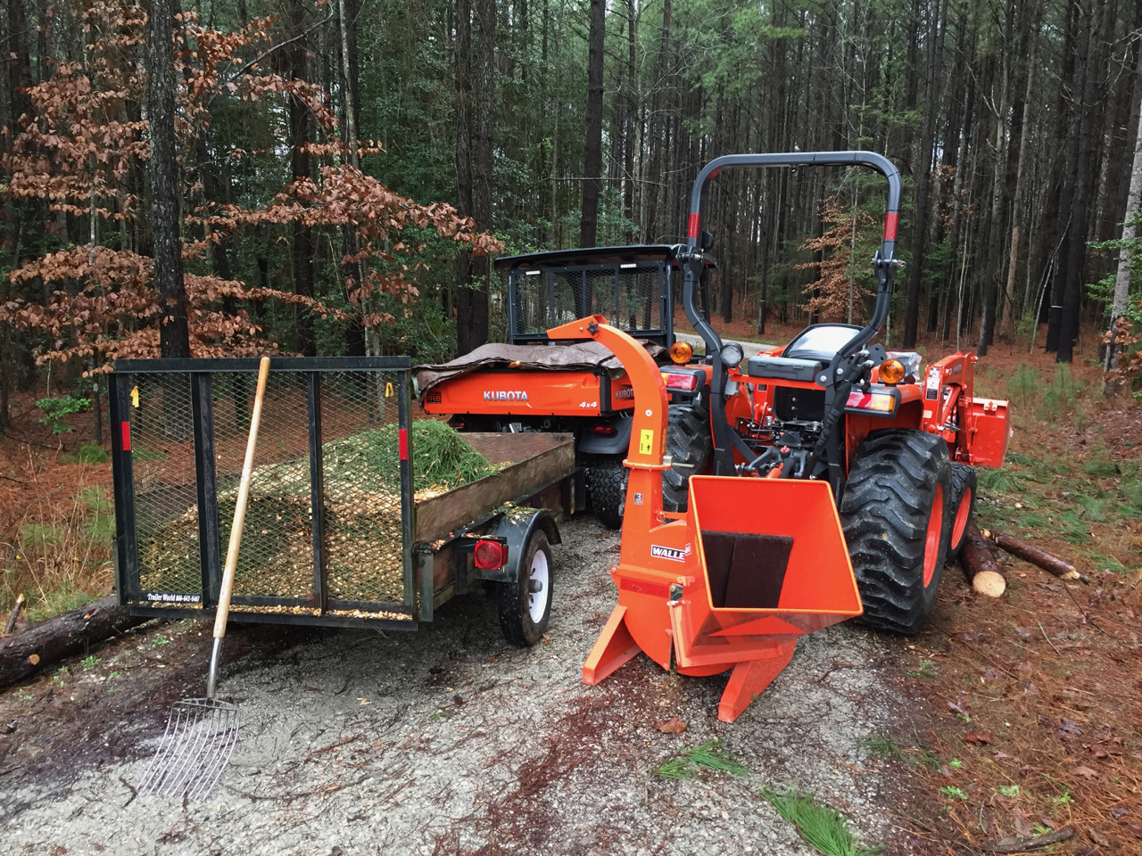

I have a Wallenstein (BX-42) that has been great. But I find myself often deciding when a job is big enough to justify hooking it up and running it -- both because of time/resources and because having it on the back of the tractor takes away from other tractor capabilities. If I am clearing a section or doing 3+ trees, it's worth bringing out. Anything less than that and I am likely to just dump the brush into a pile somewhere. You may also want to factor in access, and how close you can get the chipper to the brush and limbs.
If I have a use for the chips somewhere different than I am chipping, I will do this:
I've also done this right into the back of the RTV (dump bed!) or pickup truck. It makes a huge difference to be able to move the chips to where they are needed. If you have to manually put them into the tractor bucket with pitchfork, productivity goes down (don't count on scooping them from a pile with the loader, it's not always efficient). So I am either chipping on site where the chips are needed, chipping into another vehicle/trailer to move the chips, or chipping and fanning out piles to leave the chips where they lay.

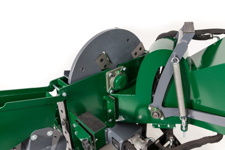

Do your research on chippers, they are not all created equal. Just for your info, here is a roller bearing/roller frame comparison, note light duty v/s heavy duty. Also be sure and get the clam shell type flywheel housing, way easier to change knives then going through an inspection cover.
