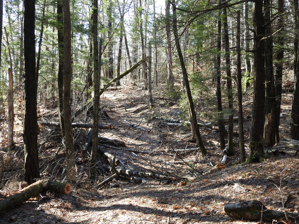

  3. My forest is a mess. I'd like to chip up some of the years' old trees as well. It's all dry wood, though some of it may be closer to rotting and certainly soaked in the spring. See attached picture later. Most of this fallen stuff is pine, I won't feel bad if I have to pass on chipping harder (dry) woods like maple, I suppose. I have a lot of brush piles of small-ish dried branches I'd like to chip/shred, as they are unsightly and taller than I am.
  4. I can use the chips/mulch immediately likely without too much impact for lack of nitrogen fixing, but if I let it sit in a pile to cook for a year or two that is even better.
So is any of the above true? And can I clean up the a lot of this mess that has been accumulating in my forest if I want extra chips/mulch sooner than, say, just waiting for branches from recent falls or logging? There are lots of parts of my forest that look like this the following picture.

With respect to the piles of old punky wood in my forest, would the result of chipping that make for any kind of bad mulch? Or is it all good? Would the the wet old wood (like it is now, after winter), gum up the machine?

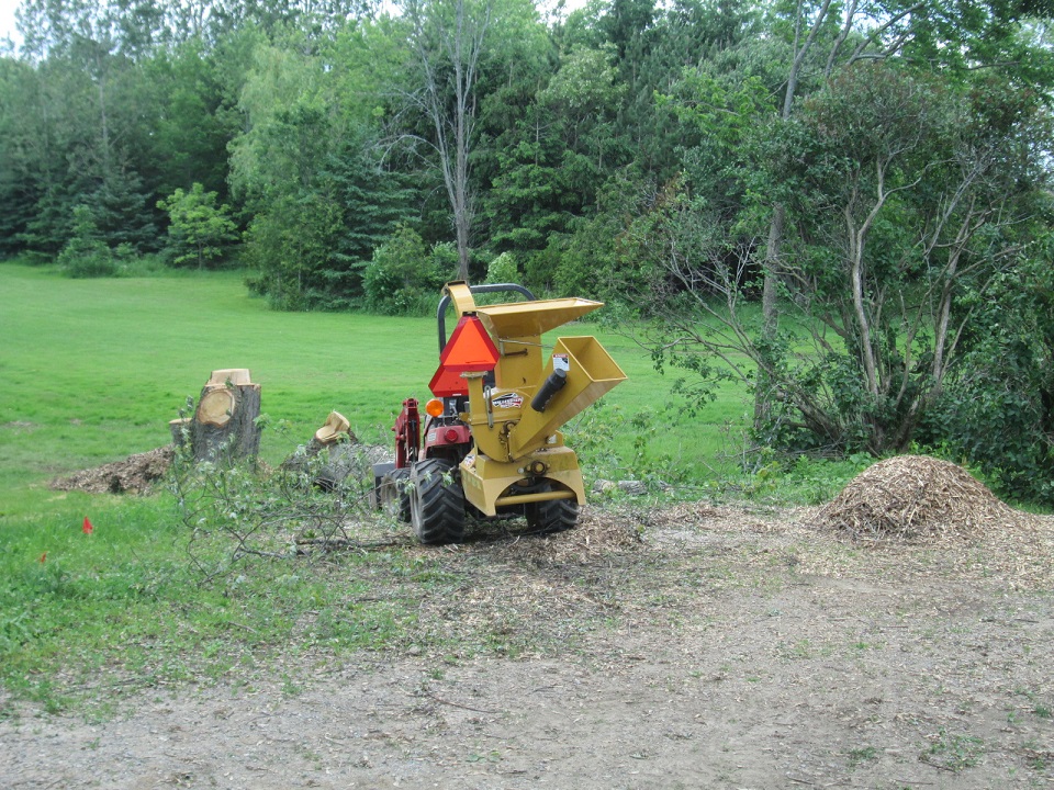

That looks like really fine stuff. What kind of chipper is that? Is that white pine you were chipping?

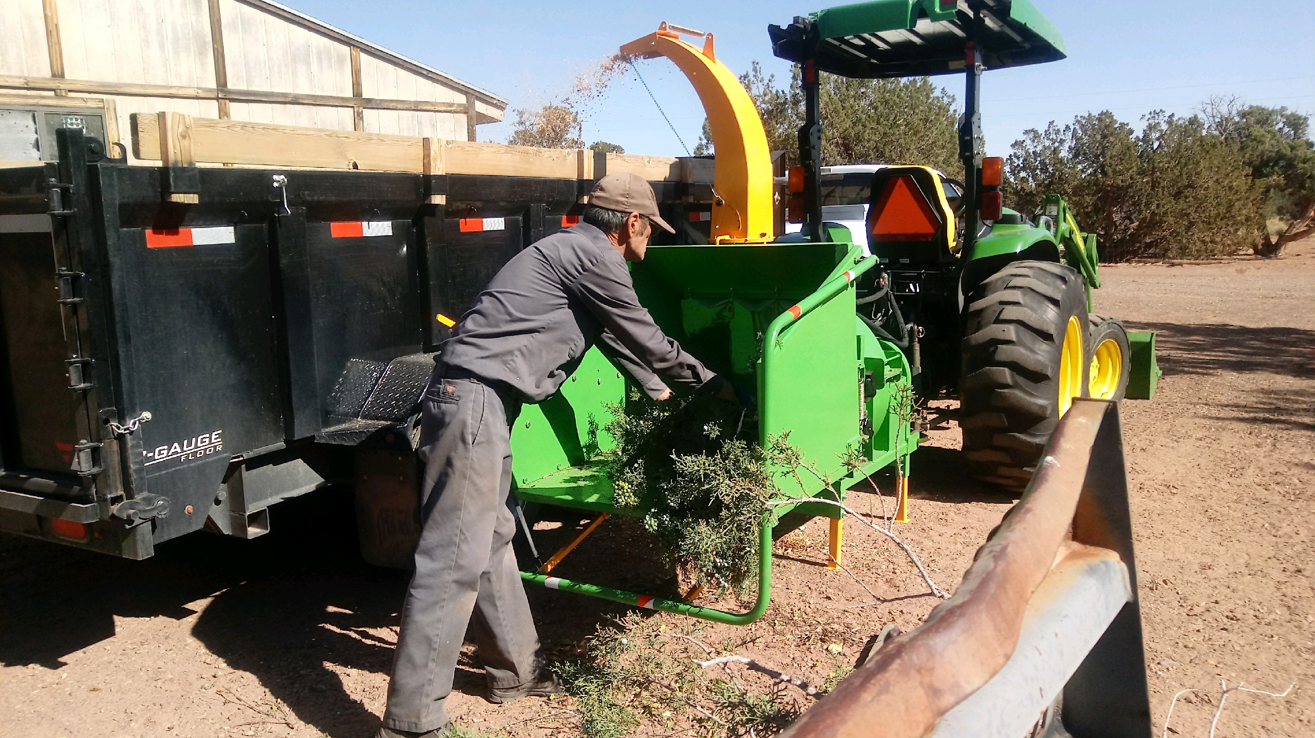

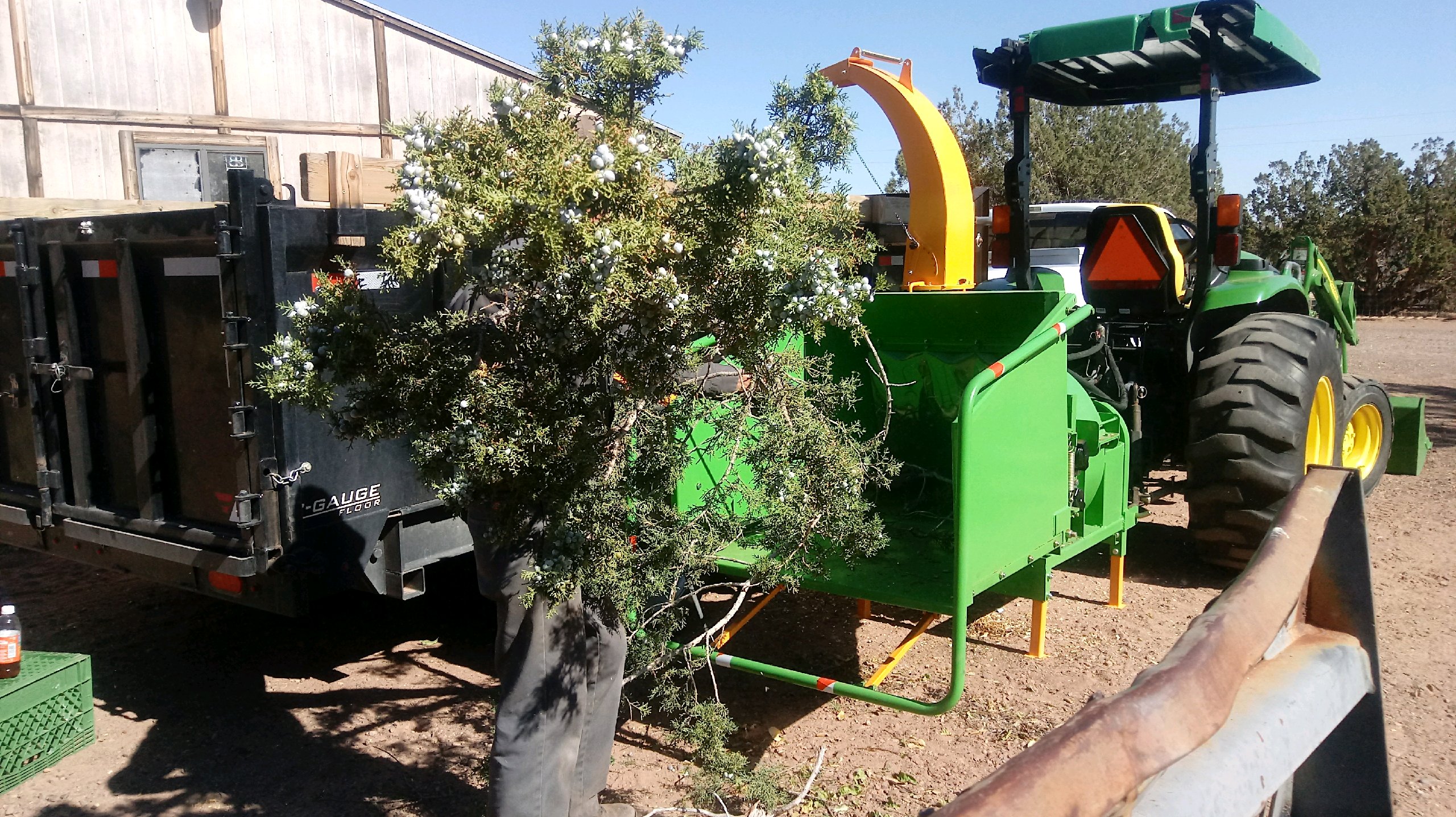

I致e run large commercial chippers down to small self feed units. I own a chinesium 8 inch PTO chipper with power feed.
1. If I had a huge amount of chip work to do I would recommend renting a large commercial self powered unit.
2. I would only recommend hydraulic powered infeed with a minimum 2 powered rollers. Single roller units suck less than non powered infeed units.
3. If you have arms like Popeye and enjoy slinging chainsaws for 12 hours at a time and you think carpal tunnel is the name of your fishing spot then get a small chipper/shredder without power infeed.
4. If you buy your own unit DO NOT feed dirt, rocks, roots etc. Try to alternate between green and dry stuff regularly. Also try and alternate between evergreen and deciduous as tree sap gums things up nicely.
5. Chippers are dangerous, noisy, dusty, and in general bad for your health. They scare me. They should scare you too.
6. Wood chips are great for mulch and gardens etc. I highly recommend it.
7. AVOID cheap chipper shredders, especially chinesium junk. You will spend more time fixing and modding the equipment than chipping wood. You get what you pay for. Remember you are buying equipment by the pound weight. The less it weighs, the less it痴 worth.
8. If you are clever you will separate your materials chipped. I chip cedar for mulch around the house. It looks and smells great. Hardwood like maple apple and oak are my second choice. Be aware if you are chipping green stuff with green leaves the mulch generates a lot of heat in the pile. Pine and junk soft woods are my all purpose mulch and I dont use it near the house.
Bull, most chippers you can adjust the bed plate/knife clearance to chip any size. I have mine set fine because I sell the chips and most people want small stuff. Nova Tractor sells the chipper. It seems to be a good one. I had a small Troy-bilt chipper/shredder, Jinima chipper and a Wood Max wm8m, they were all too much work and high maintenance. This one will chip circles around them. Most of the trees around here are Juniper, they have a loose shaggy bark that collects dirt when the wind blows, very hard on chainsaw chain and chipper knives. I use to burn my trimmings but that is such a waste, I chip everything now that wont make firewood.

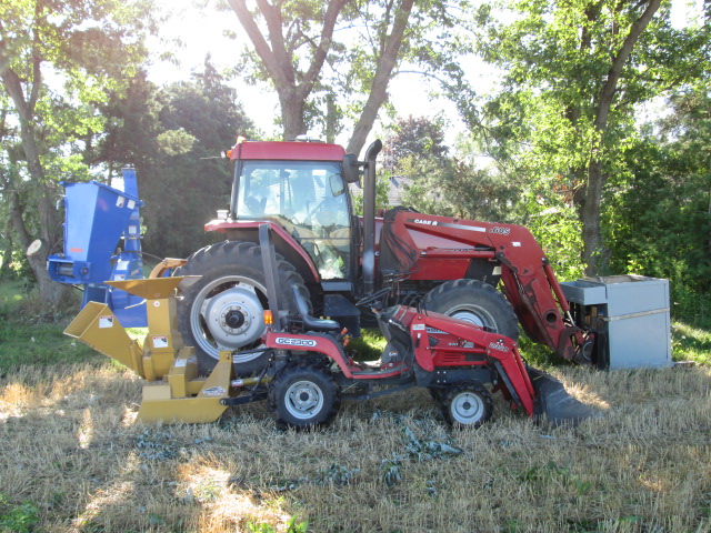

Do your research on chippers, they are not all created equal. Just for your info, here is a roller bearing/roller frame comparison, note light duty v/s heavy duty. Also be sure and get the clam shell type flywheel housing, way easier to change knives then going through an inspection cover.
When I do a large chipping session I use my dump trailer and with a small area with a lot of moving I chip into my Bobcat loader bucket.
