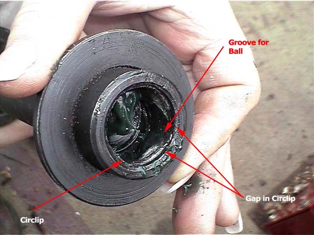

I believe I have found a nice solution for those of us having a problem with the circlip. I have been having a terrible time with mine. Nothing I put in there seems to hold well at all...very aggravating. I took the shaft segments to a friend of mine who is a auto mechanic and also an amateur metal worker. We spent a while discussing a permanent solution to the problem...most of them complex. Then he dumped a jar of misc clips on the table and we picked one out thet looked really good. I'm crossing my fingers but I have two hours on this clip and I have thrown everything I could at the chipper, big and samll and it hasn't budged. (It has never performed that well since I bought it.) I think we have a winner here! Fortunately he said it is a clip used on the front axle of front wheel drive vehicles...on most makes and models he said. I'm going to test some more then track down a source or part number. If anyone is desperate to try it I can offer a bit more information sooner.

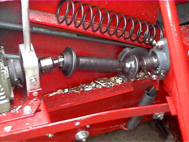

I've been lax at posting my latest finding as well. If the auger feed drive belt is too tight, it will force the drive shaft to slip at the release mechanism. Although mine is now a little rounded, it still works OK. I relieved a little bit of the belt tension and all is well again.
The auger drive belt is a 38 x 1/2.

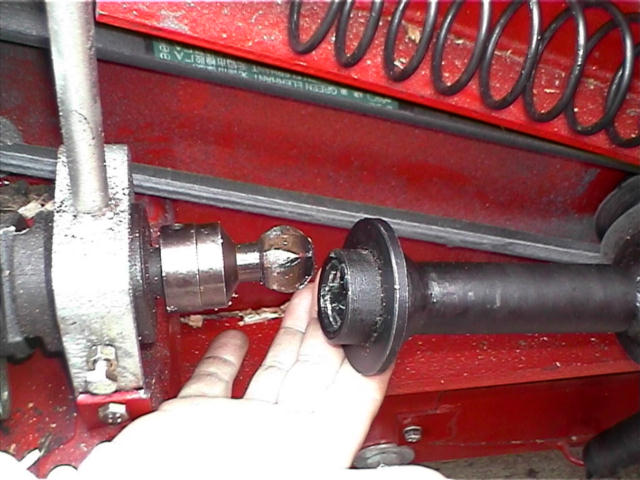

I've been following the discussion about the feed roller driveshaft issues and decided to pull the assembly prior to any problems occuring and see if I could prevent them. I'm glad I did. Pictures are in the next 3 posts.
After removing the driveshaft, I bent each ball in its socket to its severest angle while pushing it in (to simulate spring tension) and rotated it through its full range of motion. The "fat" shaft was extremely smooth. The "thin" shaft was rough and "notchy" feeling. I concluded that the "notchy" motion was going the create an "in-and-out" chattering motion that would "jackhammer" against the retaining ring, eventually causing it to fail. I pried the retaining rings out using a screwdriver so I could compare the differences in the balls and sockets.
Both sockets were almost identical: each had a hemispherical bottom and were about the same depth. The "thin" one had several large chunks/shavings in the bottom corners that I pried/scraped out with a screwdriver.
The balls or "nubs" were strikingly different: the rough one was taller/longer and had 4 sharp edges where it was to contact the hemispherical portion of the socket. I ground the tip of the nub on a bench grinder to the same length as the good nub, but it was still kind of rough. I then smoothed the corners to mimic the corners on the good nub. Voila'! Smooth as silk.
After greasing them liberally but before installing the snaprings, I tested again and discovered each of the 4 possible positions of the nub in the sockets felt different with one position smoother than the other 3. I rotated the nub to the smoothest and snapped the rings back in.
I hope my little "re-engineering" helps keep my downtime to a minimum and helps those of you who have had problems.
