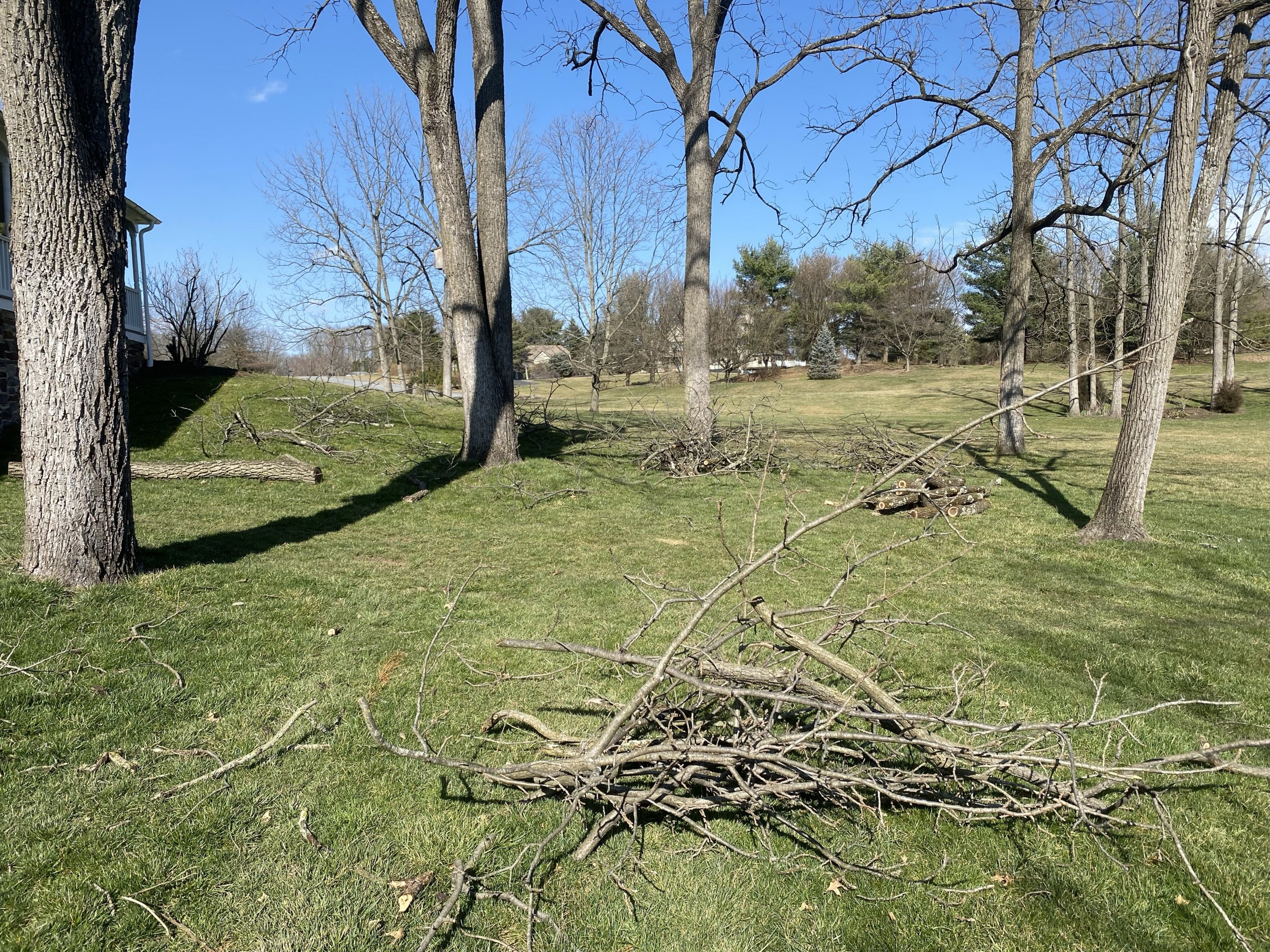

Lots of great info to chew here, although with only 4 acres, I'm not probably generating nearly as much material as most of you with these larger units. My biggest "burn burden" is green stuff coming out of flower beds, which for annuals can still contain the potted dirt they came in. I do have a lot of tree branches, but I'm only discarding the 1" - 3" diameter stuff. Anything much smaller just gets mowed over, and anything much larger gets cut and stacked with the firewood.
This probably pushes me more toward a chipper shredder, than a standard chipper. That said, I do see the advantage of hydraulic feed, especially if it will suck in a widely-forking branch. For example, this group of piles was one of my several chores yesterday:
So, to redirect a biit:
1. Any smaller (< 4" max) units with hydraulic feed?
2. Any type of unit that's more adept at handling green leafy stuff, possibly with soil still stuck to roots?
Maybe this is more a question for a gardening forum than a tractor forum, although they'd have no clue on 3-point options, if such a thing even exists in this class.

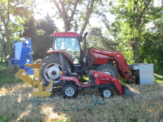

I have 6 acres, but only need to chip the smaller stuff on about 2 acres, the rest stays in the wood or is firewood.
I have a small chipper/shredder which I pull around with a lawn tractor, the SCUT I have is used for bigger stuff.
I use a 4 wheeled cart and either move it by hand or by lawn tractor.
I use a grabber to lift.
For bigger stuff, I use forks or the BH with thumb to move them to be bucked or stacked.
I have a lot of dead ash and autumn Olive and find with my small area, the little chipper works fine up to about 3"
If I need bigger stuff chipped, I call a tree guy I know. Still working those big chip piles into my trail.

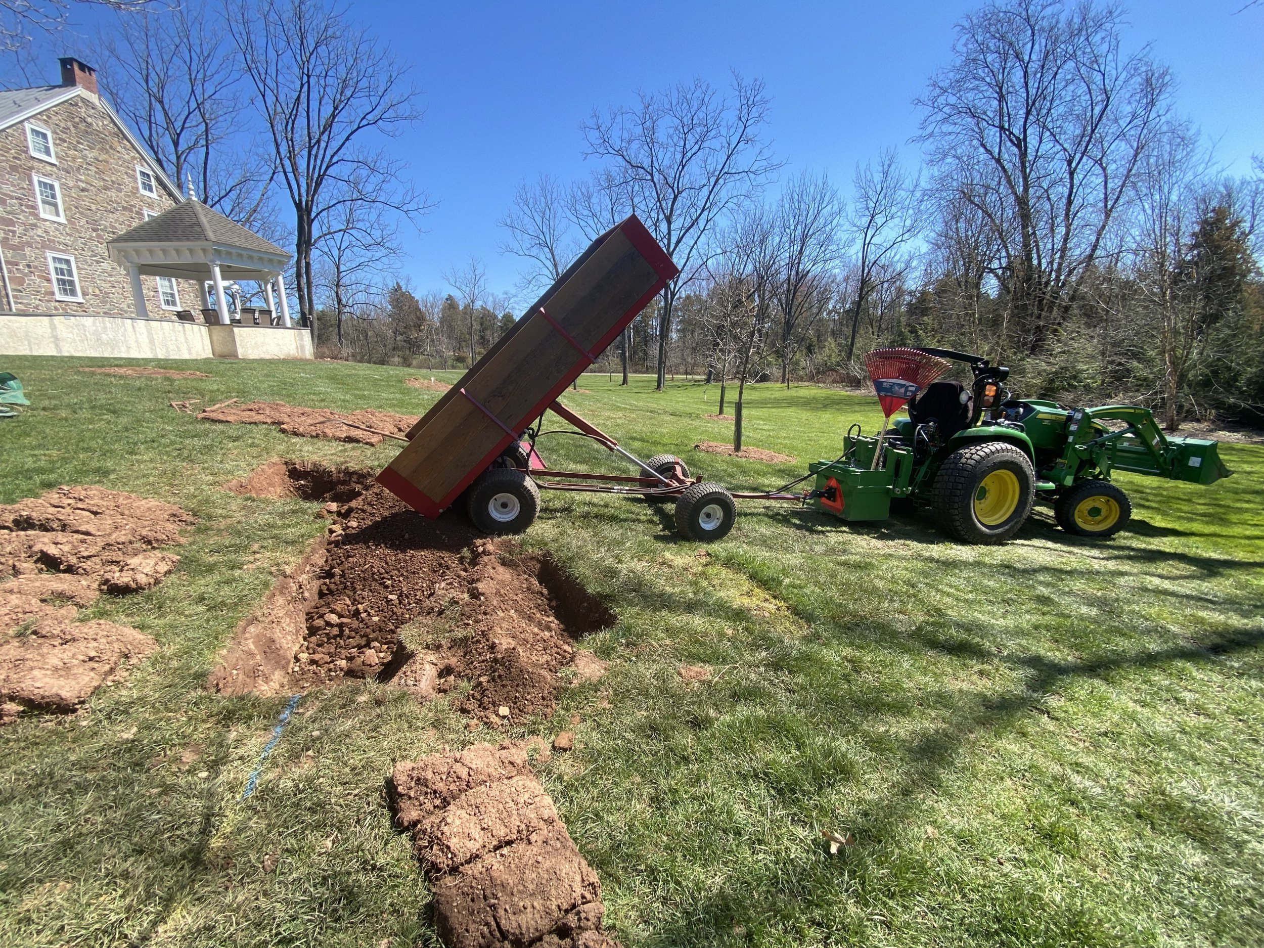

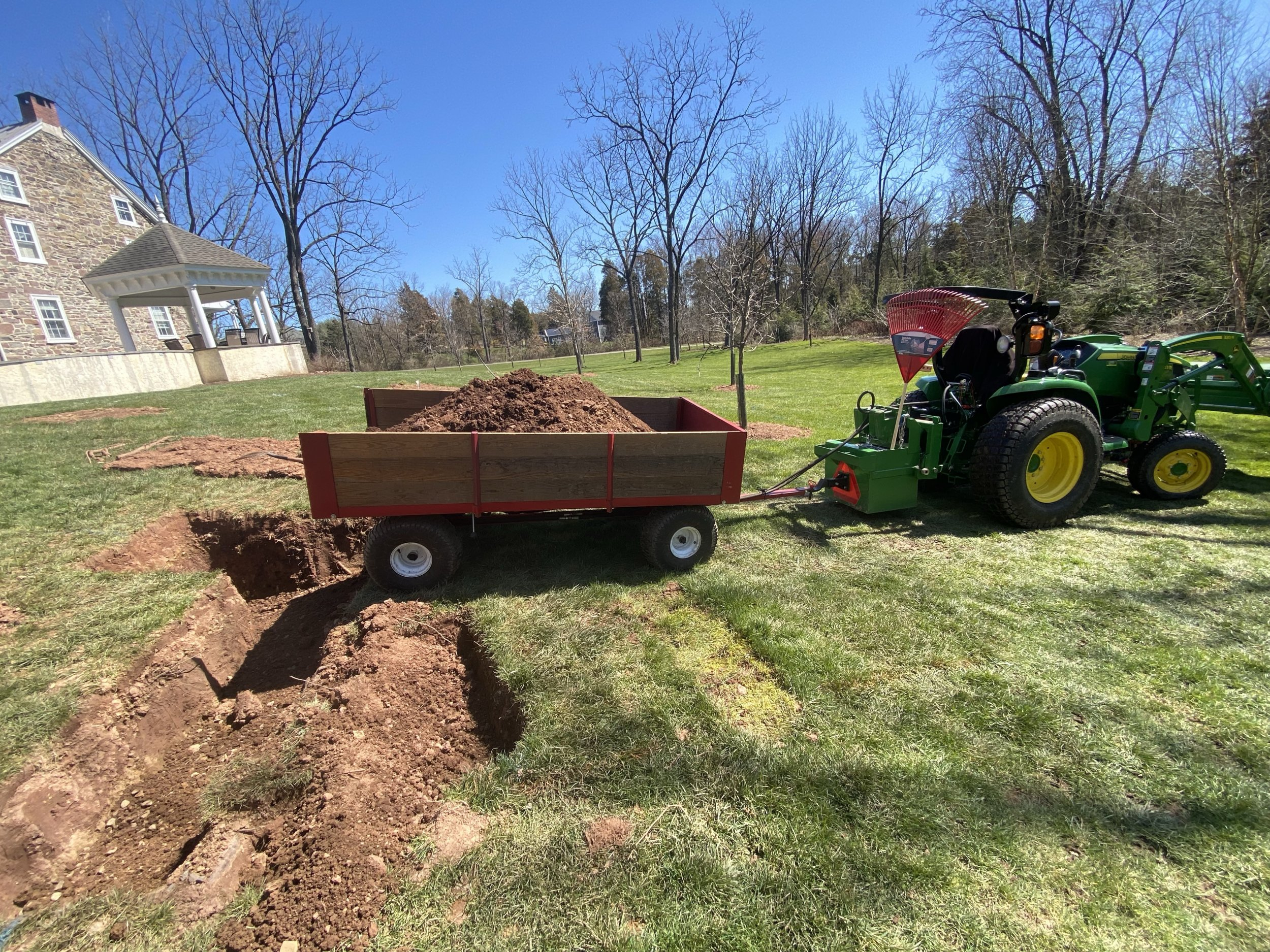

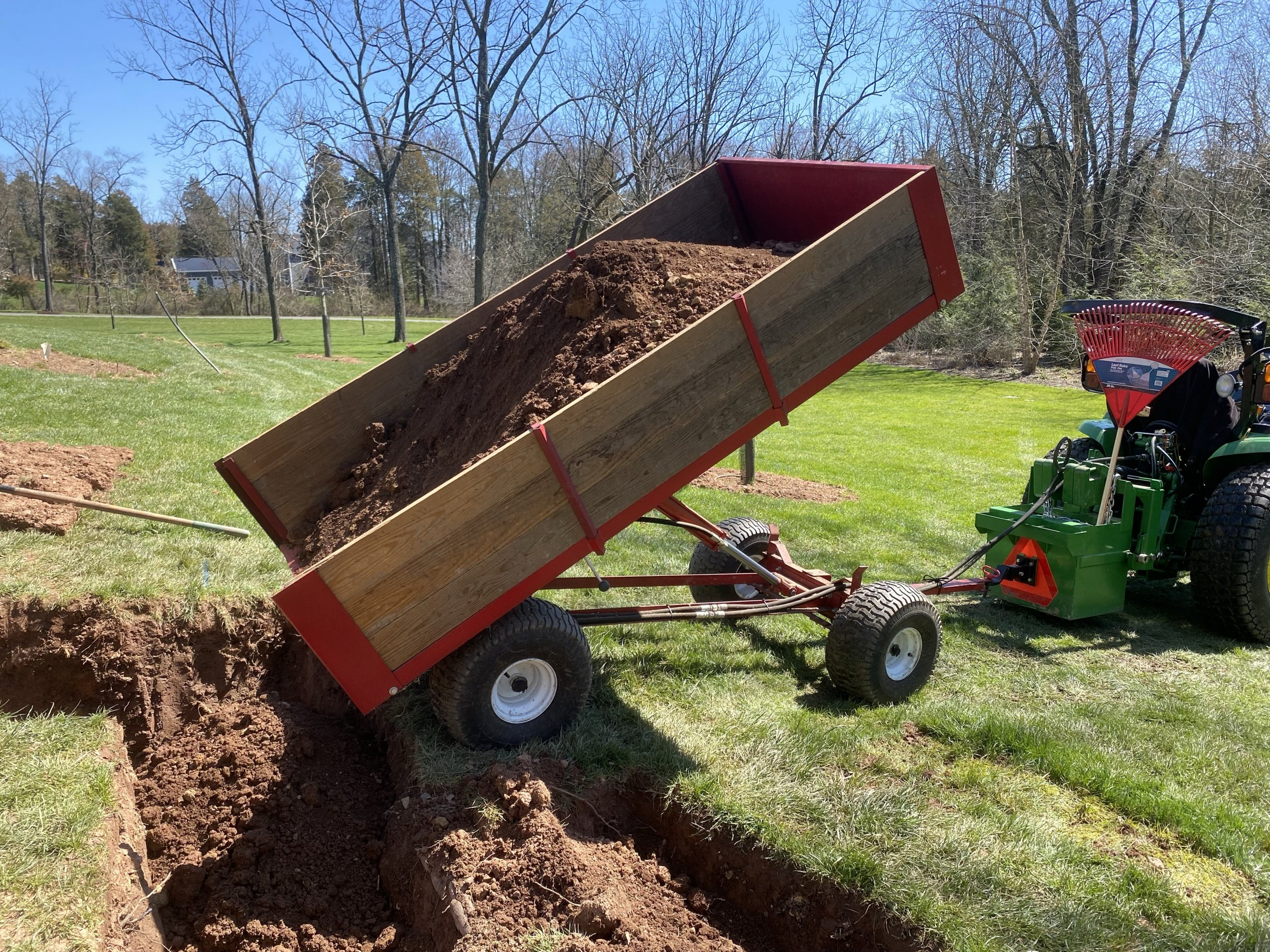

That looks pretty handy. Is it a home made rig or store bought?
A bit of both. Bought the trailer from Country Mfg., and added my own cylinder, valve, lines, etc.
It's a nice setup, though. Comes pre-configured to accept a cylinder, and the amount of repair or modifications it's needed over the years has been pretty minimal.

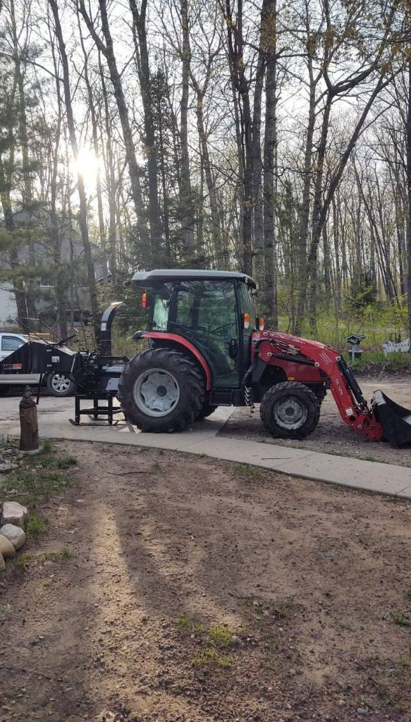

I have a Woodland Mills 8”, their largest unit on a JD955. Use it exactly like you do, and it works great. Very well built unit. Not sure about Woodmax and others, but whatever you do get a bigger throat like at least 8” and hydraulic feed.
