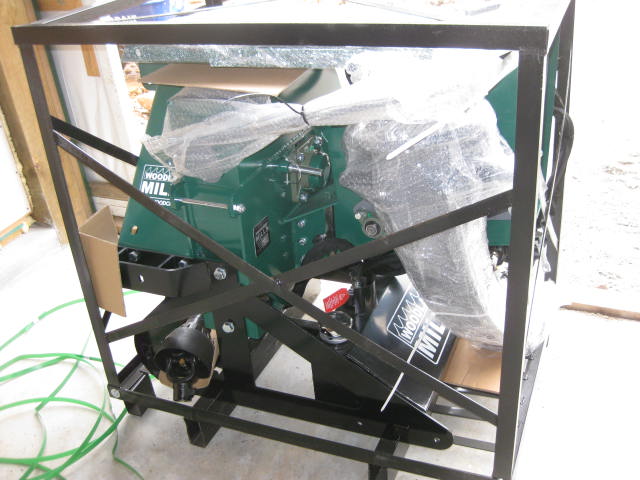

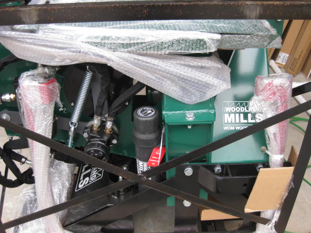

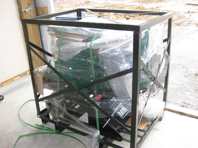

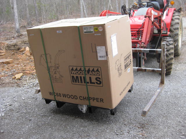

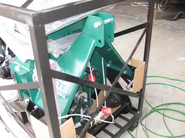

My new chipper arrived this afternoon. Pretty fast shipping, I ordered it on Friday and got it on Wednesday. The unit was well-packaged, nicely protected. It's the end of my day, so assembly will wait til tomorrow. A couple of pictures are attached.IMG_3109.JPGIMG_3110.JPGIMG_3111.JPGIMG_3112.JPGIMG_3113.JPGIMG_3114.JPG

I removed the packing material this morning. The entire package, as shipped, weighed about 850 pounds. I think about 250 of that was bubble wrap and plastic!
Everything looks good under the wrap.

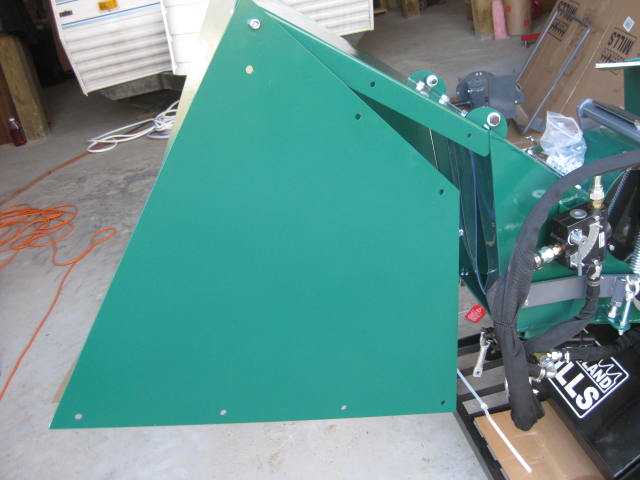

I spent half an hour putting the in-feed chute on. The side panels are a little heavy for one guy alone, but I just hung them from the far bolt and then rotated them into place. I'm building a new house, so my time to spend on this is pretty limited, but I'll probably finish it tomorrow.IMG_3115.JPGIMG_3116.JPGIMG_3117.JPGIMG_3118.JPGView attachment 644087
