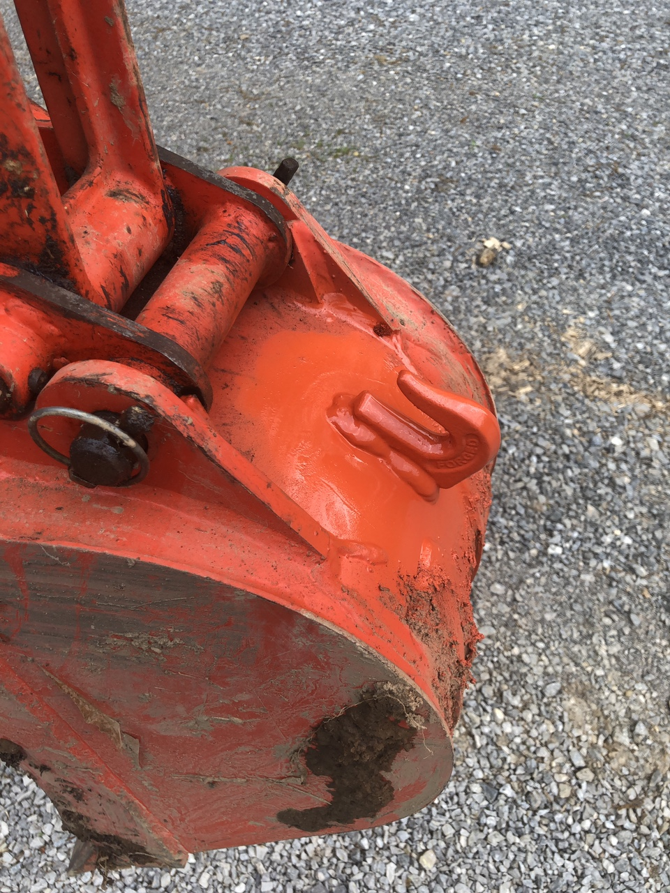

I had my dealer weld 3 hooks to the bucket before I took delivery of my L2800 HST. Have been that tractor with those hooks for about 15 years pulling trucks out of the mud and every other task I can find for them. Best accessory I bought.

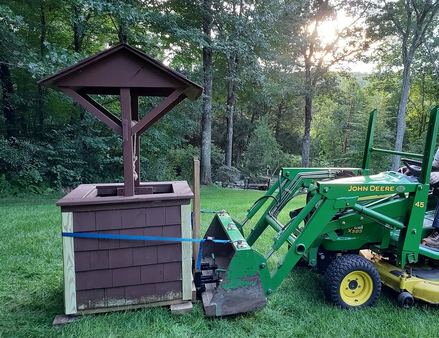

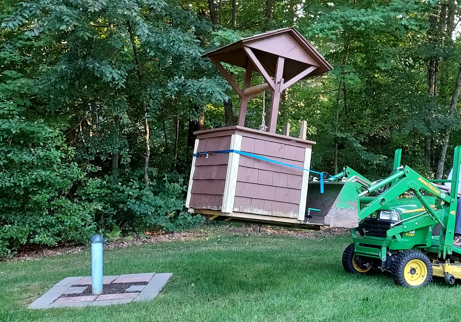

Thought I'd post an example of using bucket hooks with forks. I had to move our wishing well over our septic candy cane pipe for repairs. These are from when we put the well back into place before repainting it.

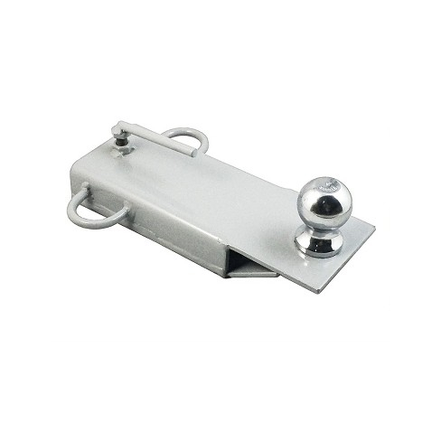

Seems like someone could fabricate someone kind of hook or chain stop that would slip into the notches on the pallet fork frame?
Something like this could be made to use a chain on the fork:

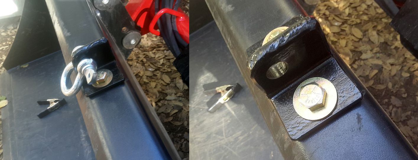

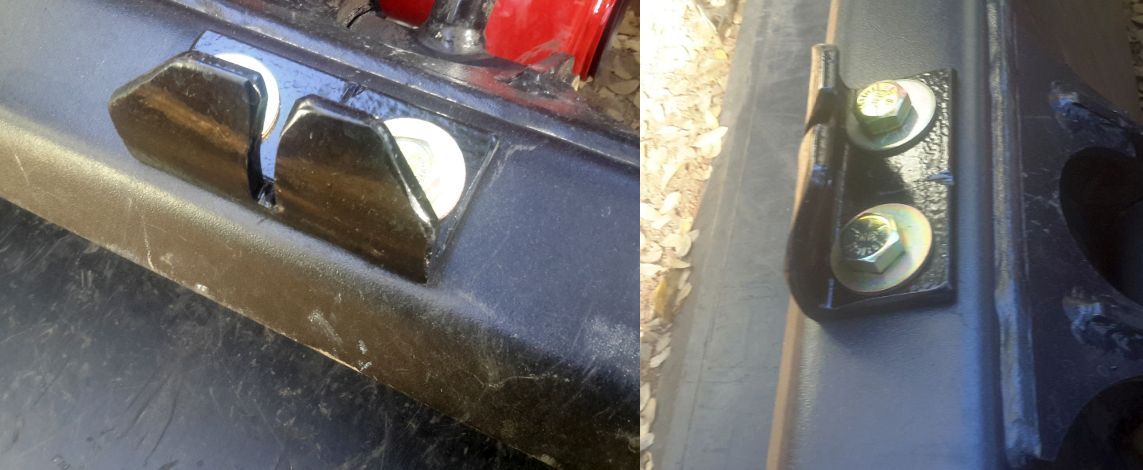

Hooks or chain slots on bucket are most useful thing I did to grab/hold/lift things...
bucket-jpg.684518
slots-3-jpg.684517
eyes-3-jpg.684516
The chain slots were just fabricated from some 2 X 2 X 1/4 inch angle iron... The shackle eye was from same angle iron just welded back to back...
Very nicely done. Glad you used Grade 8 bolts.

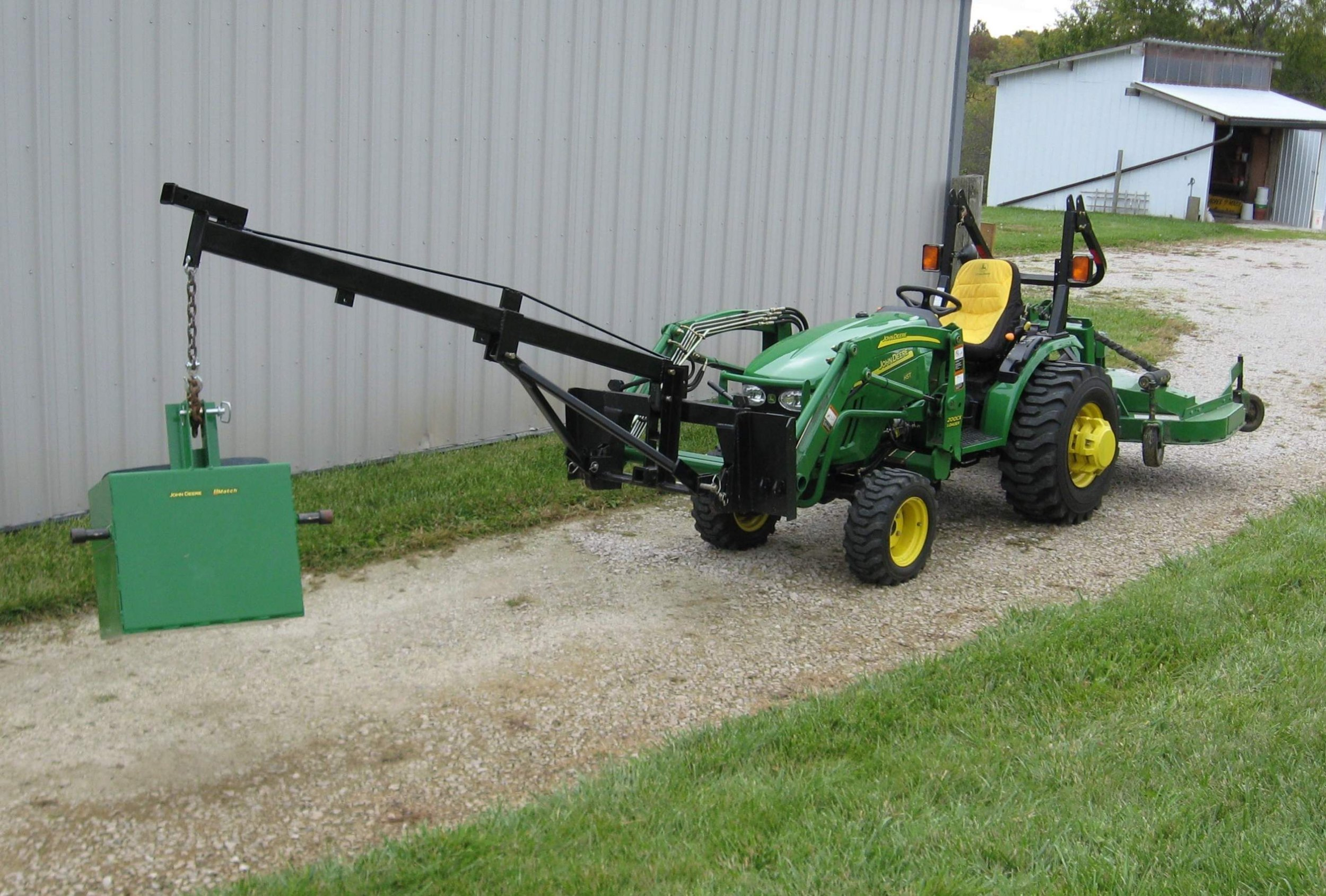

I did not read all the previous comments, so this may have been mentioned before. I have a 2" Trailer Receiver Tube welded to the middle of the top lip of my bucket. Allows the use of 2" receiver with chain hook welded on. Also allows use of 2" Receiver with ball size as required. Handy for moving boat / trailer etc. Quick change.
Also have pallet forks, which I find invaluable. One instance where chain on pallet forks could be used (so far I have just used rope) is for planting trees. Spread forks apart and tie rope / chain to each side of large root ball, one rope to each fork & it is very easy to lift the root ball / tree and set in prepared hole.
The Boom in the pic is more elaborate and stronger, but something similar can be made by inserting the upper tube for a boom in the receiver tube and running supports to the lower lip of the bucket.
