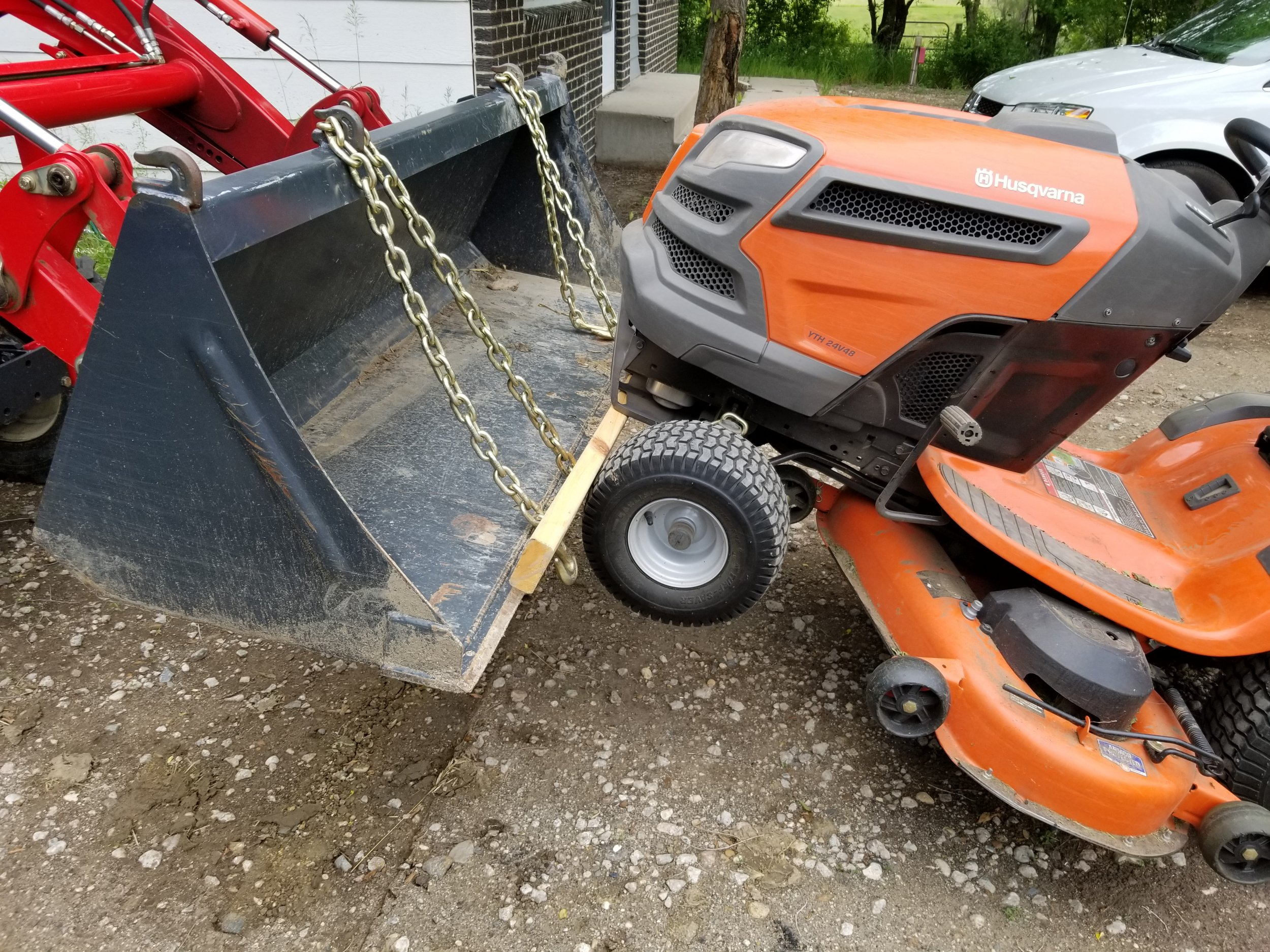

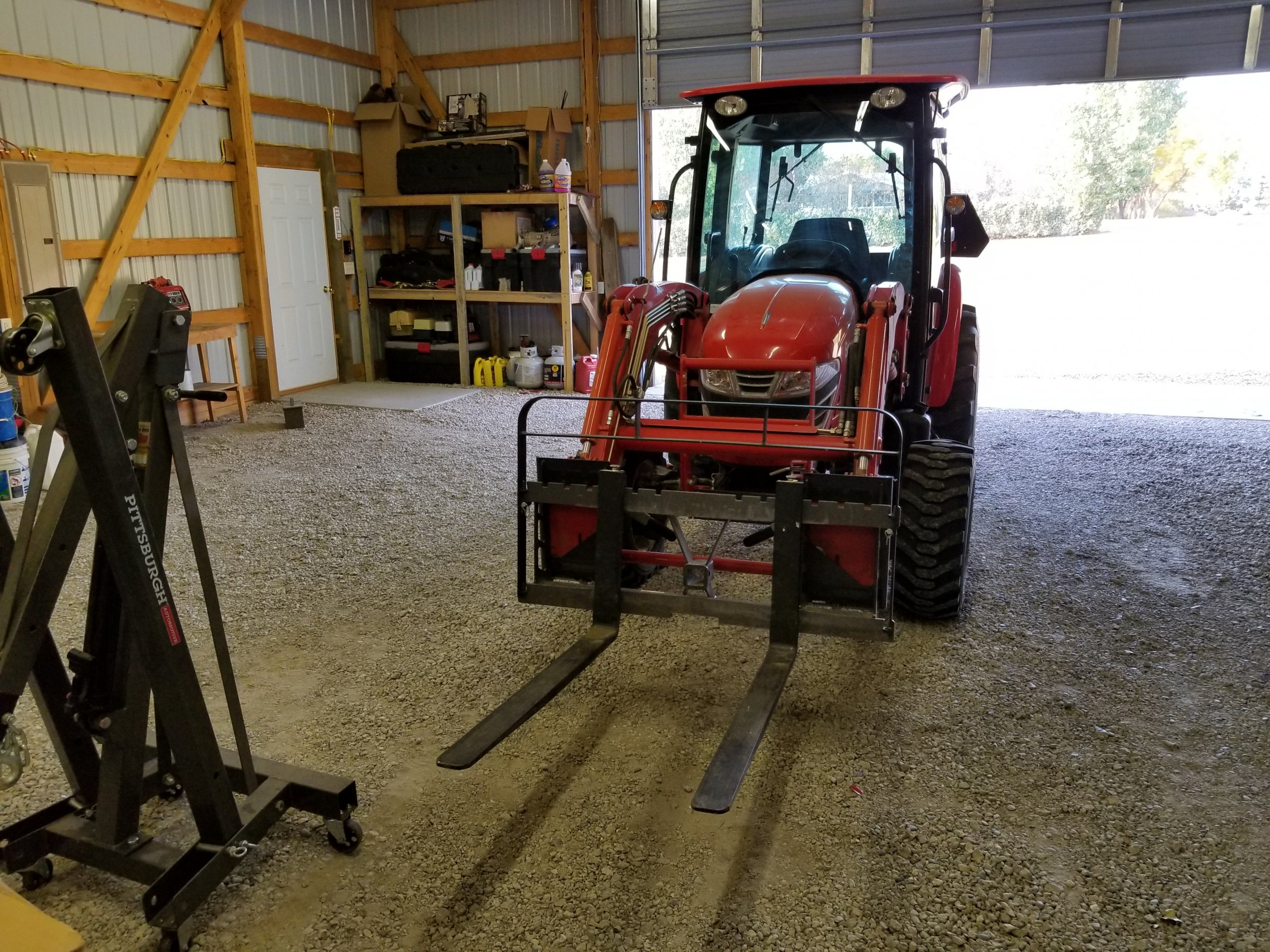

I've got 4 hooks welded across the top of my bucket. They come in very handy in having multiple grab points vs. what I'm trying to lift.
I also use my forks for various things, but if I'm sling-lifting something, I prefer to have the fixed point hooks on the bucket. Less chance of anything moving around vs. wrapping a chain around the back of the fork frame. It really depends on what the object is I'm trying to move.

A bucket without hooks is like a hand missing a finger. You could get by, but it's so much better to have hooks on the bucket.

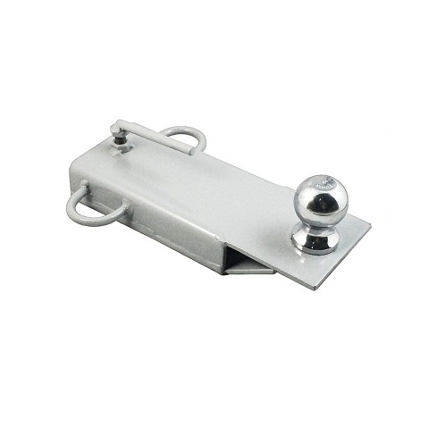

But like one of the other fellas here posted, don't use one placed in the center of your bucket as your main lifting point. My tractor came with a hitch receiver tube, so I just stuck one of those big hooks from harbor fright in there, used that for a while...and it bent the top of my bucket slightly.

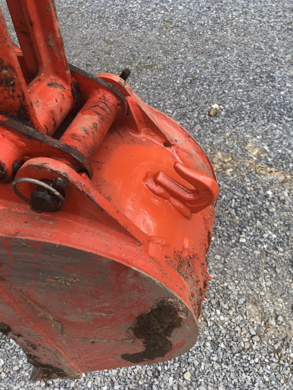

Now I got Ken's bolt on hooks installed. I chose the underside to be clevises....something's gotta serve as the underside backing for the hook, so might as well be another anchor point.

Curiously, why? Can't think of any reason I'd want to remove them.
cleaner install, might also be stronger. I am not a welder, and had the dealer weld hooks on when I purchased it. They did not do a stellar job.
