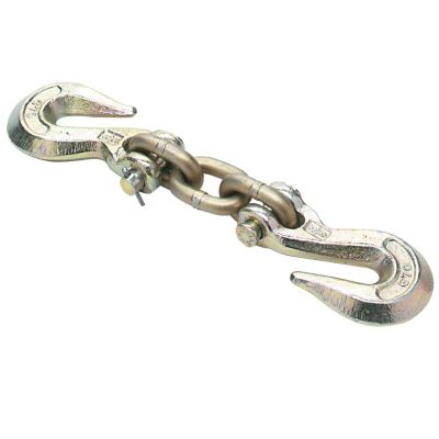

It’s a pain to hook a chain back on itself and make it shorter than half its length. With a hook you can hook it anywhere. It’s worth the effort to mount one IMO.
Chain shorteners are easily made. Buy 2 grab hooks that match your chain size, put a short length of chain between then (I typically do 2 or 3, keeps it short). You can now hook the chain to itself at any length you wish by grabbing the chain link you want. Your chain could be as short as 6” or so and have a 20’ + long chain.
   / Chain hooks on Bucket or just use pallet forks? (For misc chain hoisting) #14
YEs easily made from a few links of chain and hardware store hooks.... I made mine on cheap instead of paying outrageous online price...
