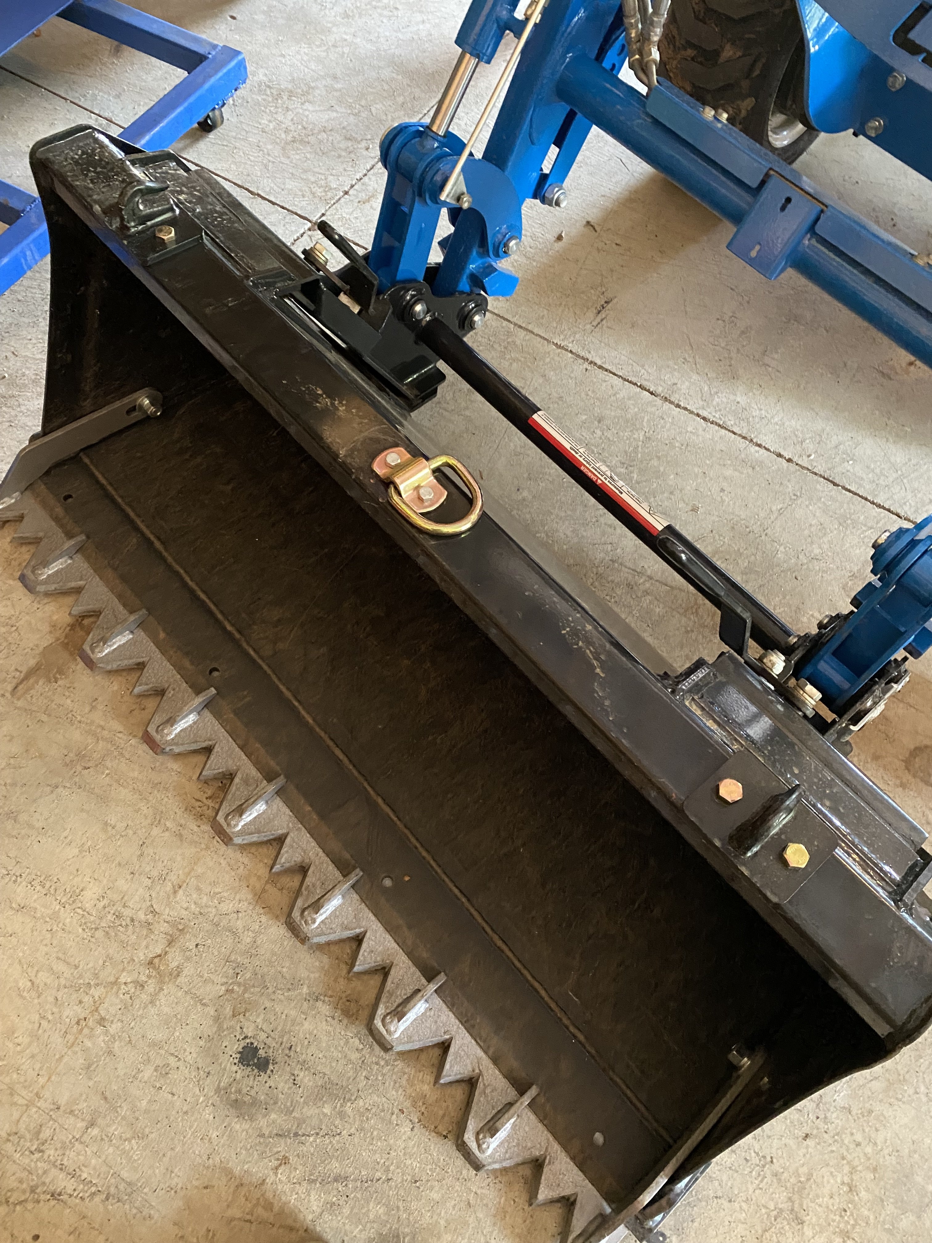

The LS MT225s has turned into my little 25hp "Go To" rig. Decided to install a couple bucket chain hooks on the bucket lifting and pulling. While at Rural King the other day, I found this D-Ring (bolt on style) rated for 10,000 lbs. I fashioned a support plate for inside the bucket under the D-Ring. Tow Strap hooks don't fit in chain hooks. The D-Ring solves that problem and also makes a good spot to tie off a rope or support for carrying heavy objects. Inspire others to do great things and they will.
