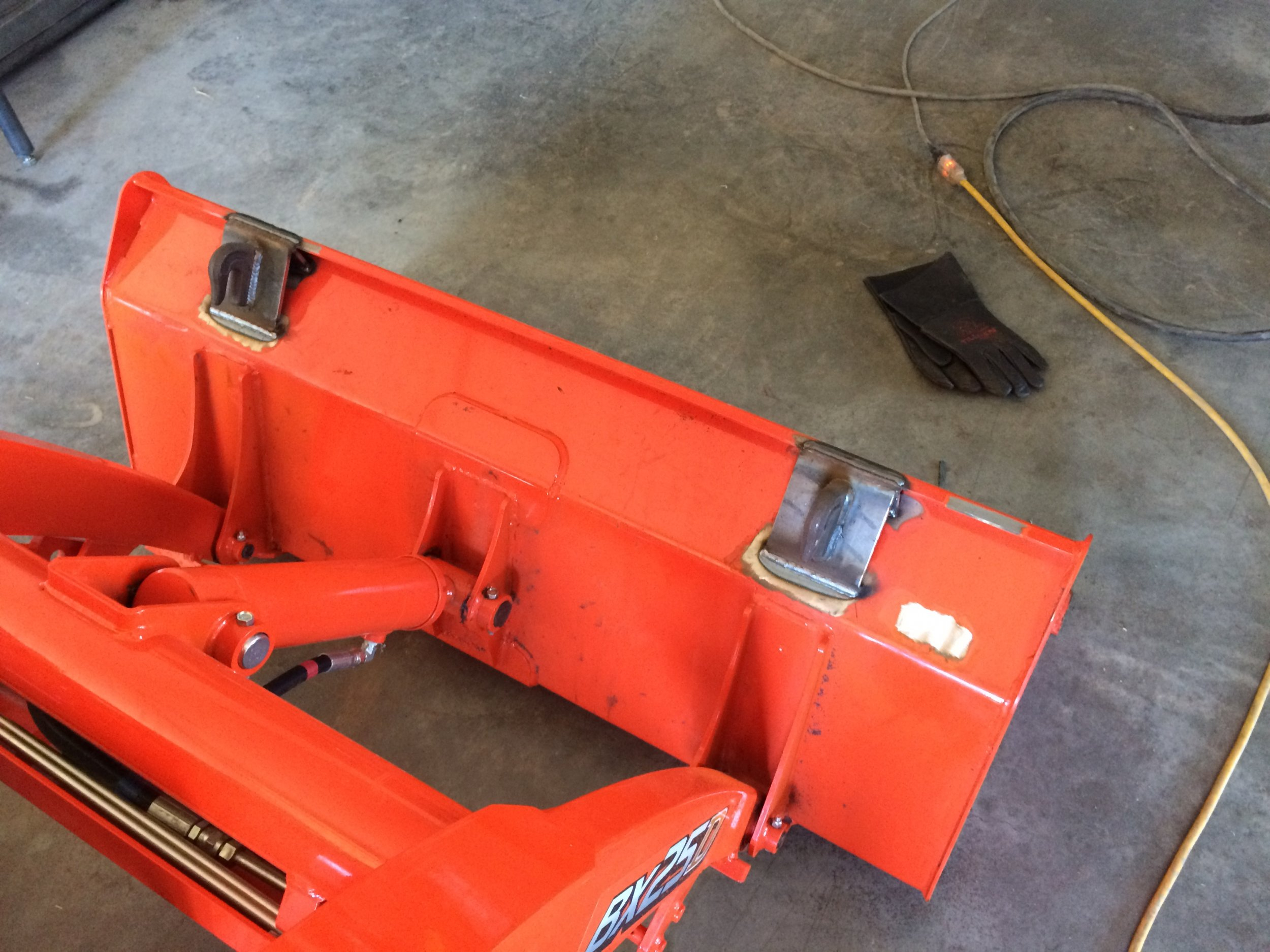

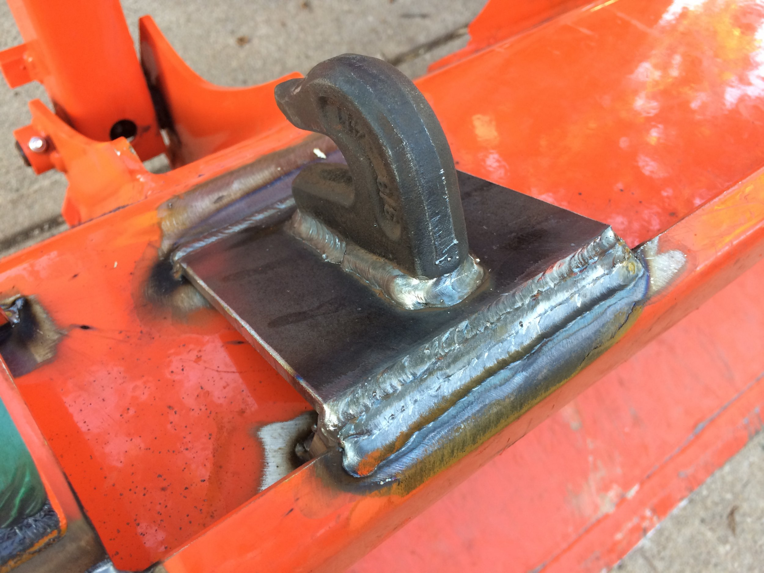

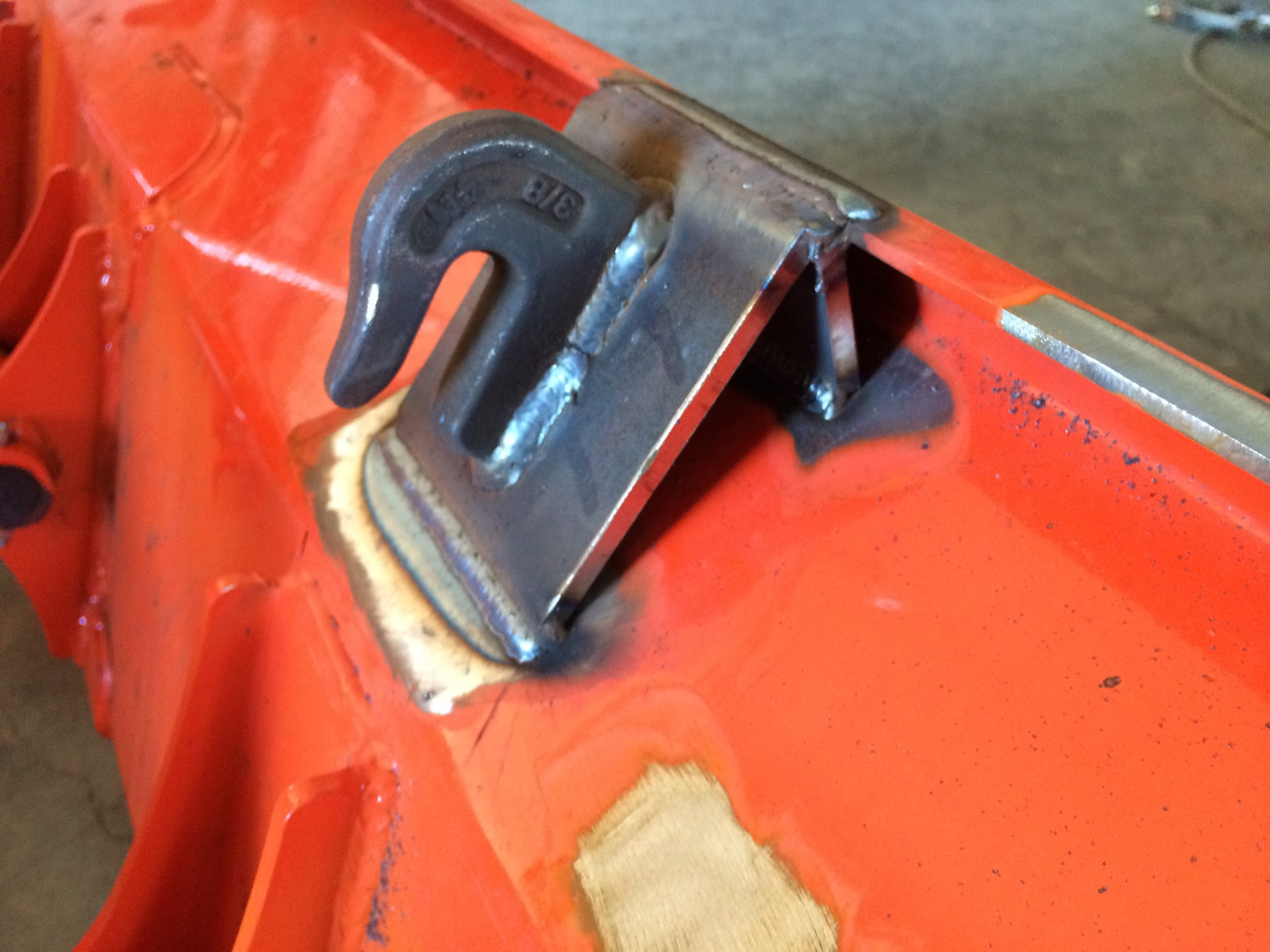

My BX doesn’t have much capacity, but I have found several uses, for my welded on hooks. The BX has a fold, on the top edge of the bucket. We welded hooks onto backing plates. Then, we welded a piece of flat stock behind the lip, to support the edge of the lip and backing plate.

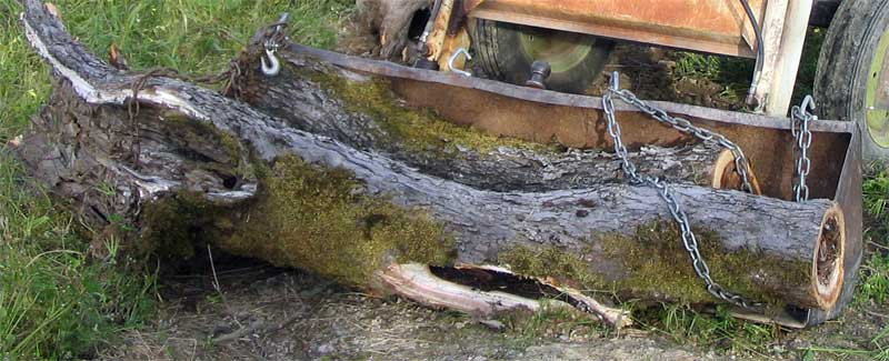

I put two grab hooks on each side of the top of the bucket. When I pile fence rails, lumber or tree branches, I'll first lay down two chains at 90 degrees, the grab hook distance apart. Then I pile the material neatly, and pull up with the tractor. The near chains each go to one of the hooks, the far chains wrap over the bundle, and go to the other hooks. The chains keep it all together while I drive.

Nice welds!

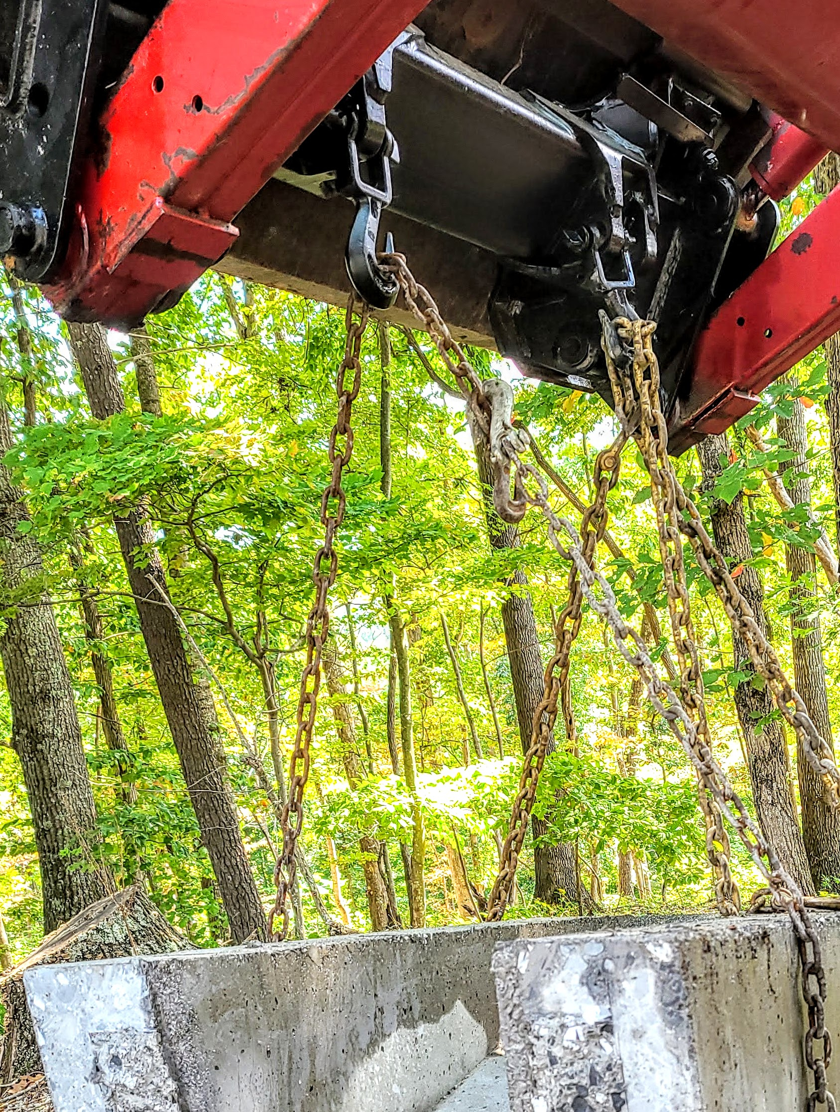

When you want to lift the maximum weight,, and have the most control of the weight,,
the lift point should be close to the tractor as possible.
I have hooks on the bucket, but, I also have hooks that liftfrom a point that is closer to the tractor than the bucket pivot.
These lift hooks result in the maximum amount that my loader can lift.
Since the hooks are attached to my QA adapter, I can also lift with the bucket removed from the tractor.

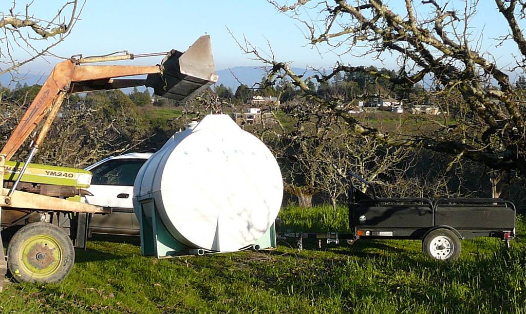

I took the simple approach for a quick-n-dirty one time use. But then I've never replaced this because it simply continues to work. With only about 700 lbs lift capacity on this elderly Yanmar, this is sufficient.
Cold Shuts (chain repair links) that I already had
bolted into pre-existing holes in a bucket that was already badly beaten up when I bought the tractor in 2003. I've never bent anything, hook or bucket, over 15 years using this.
Initial use - before I had loader forks:
673366-img_3091bucket-logs-jpg.39929
Heaviest lift I've done. Label on tank says 650 lbs and I had to reach over to the center of the trailer to lift it. This didn't bend the Cold Shuts.
