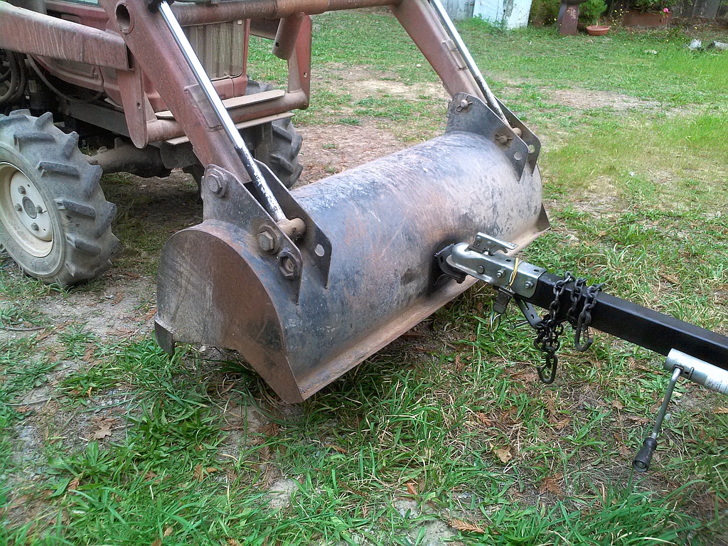

Yes! A hitch ball I added to the other Yanmar. It's low enough to get under a parked small trailer.
kimg2005rhitchonym186dbucket-jpg.511565
If you buy a hitch mount you should buy a forged unit, not a cast unit.
Even though they are both steel, the cast can crack and your load run off with out you!
You should also alway use a safety chain.....

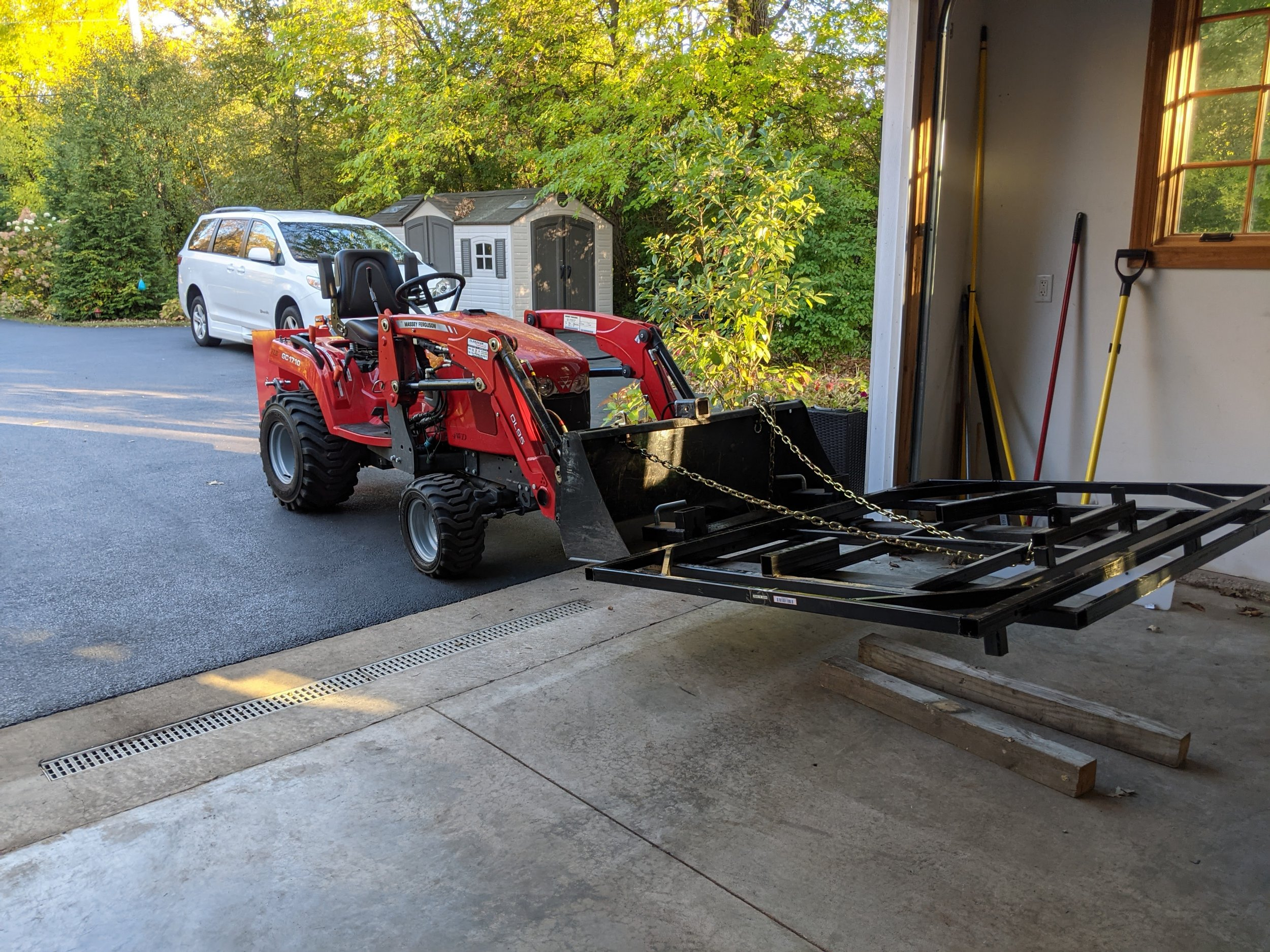

Chain or forks? Why not both?
If you are using the chains to secure - no problem.
If you are lifting with the chains, they should be attached to lifting eyes or hooks - not wrapped around the forks.
   / Chain hooks on Bucket or just use pallet forks? (For misc chain hoisting) #80
You talking in general terms, or responding to my post (since you quoted it). If responding, look at the pic again.
