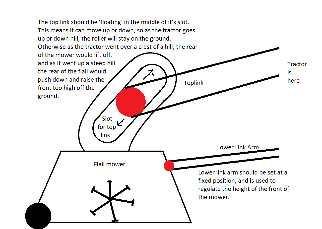

I have attached a picture showing how I would suggest a flail mower is set on the tractor.
The top link is not designed to take any weight or much strain. It is a levelling, and supporting device. On smaller tractors they may seem pretty strong, but trust me, if you saw how quickly a wrongly set top link on a 200HP gets pretzled, and the cost to replace it, you would make sure there was as little stress as possible!
That flail mower in my picture weighs nearly 2 tonnes. It is a great lump and nearly 3.5 metres wide.
There should also be no need to adjust the top link between work and travel. In work, the float should be in the middle of it's travel when on flat ground. Then when you pick the implement up, the top link will 'float' to it's extreme position and the rear of the flail will then lift off the ground.
As for the problem of the roller scuffing when turning - that is simply cured - drive in straight lines, and lift it up at the headlands to turn, do a 180 and go back again.

You either don't have a floating toplink bracket, or don't understand what it's for. When adjusted for the mowing position, there is no "stress going through the toplink" - and it is excellent on hills. In fact, my property is ALL hills.
Look at the photos below. This particular style of flexible toplink bracket locks in the upright position. The left photo shows the transport position with the toplink shortened until the bracket hits its stop. At that point, the implement is picked up for transport. Now look at the right photo, which depicts the mowing position. Note that the toplink is lengthened, rotating the bracket back to the 45 degree position. Now when the front of the tractor is lower than the rear, the toplink pulls the bracket forward. But it's pivoting on a pin, so the mower deck never moves. Then when the front of the tractor is higher than the rear, the toplink pivots the bracket rearward. But it's only the bracket that moves, not the mower deck. That floating bracket will pivot through a full 90 degree arc, moving back and forth as the tractor goes up and down. Yet the mower deck stays parallel with the ground.
Same principle applies to the floating toplink bracket on my flail mower. I just didn't have any photos handy. The flail bracket is the U-type , and it pivots inside the A-frame instead of above it. Whereas the RC bracket has a 90 degree arc, the flail bracket will pivot nearly 180 degrees. And now that I have a hydraulic toplink, I don't even have to get off the tractor like I did in the past - to adjust the rigid toplink between transport length and mowing length.

Greg G, reading your post again, this is exactly what I am suggesting is the right way to do it. Your bracked works in a very similar way to the slot I speak of.
What confused me, is that you said you put the lift arms into float as well (meaning you lower them to the very lowest position, and they can still ride up).
You can't put the lift arms into float, and have the top link floating, as the front of the mower would just hit the ground and scalp it!

Sorry, but I've never waivered from the positon that conventional rear TPH flails (conventional TPH mowers in general) should have a floating toplink bracket. And at least twice I demonstrated - with photos - the use of said bracket; rigid for transport, extended for mowing. And that there is no stress on the toplink when a floating toplink bracket is used in the mowing (extended) position (I'm guessing those chain advocates - or those who admit to using no toplink at all - either don't have a floating toplink bracket installed, or don't know what it's for). I don't know how I could have made it any clearer than that.//greg//
If this then not this. You are not floating the 3pt hitch as stated and clarified by the OP with your agreement. You are holding the front of the mower up with the lift arms and allowing it to float on its tail wheel by use of a floating top link. [The only difference between using that and a chain is that it limits the amount of free compressive motion.] I think that may have been the root of misunderstanding all along. It may be that I will have to make that clearer. I hope not.

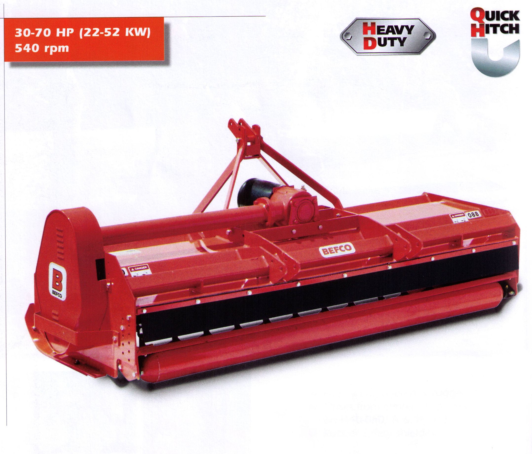

The factory photo below depicts a flail with a 180 degree pivoting U-type bracket
//greg//
