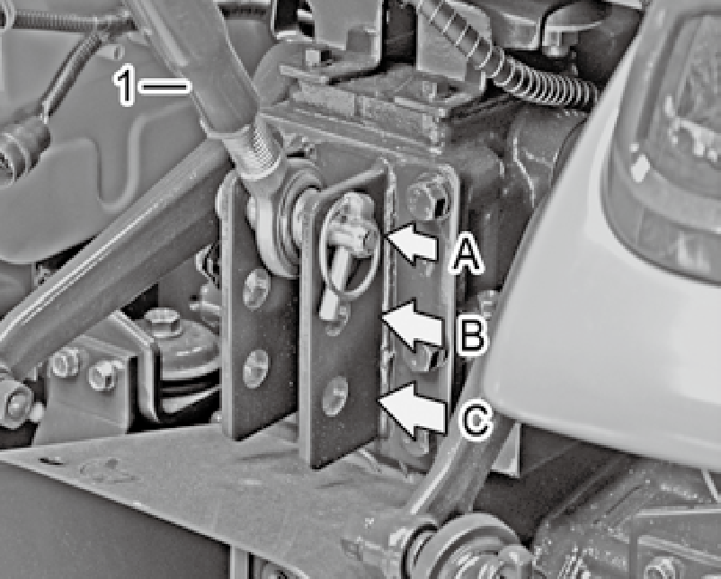

My Kioti CX2510 has three mounting holes for the 3PH top link. The owners manual doesn't say anything about which hole to use. Tractor was delivered with the top link in the middle hole. I have a GWT quick attach on the 3PH.
What factors should be considered when deciding which hole to use? I only have one implement (flail mower) and it doesn't say anything about it. Does it really matter?

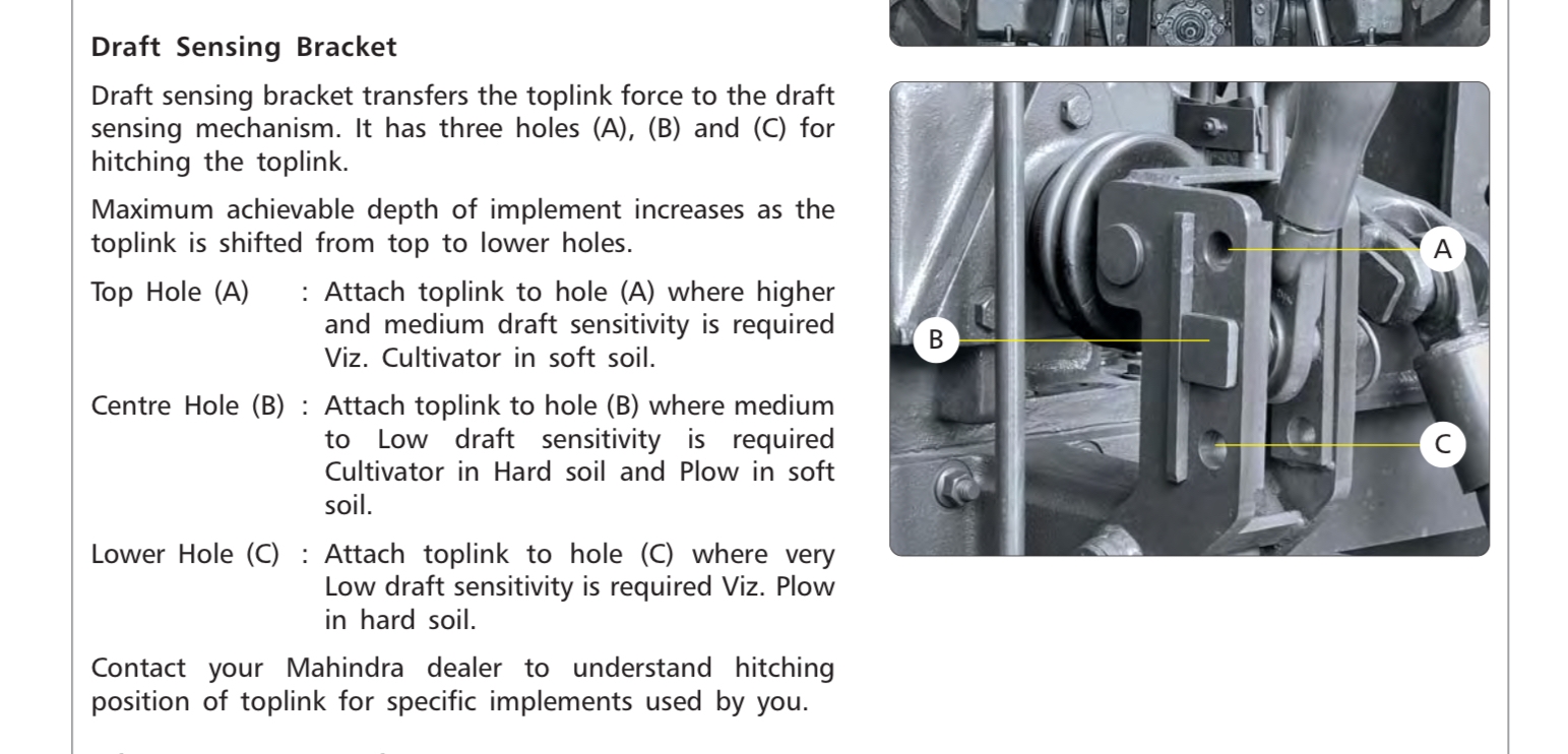

Many tractors with top link draft sensing for the draft control will use the different holes for a sensitivity adjustment, with the hole furthest from the sensor being more sensitive. Not having draft control which ever hole allows for the best adjustment for your implement.

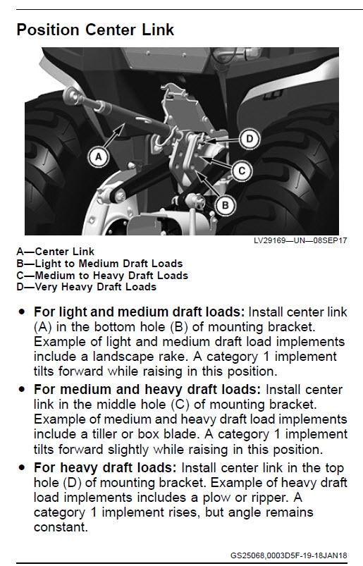

Here is what it says for my John deere.

Last two posts are interesting. @RayIN's manual says to "go lower" as load increases, and @wirlybird's says to "go higher" as load increases.
@RayIN what kind of tractor you have?
@wirlybird On your photo of the manual page, it looks like the mounting holes move forward as they move up. Is that correct? Mine all line up vertically.

Yes, they do move forward from bottom to top.
Tractor is a John Deere 3038E. I use the bottom hole for my brush hog so the rear will raise more when I lift.

Tractors using top link sensing will have a link to the top link that moves slightly with the pull. Some will have the sensing element on the bottom of the link some on the top. The hole position adjusts the mechanical advantage to the sensing point

As a reference point, here's the image in my owner manual...

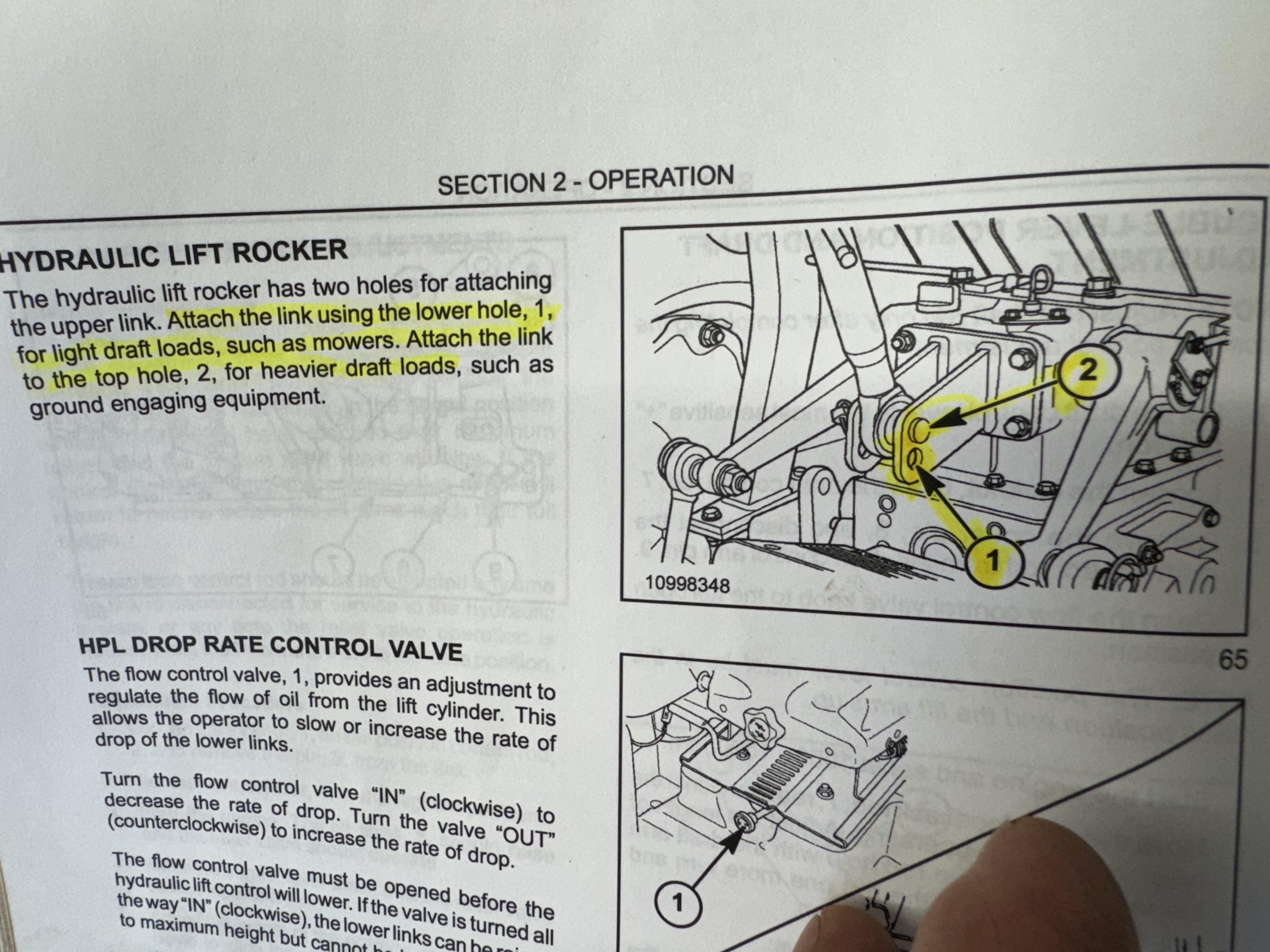

My TC45DA says “Attach the link using the lower hole, 1; for light draft loads, such as mowers.
Attach the link to the top hole, 2, for heavier draft loads, such as ground engaging equipment.
