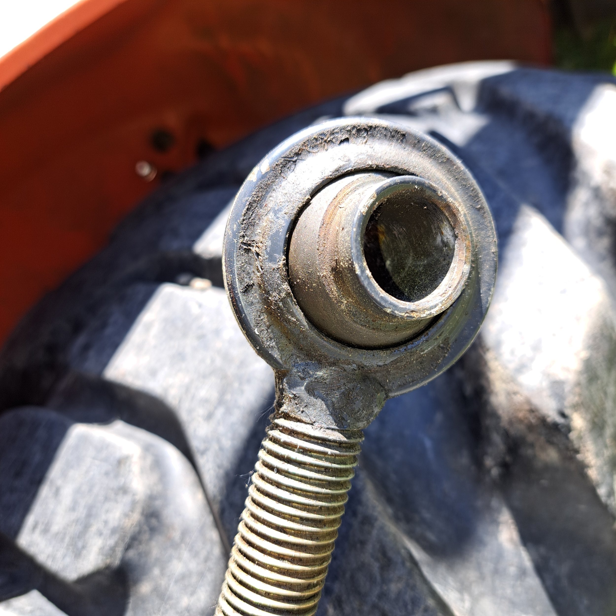

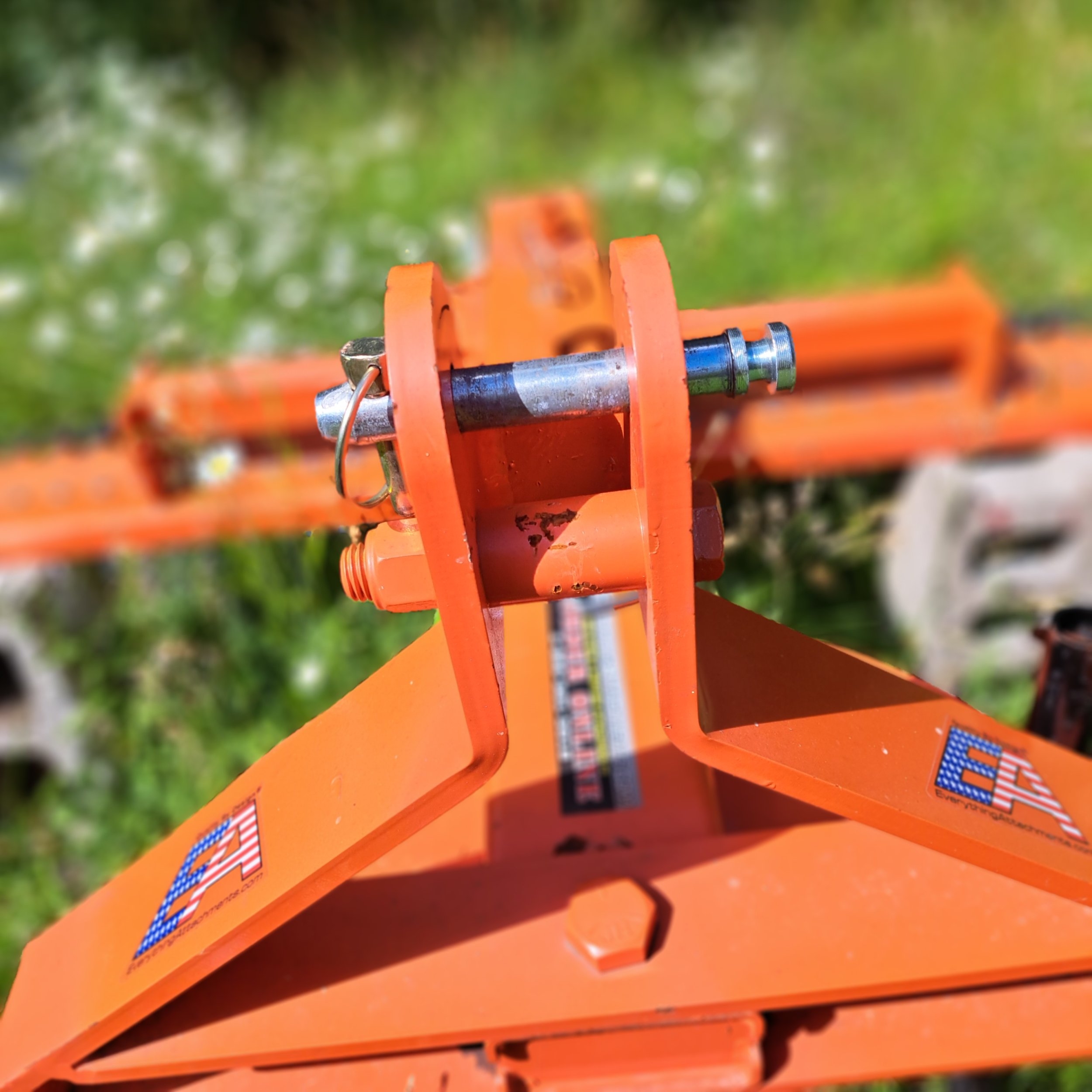

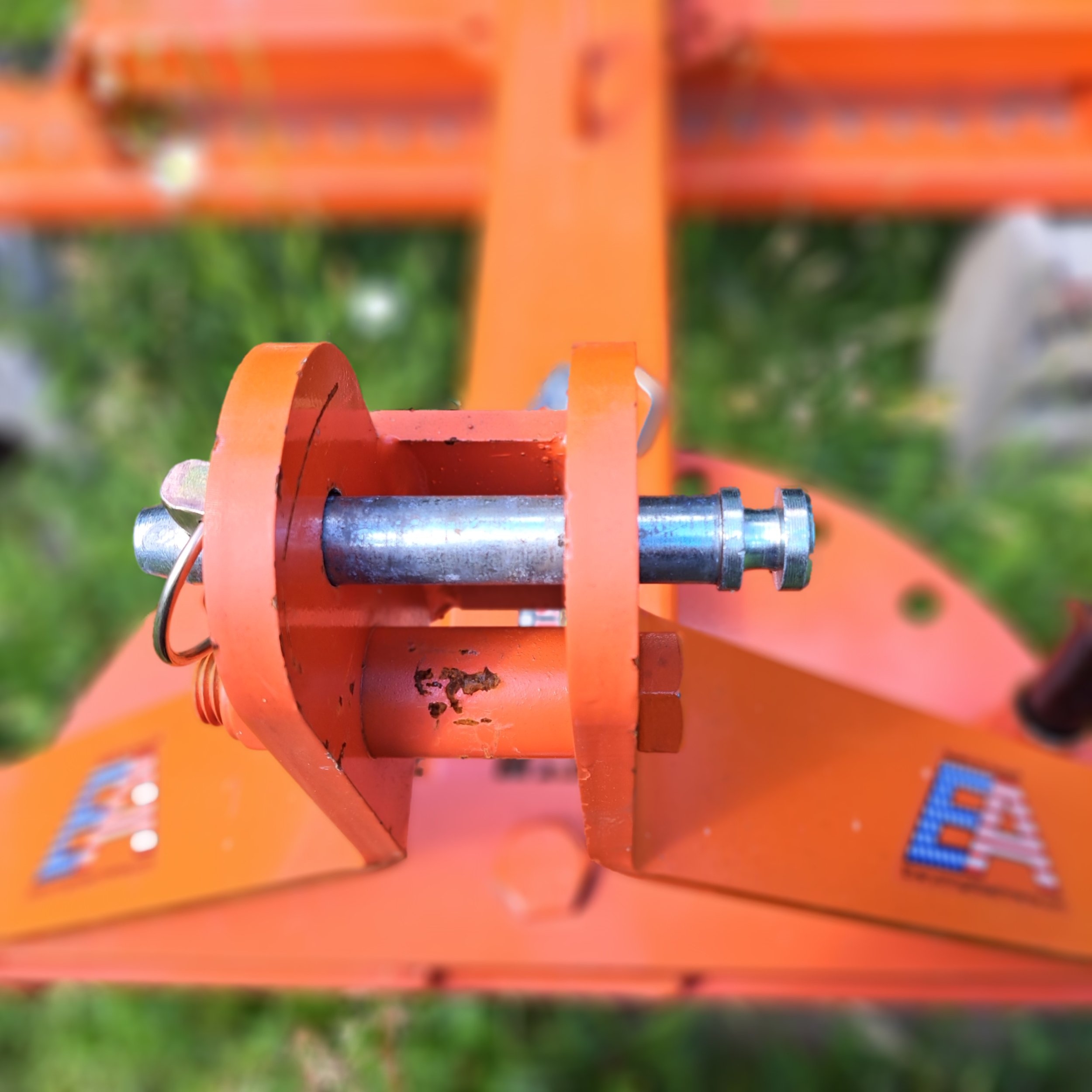

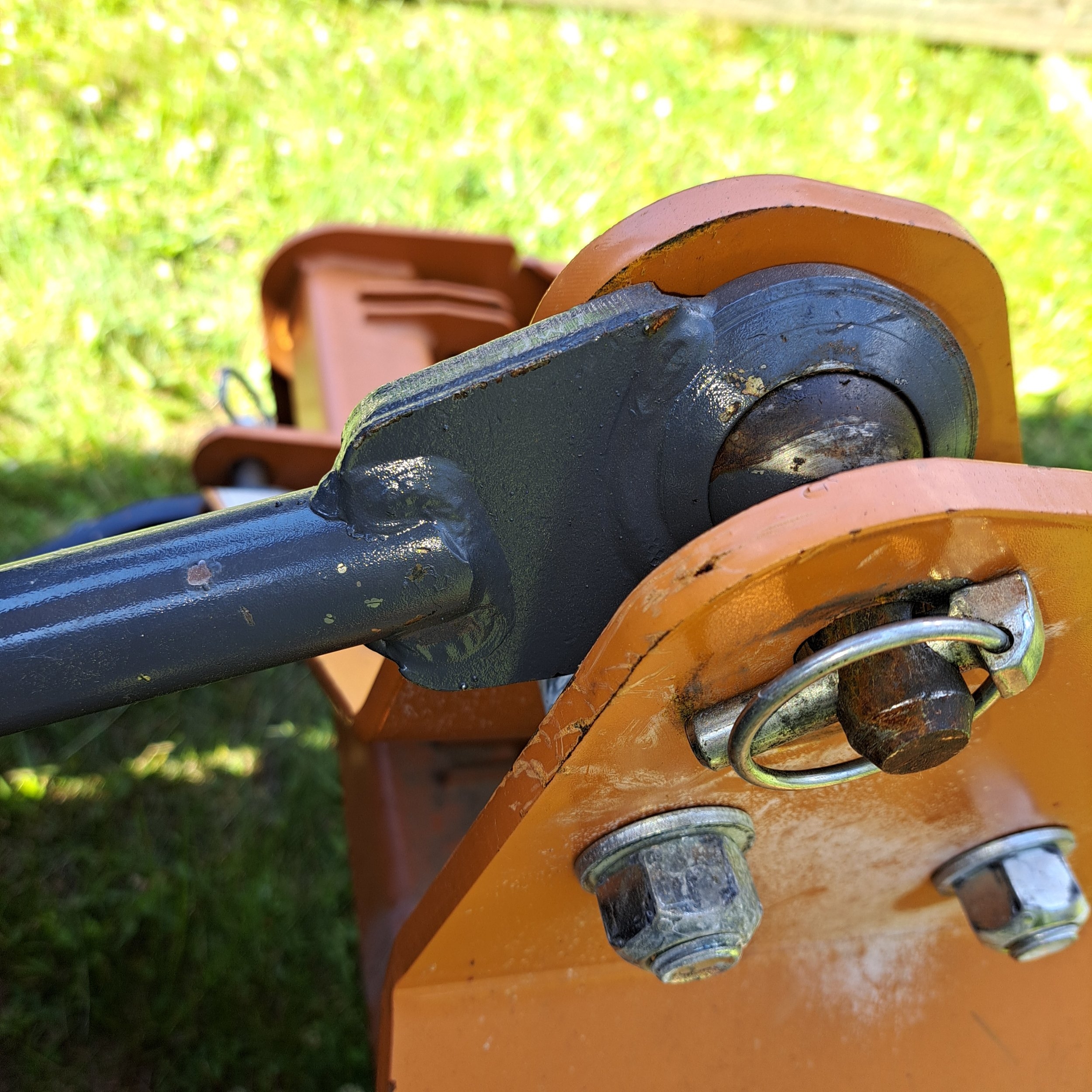

Got an EA rock rake a year or so ago. We are all aware of the calamity, so no need to go there.
From the git-go, I found there was an issue with the top link mounting design. Otherwise no complaints. Well other that the "special orange paint job".
Issue is the Kubota (Gannon) hydraulic top link for my B21 has such a large gusset welded on the "eye" that it interferes with the bolt/bush/spacer on the rake, preventing any real motion. EA was "interested" but had no solutions and offered zero help, only talk.
I let it go as the manual top link worked fine and, well, it was only a rake. But now, as I have a need to swap between a box blade/scraper and the rake, often, as it look right now, the extra work to swap the top link around will be a PITA.
So, I have options.
- grind down the gusset on the top link. Not a favorite as there is a LOT of steel to remove and, well, the did it for a reason. I guess.
- move the bush/spacer by drilling a new hole closer to the center or end of the top link bracket, weld up (or leave alone) the old hole.
- just swap the position of the bolt and the top link hole. Not sure that will work, really but it would be quick enough to try.
What do you folks say?

I think I would drill the hole for the bolt lower rather than grinding on the top link, even though there is plenty of meat there. Or simply swap the bolt to the top hole and use the bottom hole for the top link.
Looking closer, not even sure if the bolt is needed since there is a small plate welded that connects both Z shaped bars together. Almost looks like that bolt and spacer was meant for those QH but could be wrong.

It looks like that bolt is just sleeve over the bolt and possibly loose - independent of the bolt.
I understand that removing it and replacing just the bolt that it will only be work in one direction (that I agree with PTSG to its questionable purpose) but that might provide enough clearance without permanently altering the rake.
/ EA Rock Rake, hydraulic top link interference problem. #4
I vote for removing the bolt and sleeve.

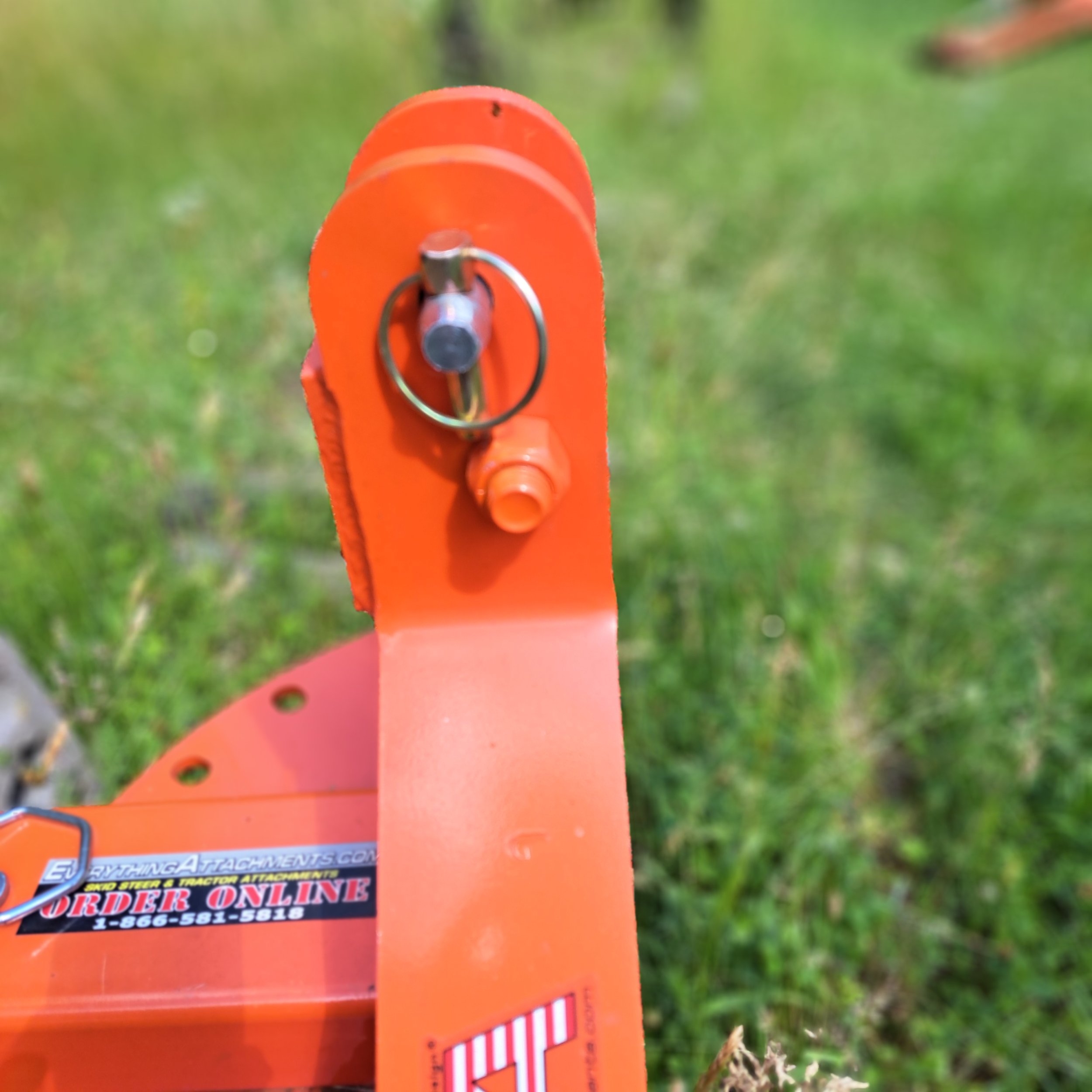

I moved the bolt and "eyeball" suggests it will work. It's just a bolt and nut through a sleeve. I think it is there to help "hold open" the U shape where the top link eye mounts. I suppose a custom bush for the eye or spacers to make it "tight in the channel" would do almost as much?
Never tried drilling or welding "hardox", so if this works OK I may leave it as is.

Sure. Here ya go.
After using it for a while, I feel it limits the range of motion a bit, so I may drill a new hole below the original hole for the bolt and sleeve and move it there and the top link back to the original location.

I would just eliminate the bolt and sleeve if it was mine.
/ EA Rock Rake, hydraulic top link interference problem. #13
The bolt and sleeve I believe was just to make it quick hitch compatible. If you are not using a quick hitch then removing it all together would not hurt a thing and save you a lot of work and worry.
