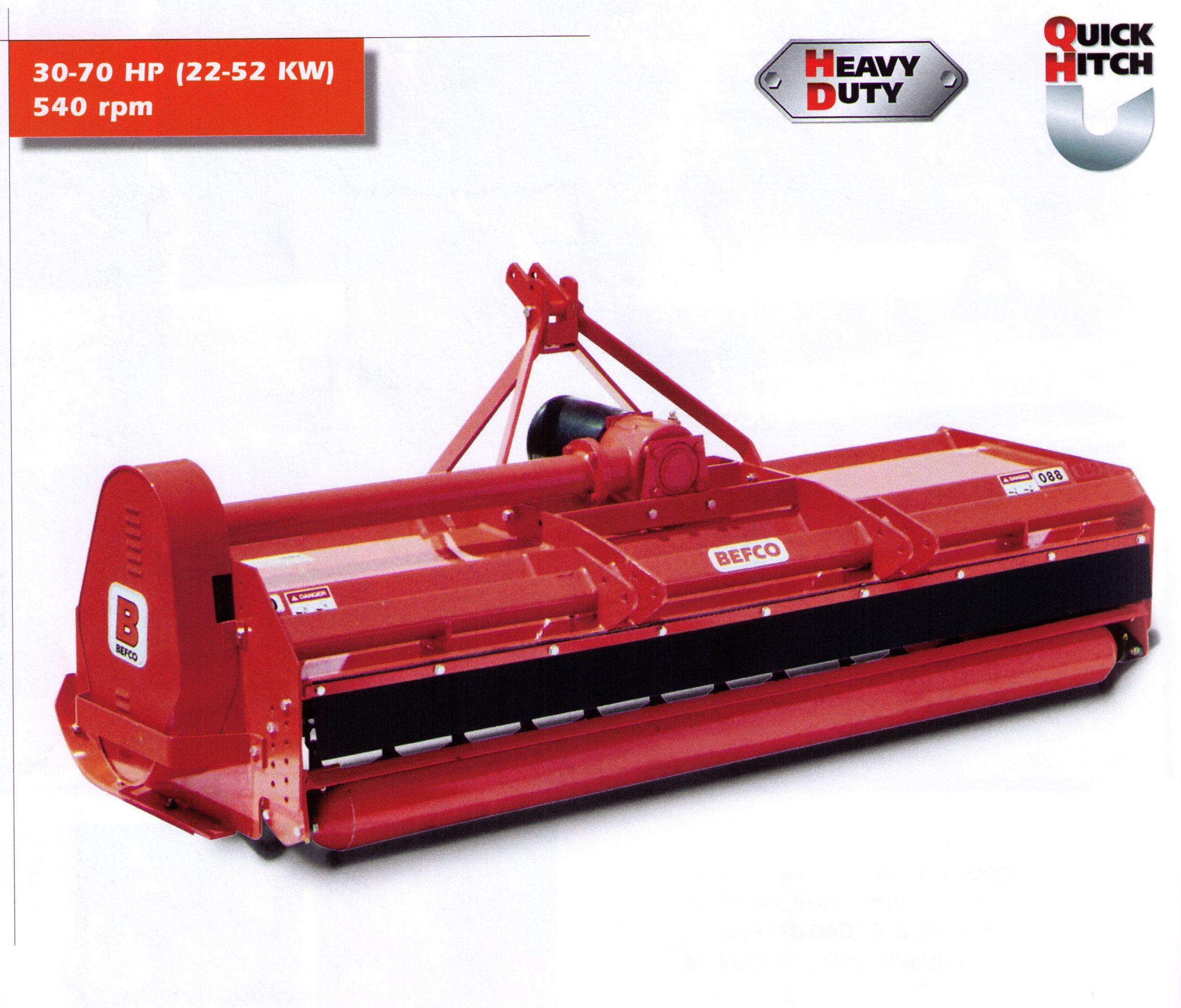

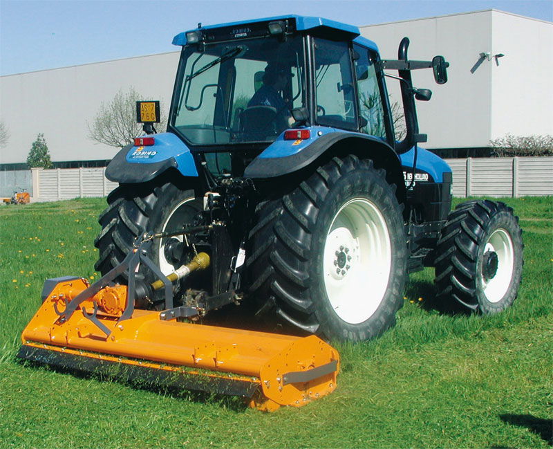

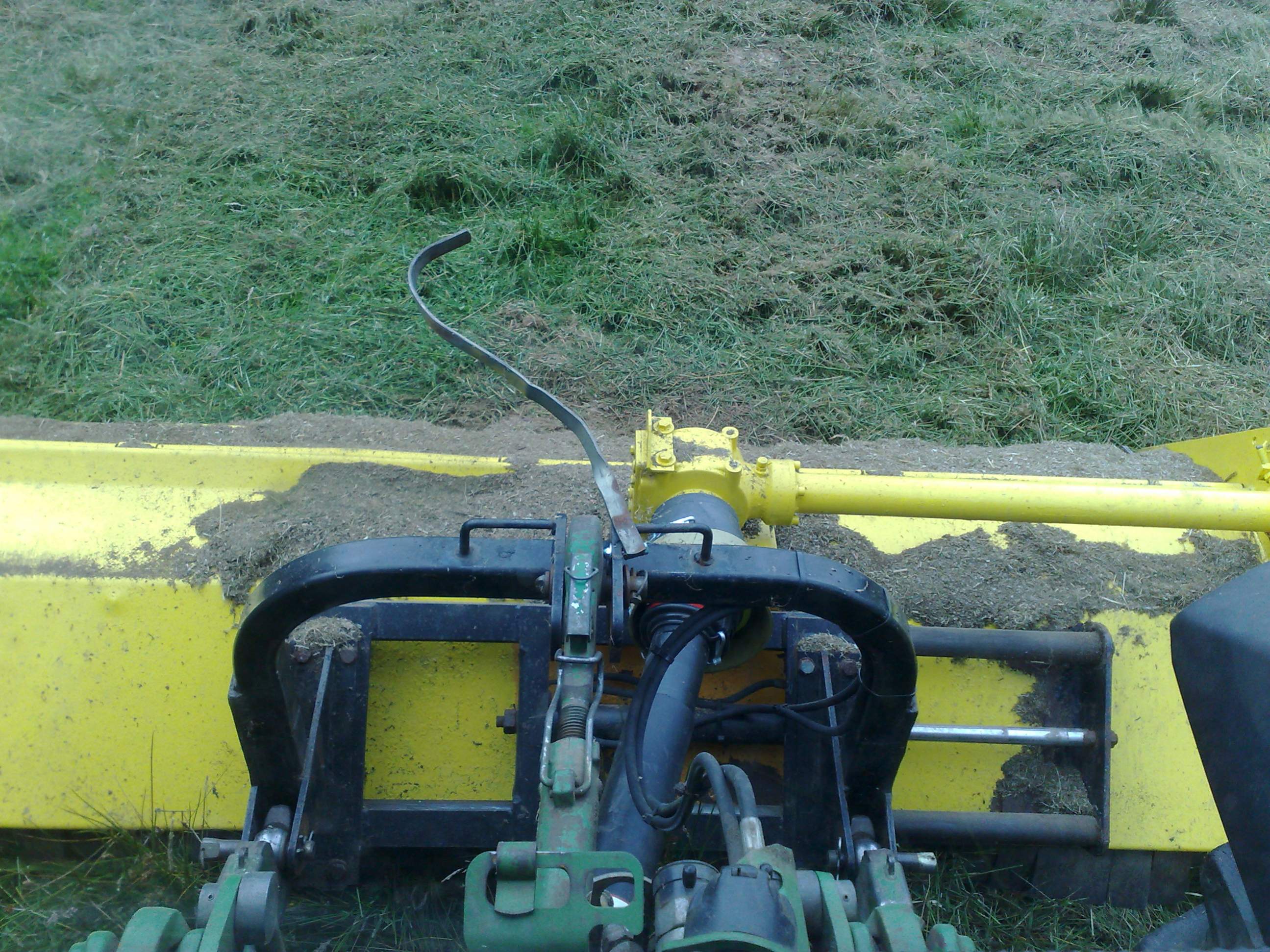

Photo please. If you can't find one, perhaps you'd point out to us a "tail wheel" in the photos below.
The only thing I can think of that might equate to a tail wheel on a flail mower would be those very very very few owners that might have invested in optional gauge wheels. Or perhaps those huge corn stalk flails that require carriage wheels for getting to/from the fields.
//greg//

Its that long round thing on the back of each that is free to rotate about an axle. A roller is just a special case of the inclusive wheel concept.
The non rigid toplink attachment option is shown in the 1st photo.
larry

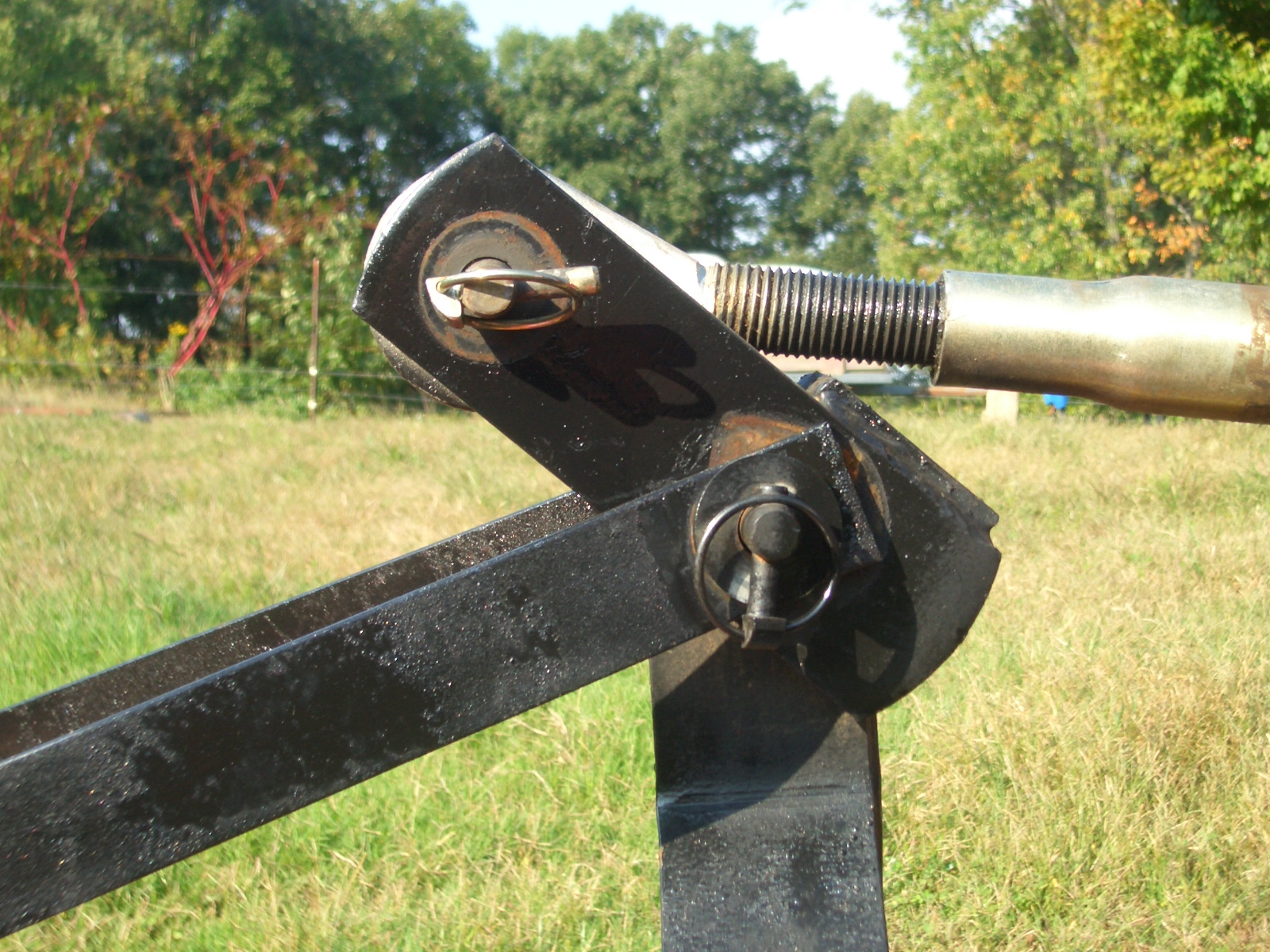

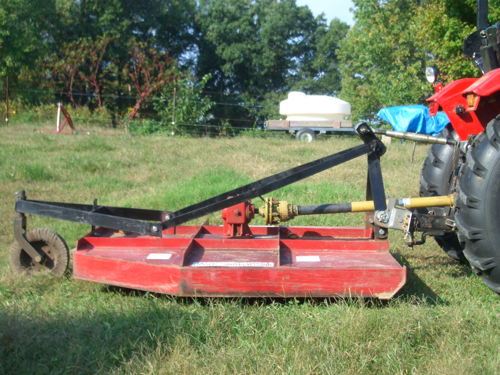

You either don't have a floating toplink bracket, or don't understand what it's for. When adjusted for the mowing position, there is no "stress going through the toplink" - and it is excellent on hills. In fact, my property is ALL hills.
Look at the photos below. This particular style of flexible toplink bracket locks in the upright position. The left photo shows the transport position with the toplink shortened until the bracket hits its stop. At that point, the implement is picked up for transport. Now look at the right photo, which depicts the mowing position. Note that the toplink is lengthened, rotating the bracket back to the 45 degree position. Now when the front of the tractor is lower than the rear, the toplink pulls the bracket forward. But it's pivoting on a pin, so the mower deck never moves. Then when the front of the tractor is higher than the rear, the toplink pivots the bracket rearward. But it's only the bracket that moves, not the mower deck. That floating bracket will pivot through a full 90 degree arc, moving back and forth as the tractor goes up and down. Yet the mower deck stays parallel with the ground.
Same principle applies to the floating toplink bracket on my flail mower. I just didn't have any photos handy. The flail bracket is the U-type , and it pivots inside the A-frame instead of above it. Whereas the RC bracket has a 90 degree arc, the flail bracket will pivot nearly 180 degrees. And now that I have a hydraulic toplink, I don't even have to get off the tractor like I did in the past - to adjust the rigid toplink between transport length and mowing length.
//greg//
Same principle applies to the floating toplink bracket on my flail mower. I just didn't have any photos handy. The flail bracket is the U-type , and it pivots inside the A-frame instead of above it. Whereas the RC bracket has a 90 degree arc, the flail bracket will pivot nearly 180 degrees. And now that I have a hydraulic toplink, I don't even have to get off the tractor like I did in the past - to adjust the rigid toplink between transport length and mowing length.//greg//
